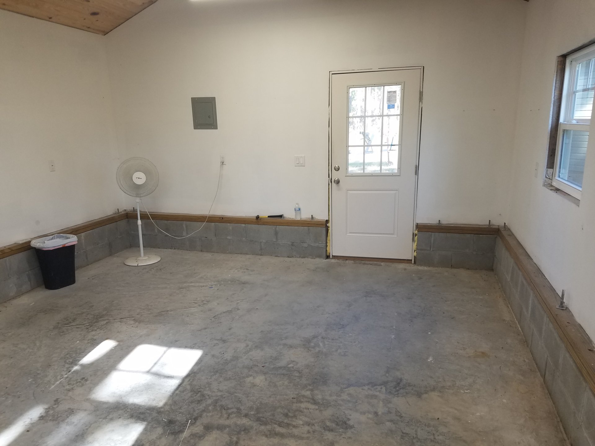

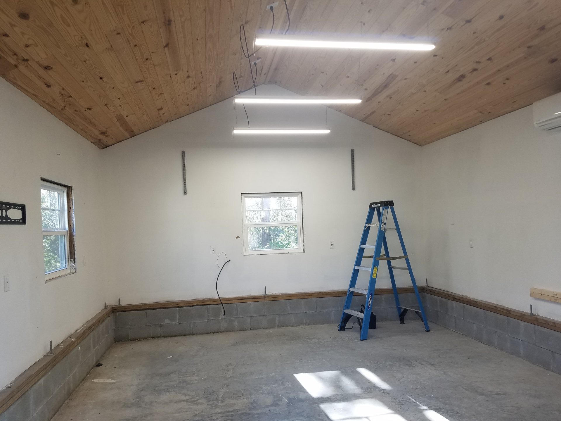

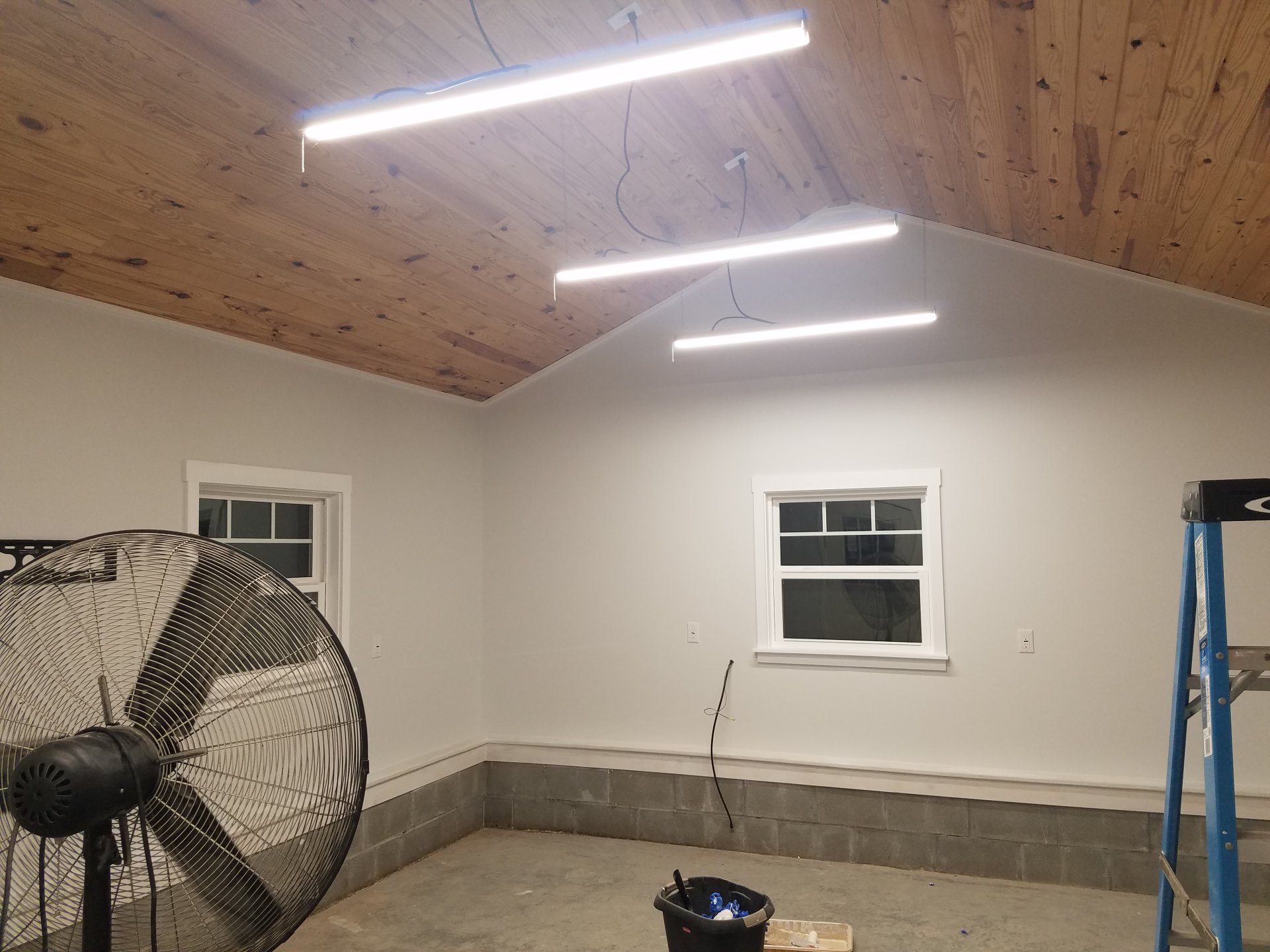

I can certainly make one for you. But, my shop turned into this today:
Everything was moved out to the garage so I can finish out the inside. I estimate about a month down time. I do have one project that will be ongoing in parallel but nothing new right now. If you are not in a hurry I can get to it in November possibly.
View attachment 3141695View attachment 3141696
I drive a 40. I'm never in a hurry!
That shop looks great already.
