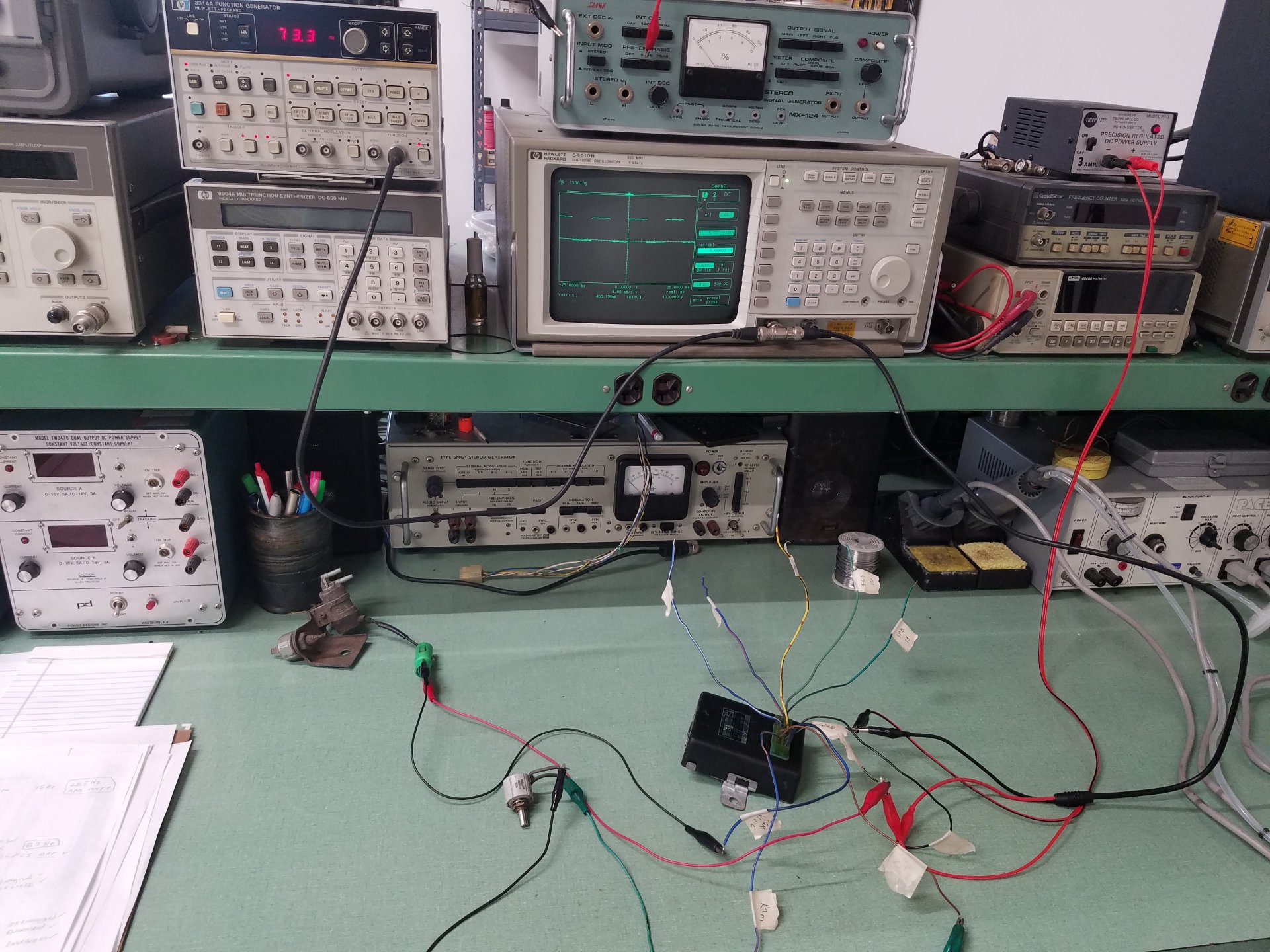

Finished drawing the schematic for this tonight, Its the 72-74 89550-60010 emission module, it controls three VSVs depending on engine coolant temperature and vehicle speed. This one functions but is way off, it needs calibrated for the VSS input.
Some corrosion on the transistor cans.
Replaced the two electrolytic caps. One of the film caps was bad too. Fully tested and calibrated.

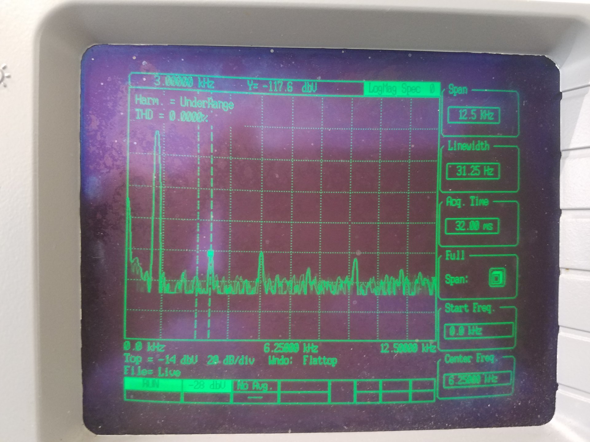

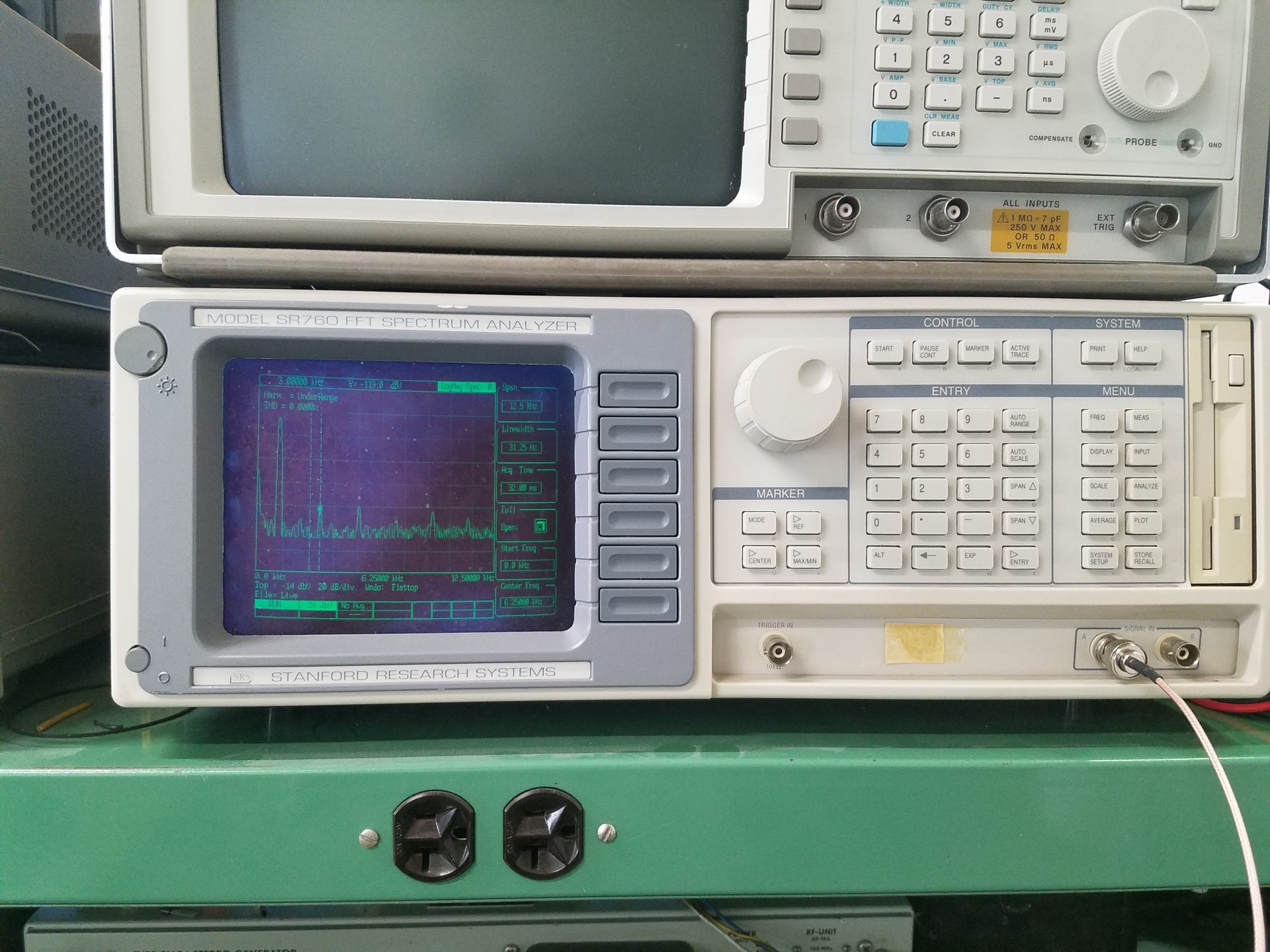

I've been doing some hifi work lately so I invested in this.
This is a 1kHz signal from my HP 8904A.

What’s the floppy disk on that freq analyzer for?

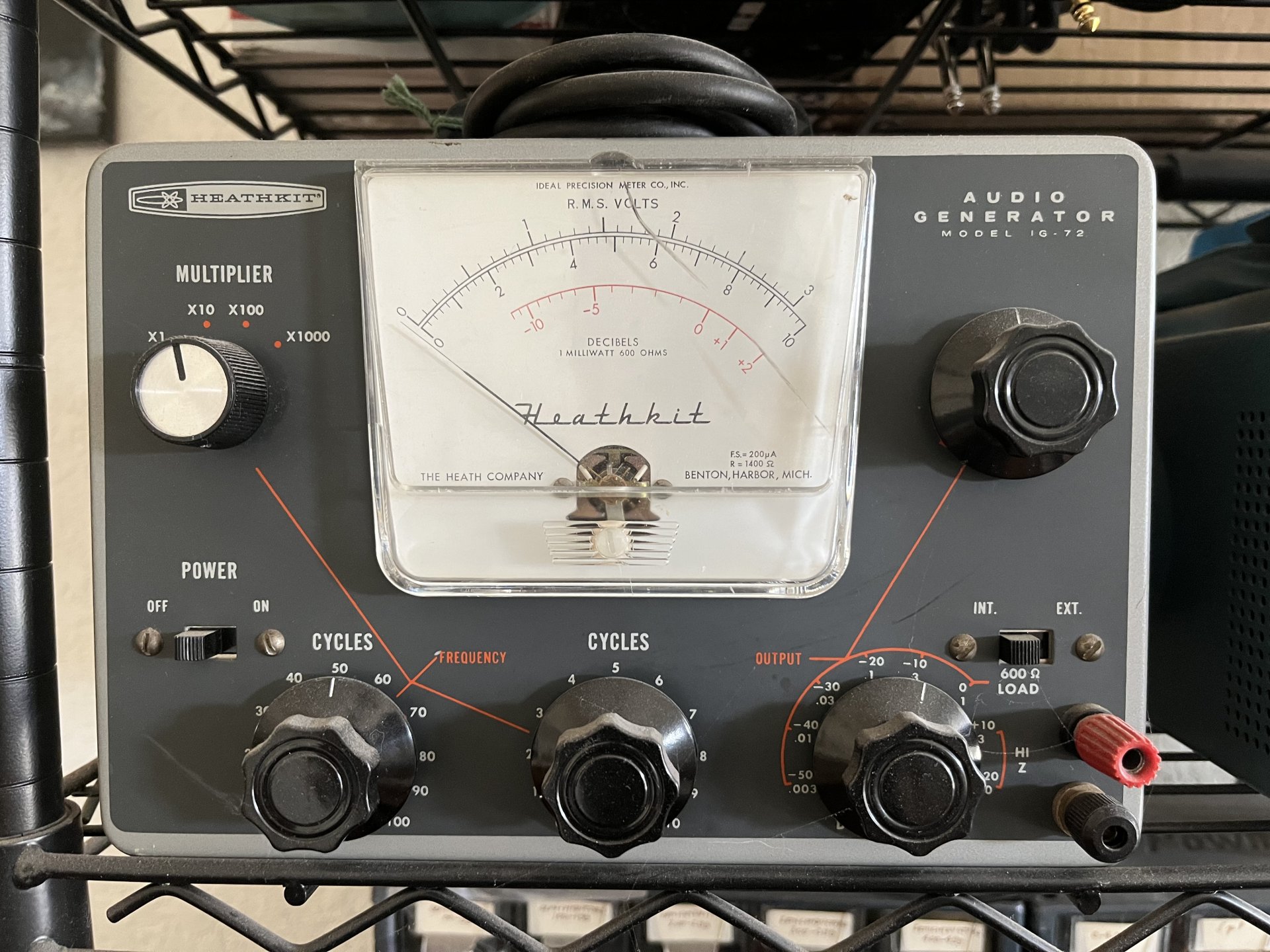

For what it’s worth I run an 80s Tektronix scope and my signal generator is a very old Heathkit unit with tubes inside. It always measures deadly accurate in both frequency and voltage output. I should probably recap and retube it at some point. Although the world lost another tube factory recently - even less supply of new ones.

It's for saving plots to for analysis on a PC. Not sure if the software is still available for that. I am currently working on a Fisher 800B from the 60s. These old tube amps/receivers are great.

And here’s the tube-driven Heathkit signal generator. Again, it works for my very basic audio testing needs.

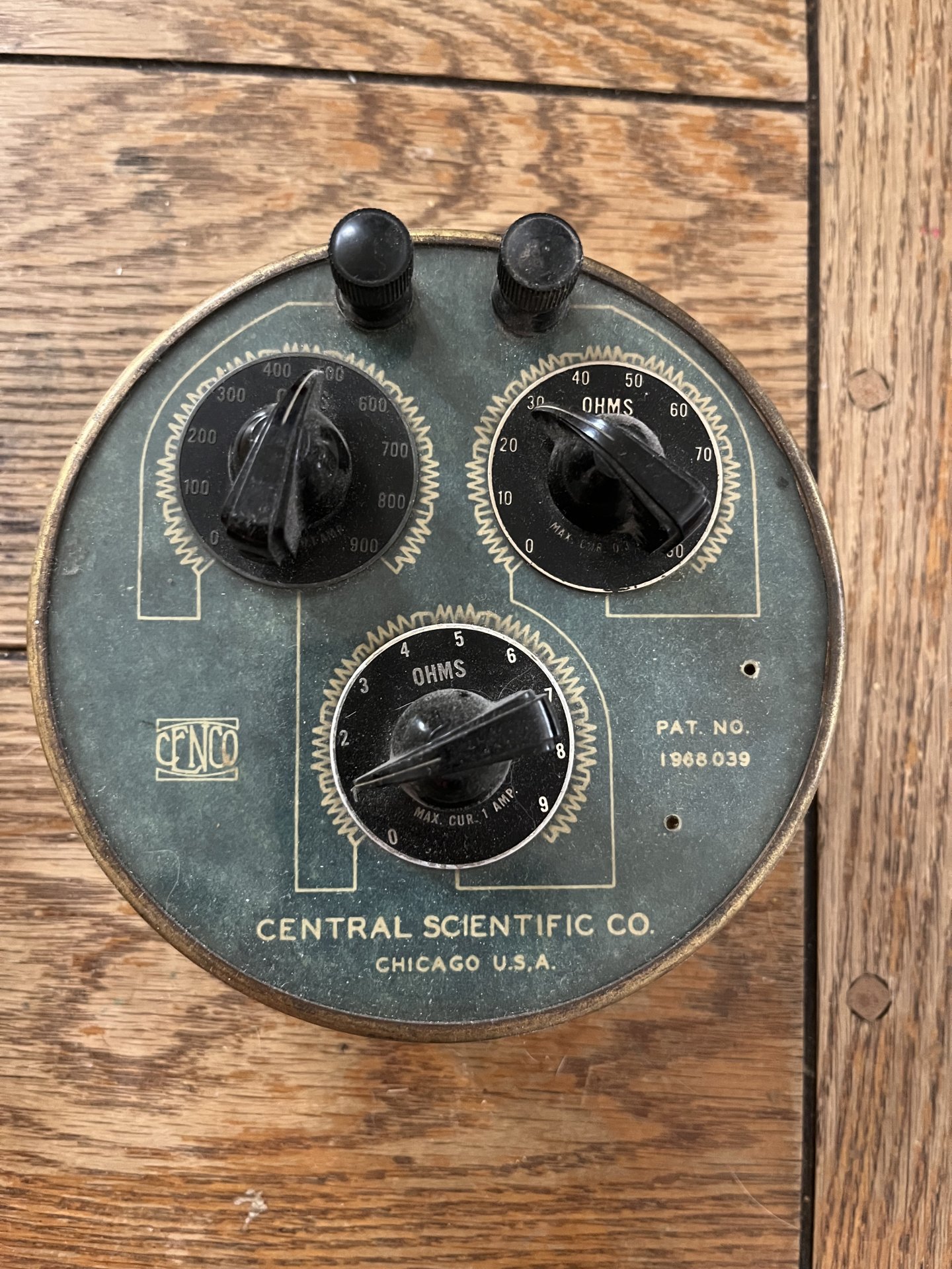

I really love old equipment. The way it operates and the way it looks. Here’s a resistance decade box I have. There was a grease pencil service mark on the back indicating 1944, so it’s older than that.
