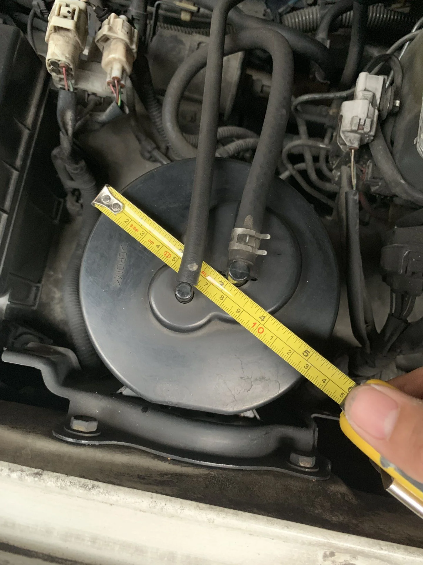

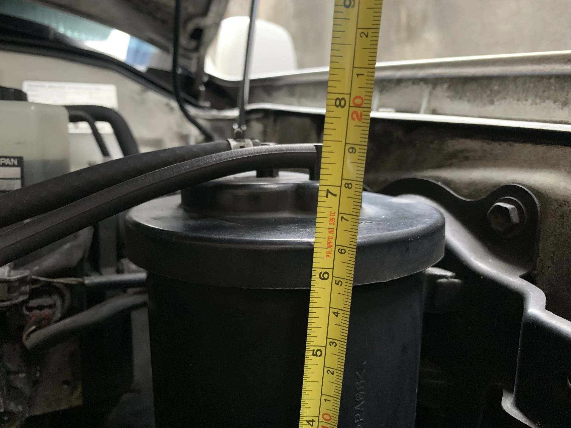

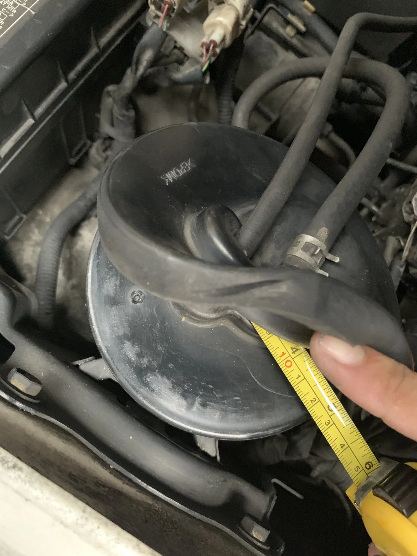

If anyone out there has one of the non-US canisters shown in Hoser's post above (#10), could you post up the rough measurements, H x W?
The OEM FZJ80 vapor canister measurements are roughly 7-1/2" H x 4-1/2" W
Here are the canister measurements from my LX470
