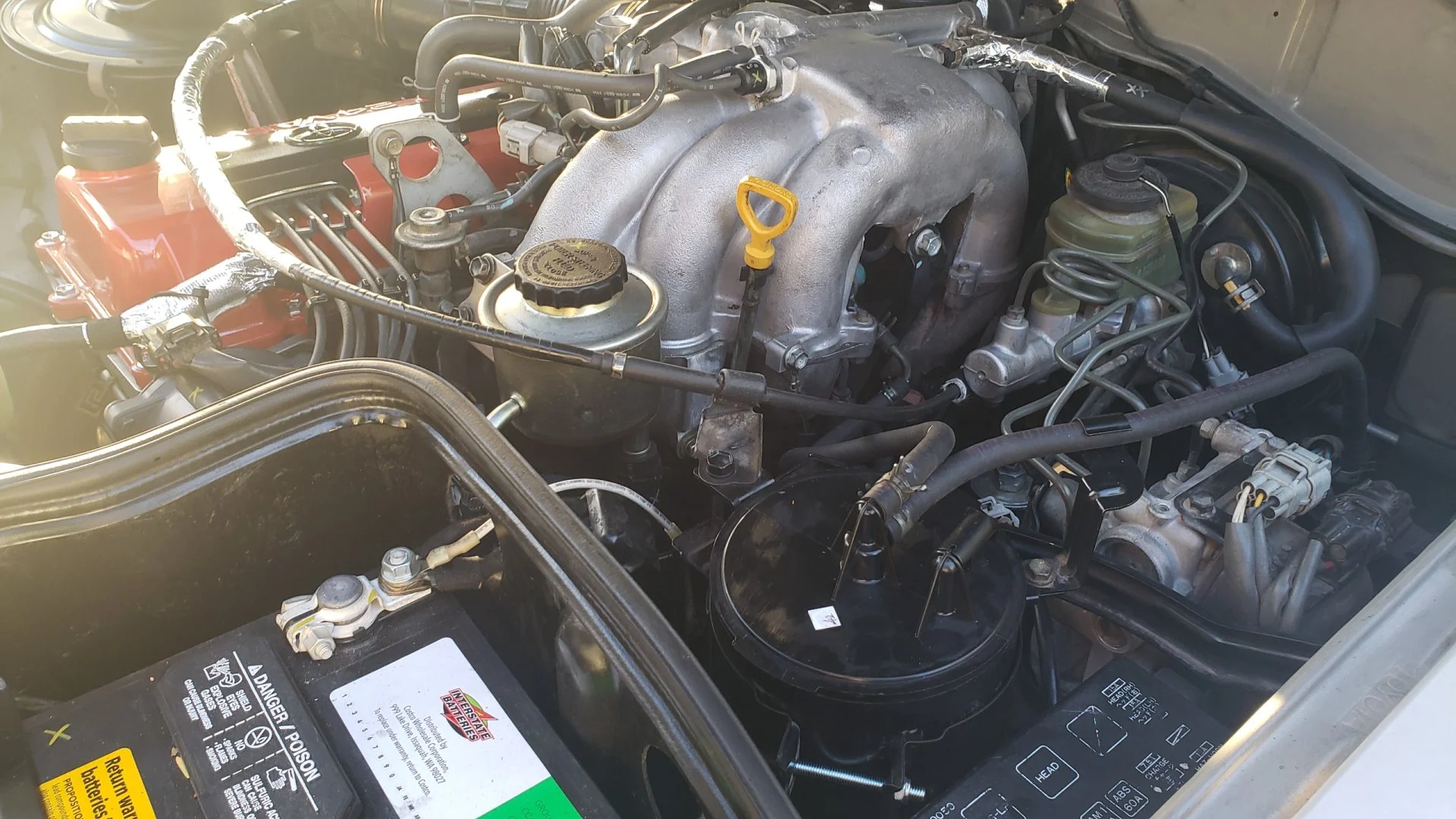

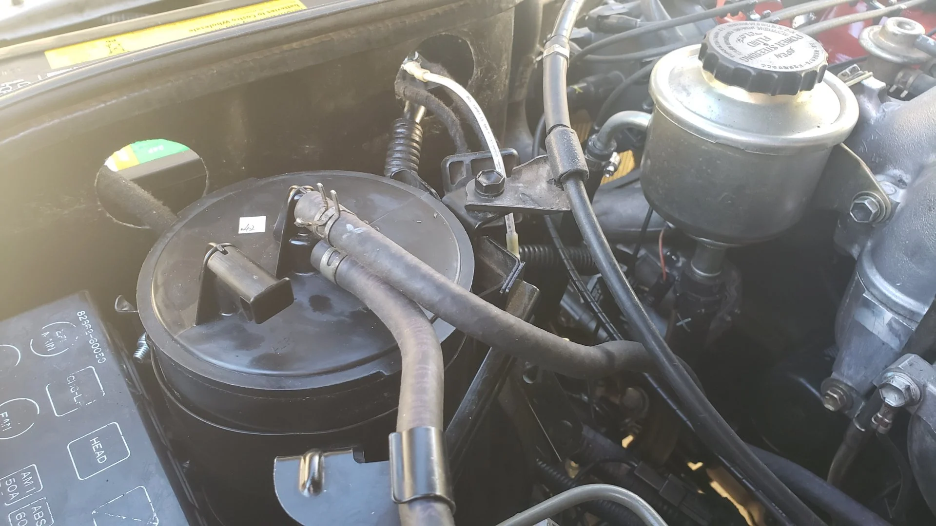

I have the Dorman evap installed! Took all of 40 min and I have both brackets connected, the lower wiring did not impeded the install. I pulled out the breather hose and saved it. The OEM (25yr old) unit was HEAVY! 56oz's wreaked of gas and the new one was 25oz's. I weighed it! I also have video that I will post to my YT channel when I get the chance. Dorman unit works fine, starts fine, runs fine, no codes, will keep the thread updated.
Update after a month ... working flawlessly!!
Replacing mine with the Dorman 911-261 since its $20 cheaper than the ACDelco 215-153.
Just wanted to confirm, you guys did not extend the breather tube on the bottom to reach the top of the new filter, correct?
My AC Delco is temporarily and the breather wasn't extended. However, mine is temporary until I get my 105 canister fitted up.
