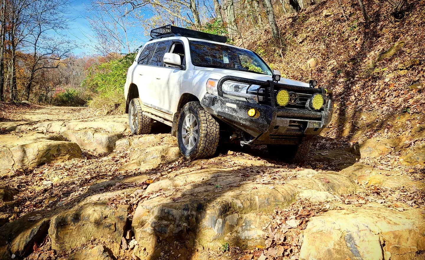

Don't throw money at rims until you have driven the hell off of the factory. The picture on the left is on 20s deep in the wilds of Utah. I run 17s now for really bad roads, but the 20s got me in and out of the most stupid places.
