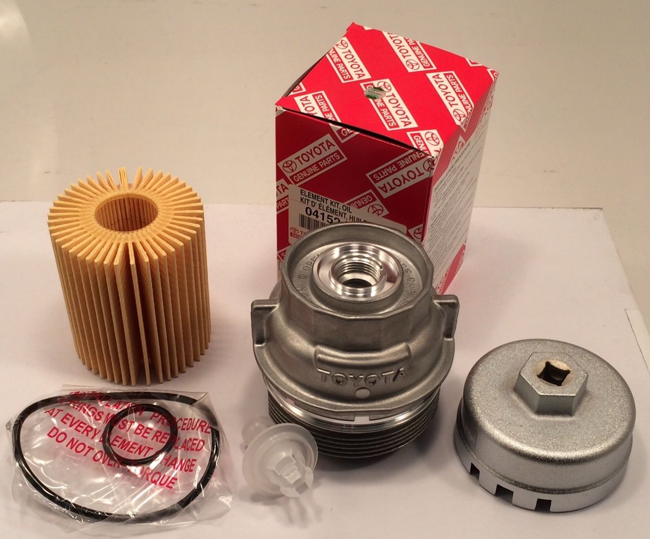

I believe it was around '06-07 that Toyota changed the oil filters in their engines to the new cartridge element style. You buy just the element, and it comes with a pair of O-rings and the little plastic thingy for draining the filter. The element is in a reusable housing that screws off after you drain it (requires a special wrench, see photo). Some people don't like it, but I do. Some people don't like EFI either.

My 1AR-FE has the cartridge filter. Put me down as a hater. I noticed your housing is metal. Mine is plastic.
I like EFI.:moon:
I found that photo on Google. The filter housing on the 5.7L 3UR-FE in my mighty Land Cruiser is plastic too, go figure. It will be swapped out for a metal one at the next change.

Yes, and I also like that you get the chance to inspect the pleats of the filter membrane, see if there's anything there that shouldn't be. With the canister filters, it's caught inside and a messy job to cut it open.

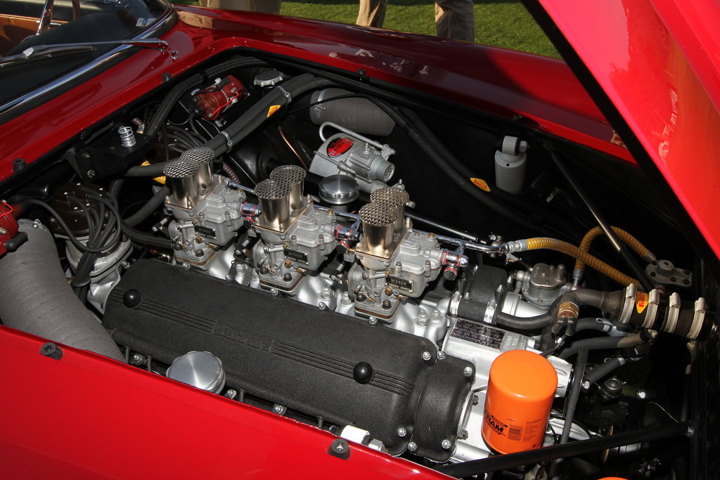

Worst I've ever encountered was in a Ferrari 400i sedan. Two massive filters right on top of the engine, pointing straight down. Really stupid.
yeah, those big filters on the top are brilliant. surprised they didn't put little saucers on the bottom to catch the outflow like the subarus have. those metal cartridge style filters will fit a 22re?
