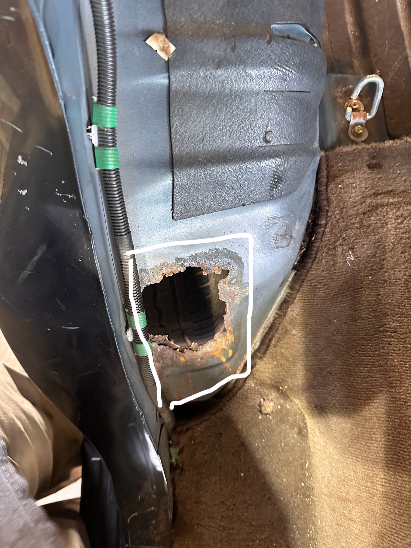

Can anyone help me figure out if its possible to replace this piece?
May 19, 2025
5
15
florida

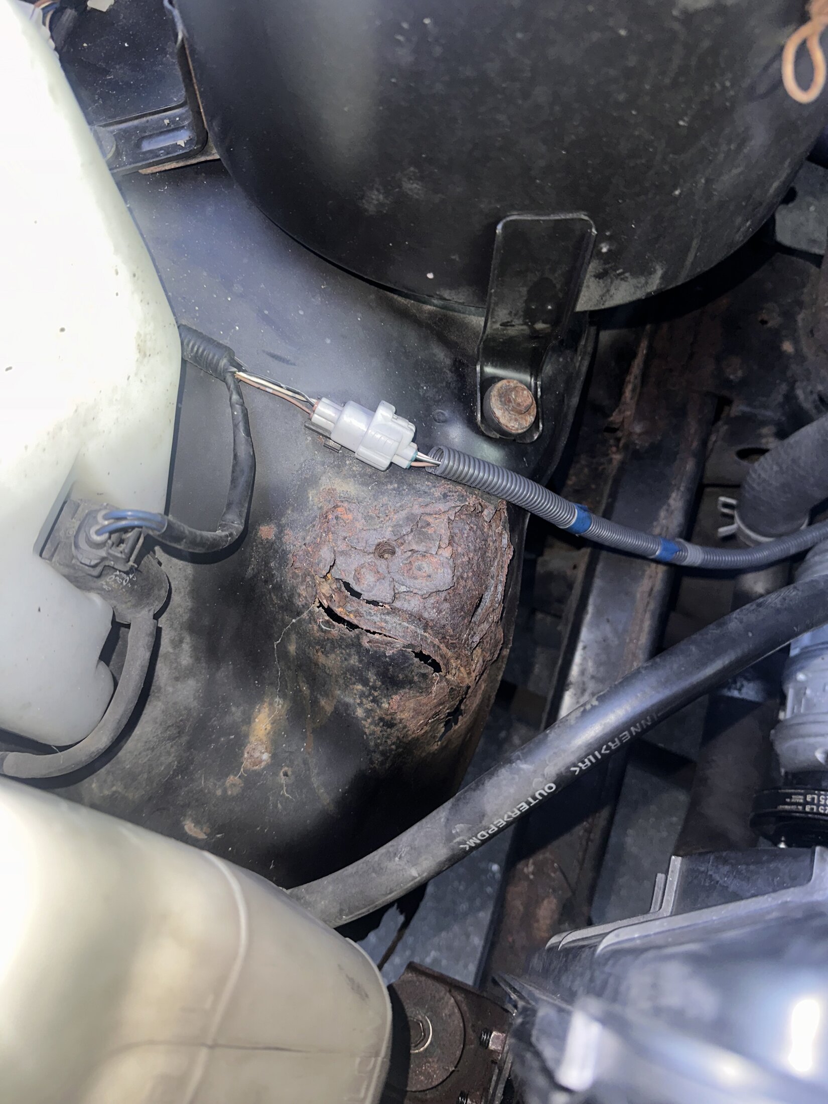

this is inside the hood on passenger side.
i have a 97 40th anniversary.
that's part of the passenger wheel well/apron you can try and source a good used one, it does unbolt from the truck but may be a big hassle or just cut out the rust and weld in a patch. Shouldn't be too difficult considering there is access to both sides of the panel

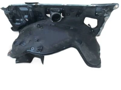

Toyota 53710-60163 Apron Sub-Assy, Front Fender, RH - the part has been discontinued
x2
I scored inner fenders from a part-out here. Mine were too far gone to mess with.
@lc80vinhy that is salvageable, for sure, with a little cutting and welding. If you don't want to go that route, check the part-outs.
Mine was rusted through at that spot. I cut it out, fastened mesh over the opening and patched it with fiberglass bondo. I put long hair fiberglass on the underside with a thick coat of black asphalt undercoat. Imho, MUCH easier than replacing the inner fender. Mine looks great but in that spot it doesn't need to.

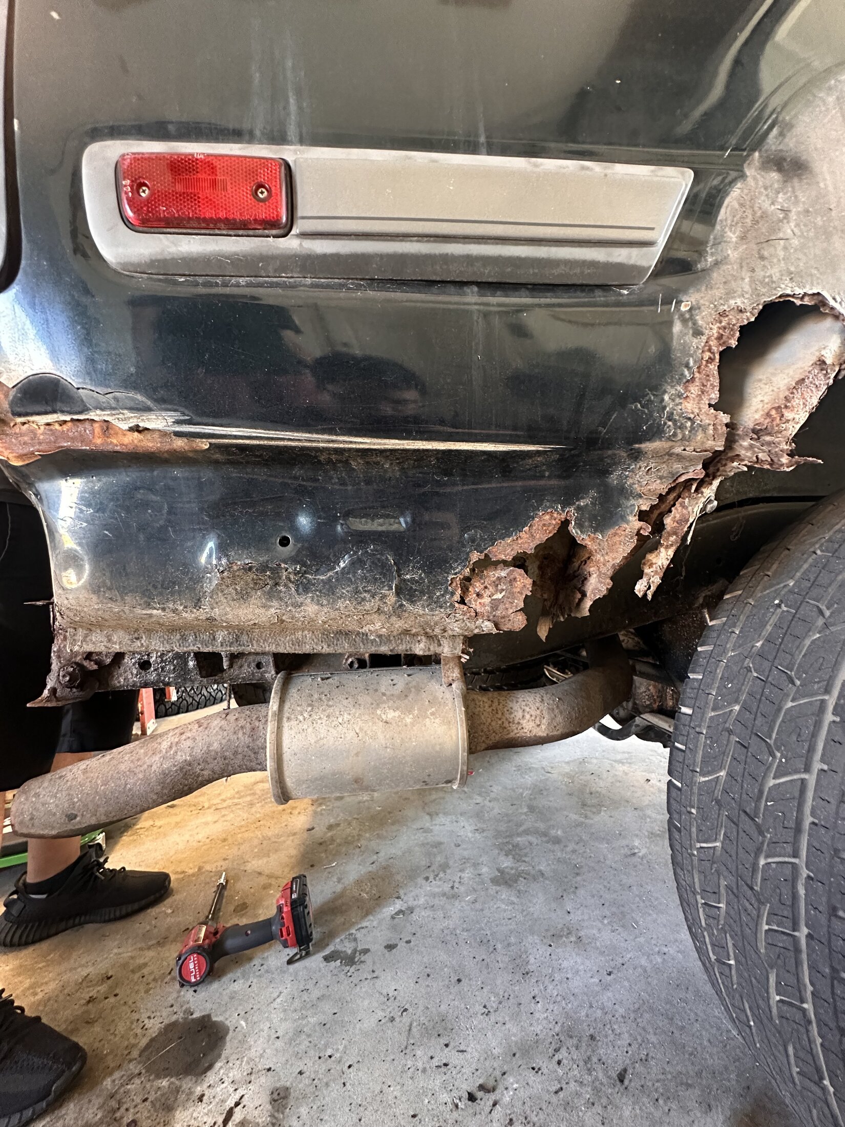

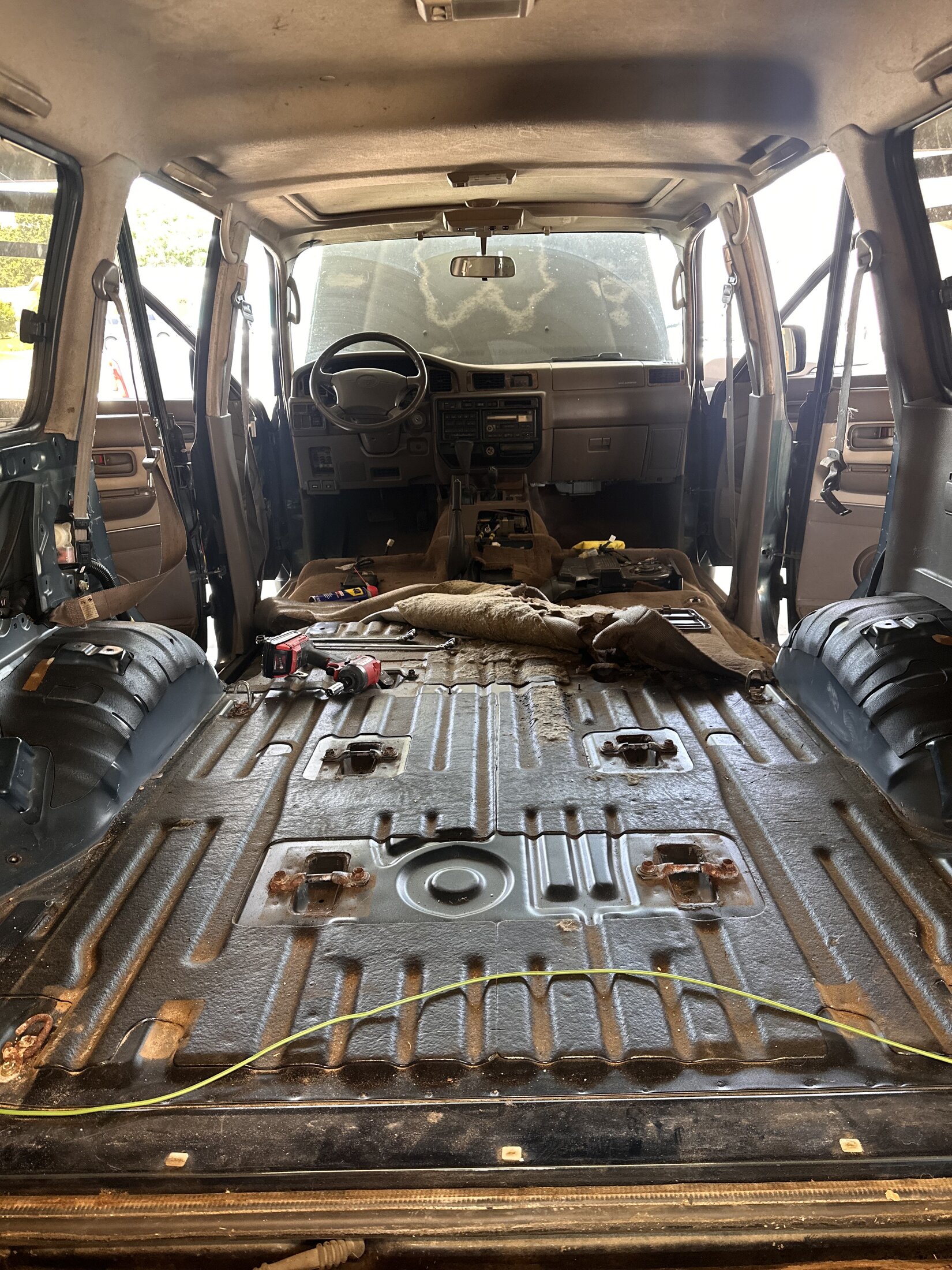

okay im planning on trying to cutting out method and welding and paint since im going to be doing it for the rear wheel well anyways. hopefully its not too bad! here is some before pictures..
You'll be a good welder by the time that you've sorted that stuff out (if you aren't already). Look for a part out and buy good rust free panels. I went through that same chit with my wife's 80. Save that rig!
also this will be my first time welding as well! and will be done with flux core...
My post came in just after yours re: welding. Heck yeah. Go for it. Don't run your flux core to hot, or you'll burn holes through your panels. Practice on some junk until you get the "feel" of it (and until you get to know the sound of a good weld being laid down). Rooting for you.

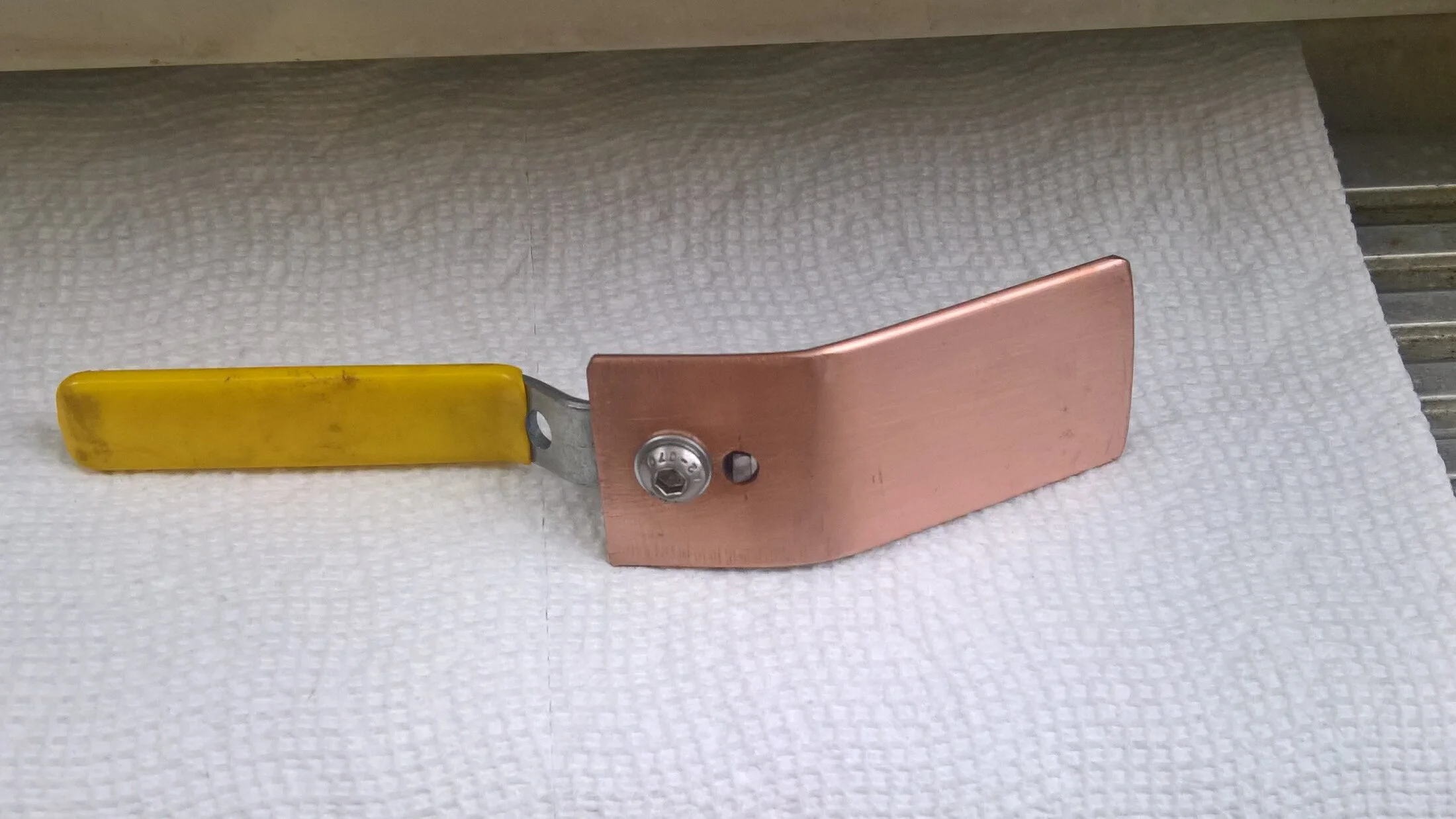

Flux core will be ok if you just make tack welds on top of each other and let cool every so often. If you can reach the back of the panel put some copper or aluminum bar backing the weld to absorb heat. I seen my old roommate replace his quarter panel on a 68 Camaro and ran a almost continuous bead with flux core and the whole welded area of the panel sunk in and looked like the inside of a boat hull.
Agree with above, try to find rust-free replacements (entire sections or cuts) for all those areas.
This autobody guy has some good videos, here's one:

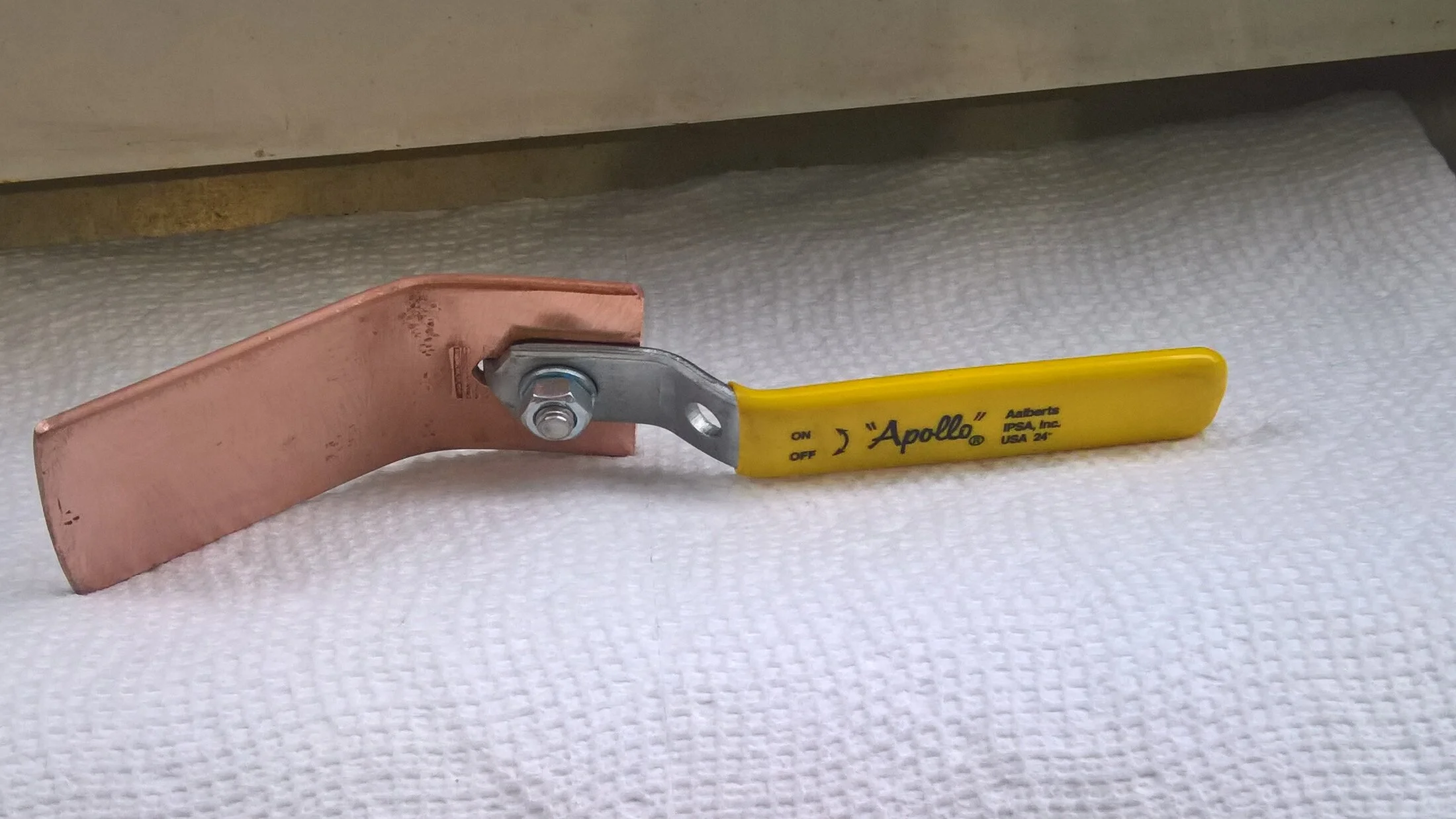

FWIW you can make your own copper "spoon" if you get a 12" flat bar of copper, cut it to length, bend it as you want, drill a couple of holes, then attach a generic valve handle for example (all components ordered from McMaster in USA).
This came in handy when butt welding (held below/behind the gap) but also for very thin areas that were rusty but which I didn't cut out completely (a lawnmower deck, not my 80). The thin areas (rust craters) would blow out here and there so when I went back to fill them in just held the copper (with a welding glove) under that area and built up weld around the hole until they were closed.
This could be useful if closing up holes in the body ie: Fender Flare clip holes, roof rack holes, body molding holes on a LX450, ---
This is the "working" side: ie: hold the "spoon" upside down to get your hand away from the backside of what you're welding
