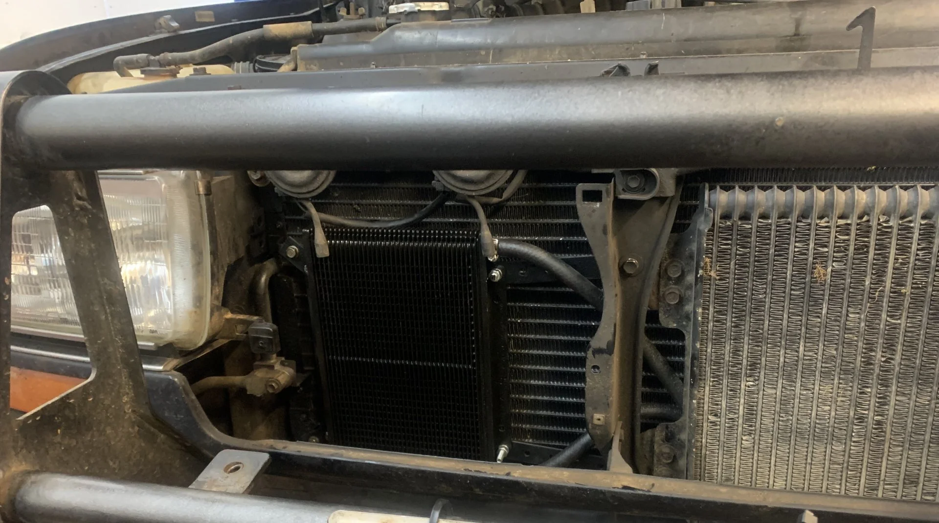

quick update:
Didn't do the work myself. But I found a very old thread with good instructions which I sent to a good local mechanic:
Found the exact same tranny cooler from the post: Amazon product
Probably could've gotten a cheaper one for like 20$ but I didn't want to risk it not fitting well at the shop, or the shop getting a bad one from a junk yard.
