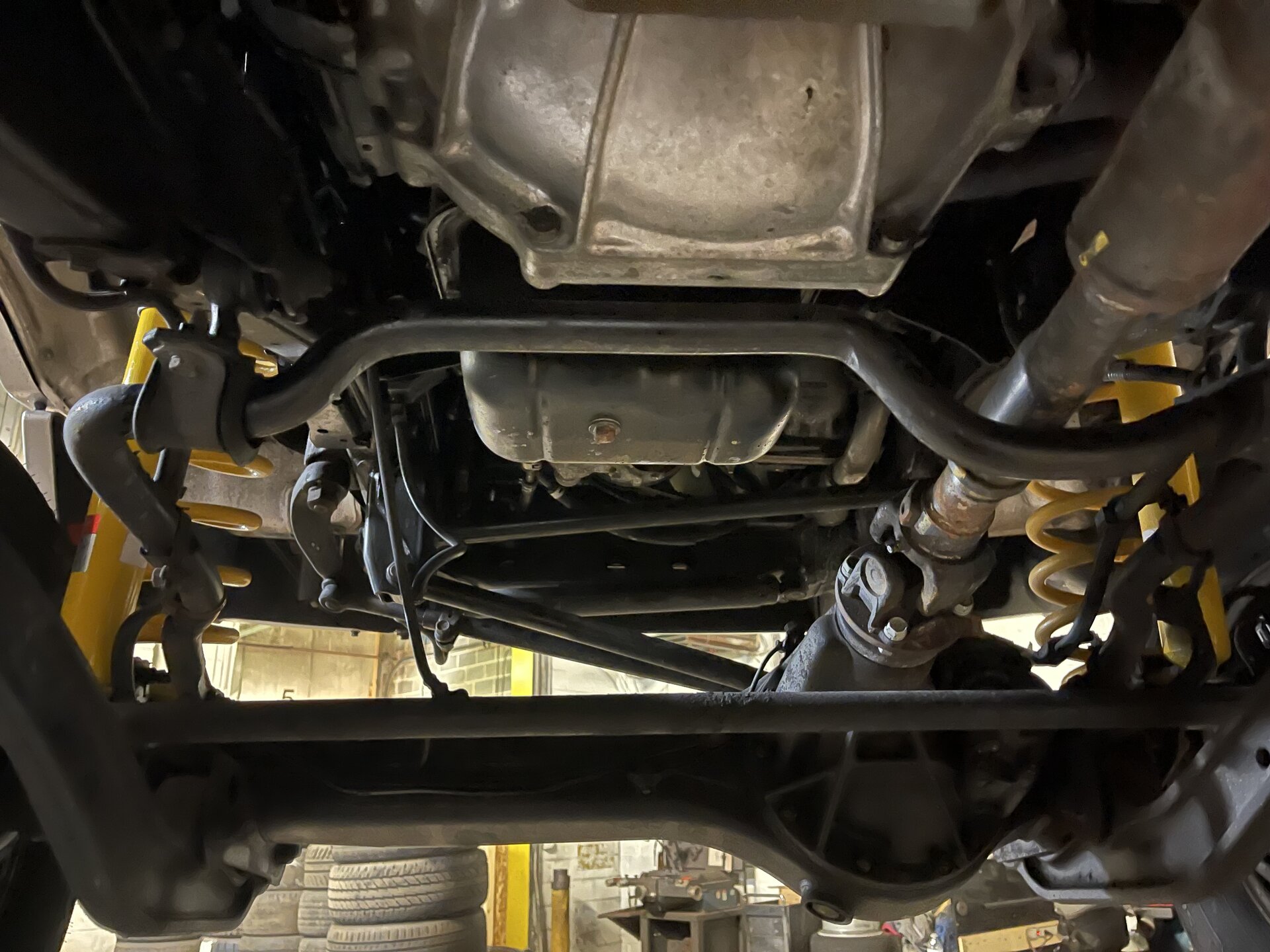

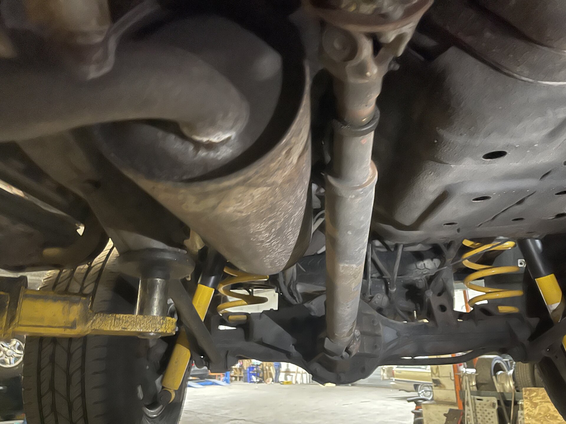

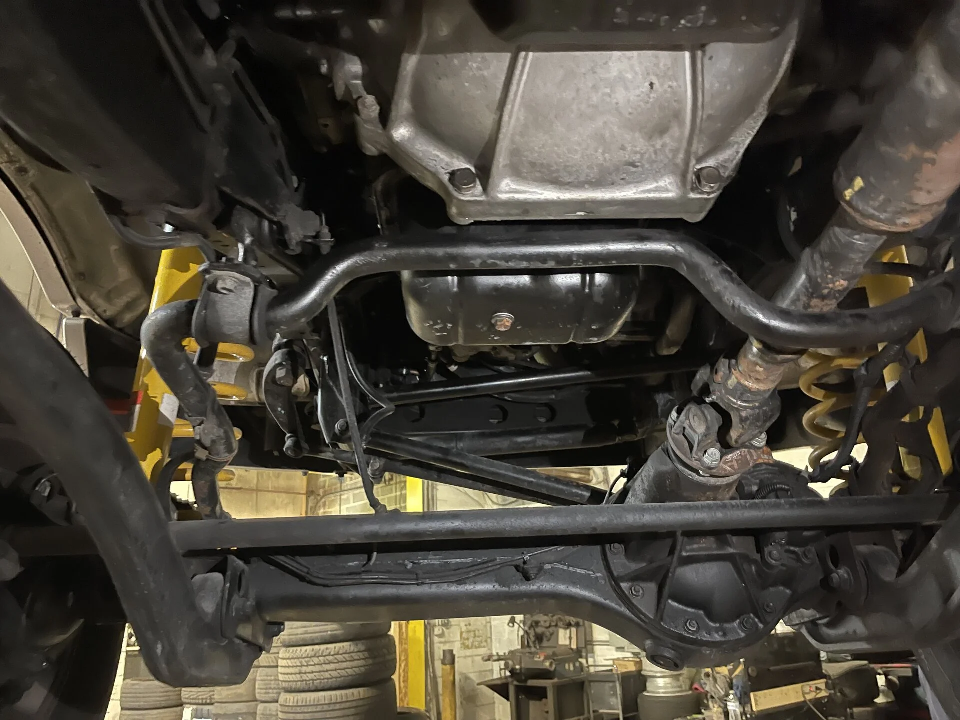

Also provide photos of the LX drivelines for angle access meant front and rear including the ends of both drivelines at the diff’s and transfer case. A photo showing the entire vehicle from the side will also be helpful to get the answers you need.

Ok, well, the pics need to be from the side so angles can be seen. If the LX has a CDL button on the dash, you can remove the front driveline and lock the center diff to drive on the rear only. It’s quite likely that your problem is the front driveline vibrating.

That's a fresh lift or someone polished the coils and shocks and resprayed them :)
Front sway bar isn't dropped as it should be for clearing the front prop shaft on droop. Prop shafts look very dry - at least pump some grease into the ujoints and a few pumps into the slip joint nipples.
Given the 'newness' of the lift, I'll bet it was tossed on to make it all look manly, but nothing else was done to address the lift. New ujoint angles due to new lift. Lot's of possible issues.
As above, lock the center diff (with no CDL button) you can toss it into low range, get the center locked and then pop out the appropriate fuse. Drop the front prop shaft and run on the rear only.

The more you lift, the more you need to correct castor... the more you increase caster, the more you increase the driveline angles. Assuming you have at 2.5" lift, and there isn't a frame side radius arm drop, the pictures make it look like you have no castor correction, so you are likely sitting at around -1 degree with spec being +3 degree (+/- 1 degree).

The bad thing is those pictures are with the LC on a lift. So the angle is exaggerated, if you can get pictures of the drive lines while the wheels are supporting its weight that would give us a better idea.
The front drive line is notorious for growling after you lift an 80. Mine growled for years before I replaced it with one from Tom Woods a double cardan which helps with the growling/vibration you were hearing.
The slip joints on both the front and rear drive lines look pretty dry. Have them grease the slip joints and u joints to see if that helps eliminate some of the growling.
@landtank mentioned that the rear drive line looked out of phase, manufacturers shipped their vehicles with the slip yokes installed differently for a reason. I was told by Kevin that is no longer with us changing up the phase of your front drive line could make a difference in the growling.
Mentioned above Toyota shipped some LC with their drive lines out of phase, which can be solved by dropping the drive line with the slip joint and clocking it into correct position.

Also, depending on the lift, the front shaft starts acting up. Had to replace mine due to the same-ish symptoms you're talking about. I'd also correct the rear like landtank is suggesting.
