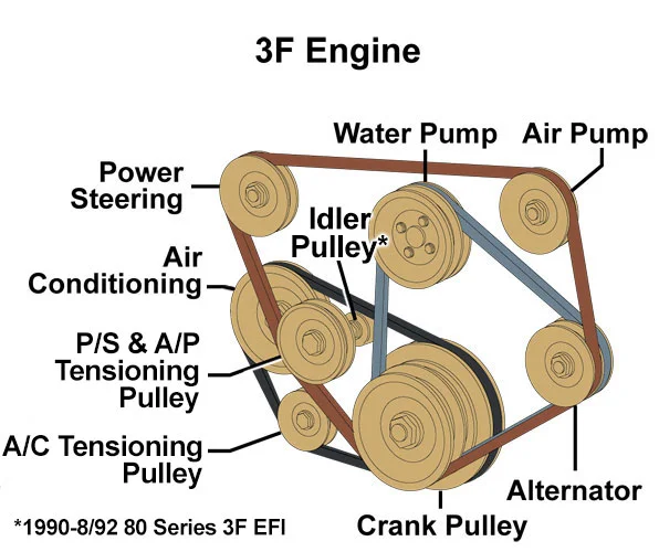

After a little more digging I found a good diagram of the 3FE front end accessories.
Yea I have OEM belts I have not installed yet. Will report back when I get them on
