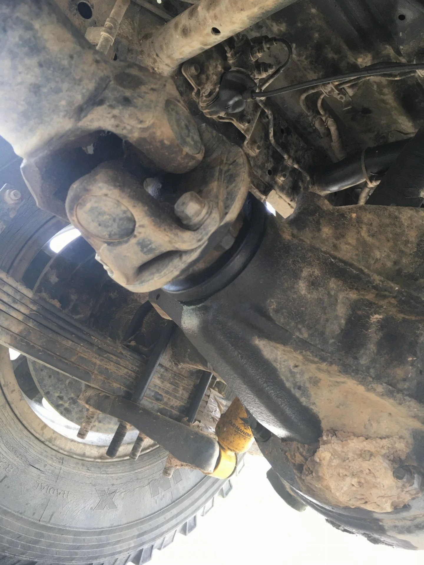

    Axel rebuilds will be coming soon the rear started weeping on the trip back home :doh:

    man, trim those ubolts :p

    I'm going to after the break in period. Which is now-ish. I'm replacing the lower spring pans and pulling a leaf out of the back. I just didn't want to cut twice :hillbilly:

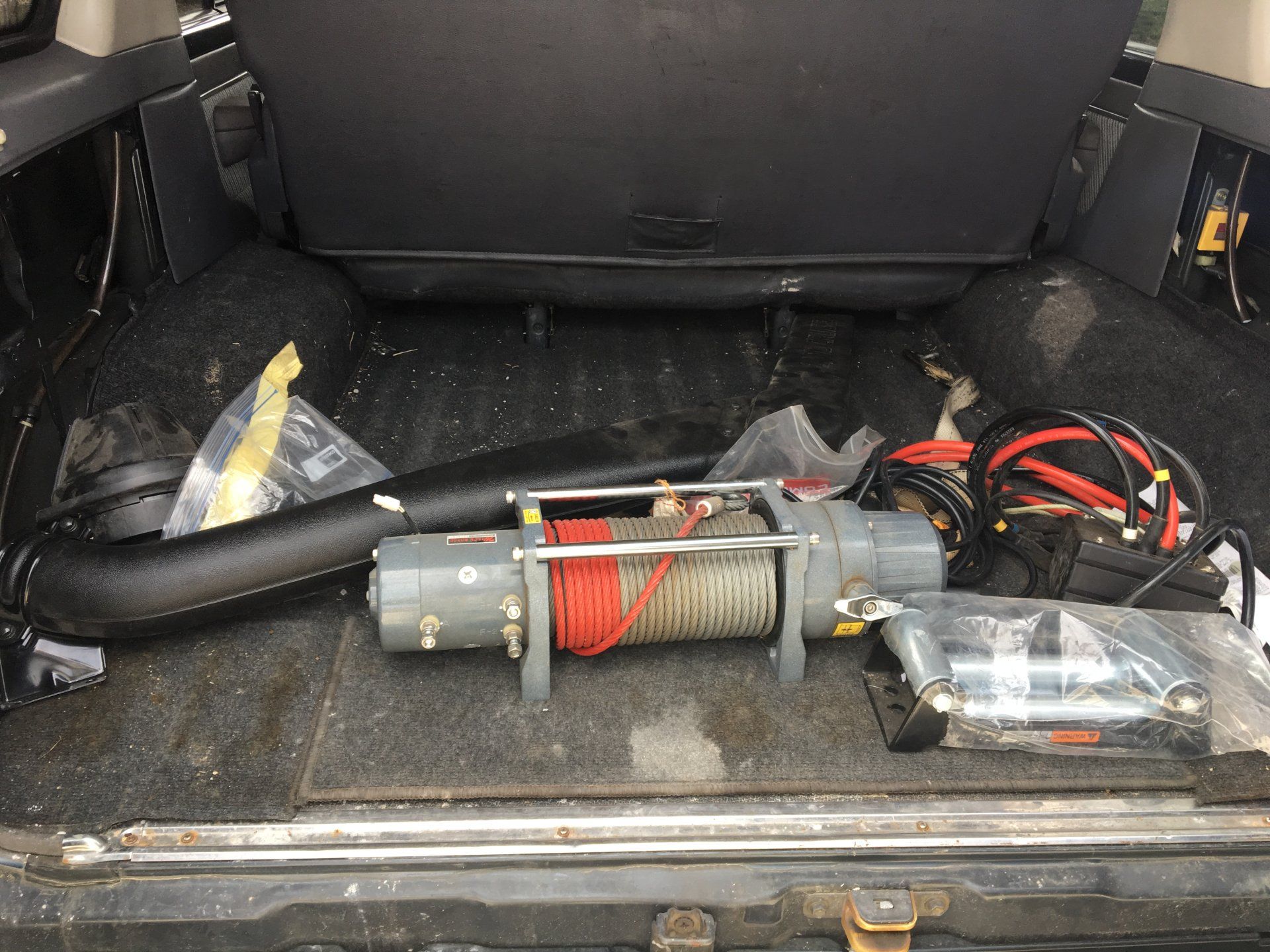

    Deal I couldn't pass up curtesy of @WanderinWhitlows . Comeup 24v winch and factory snorkel. Both have a place on the shelf for a bit as I need a bumper and paint. But these future purchases shifted left. Now is time to start prepping for Cruise Moab 2018 (@Cavalier2000 get your leave in the books!)

    I found the Come-Up manual and hook after I got back to the shop. Glad I gave you the Warn hook as it's definitely bigger and the spring gate is allot easier to manipulate with gloves on. PM me your mailing address and I'll post the manual too you so you can keep it in the 77.
