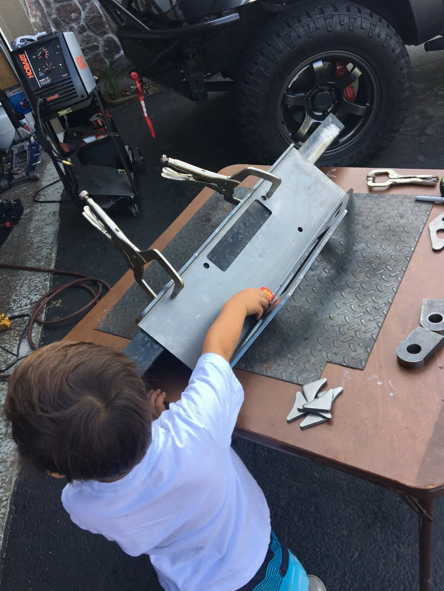

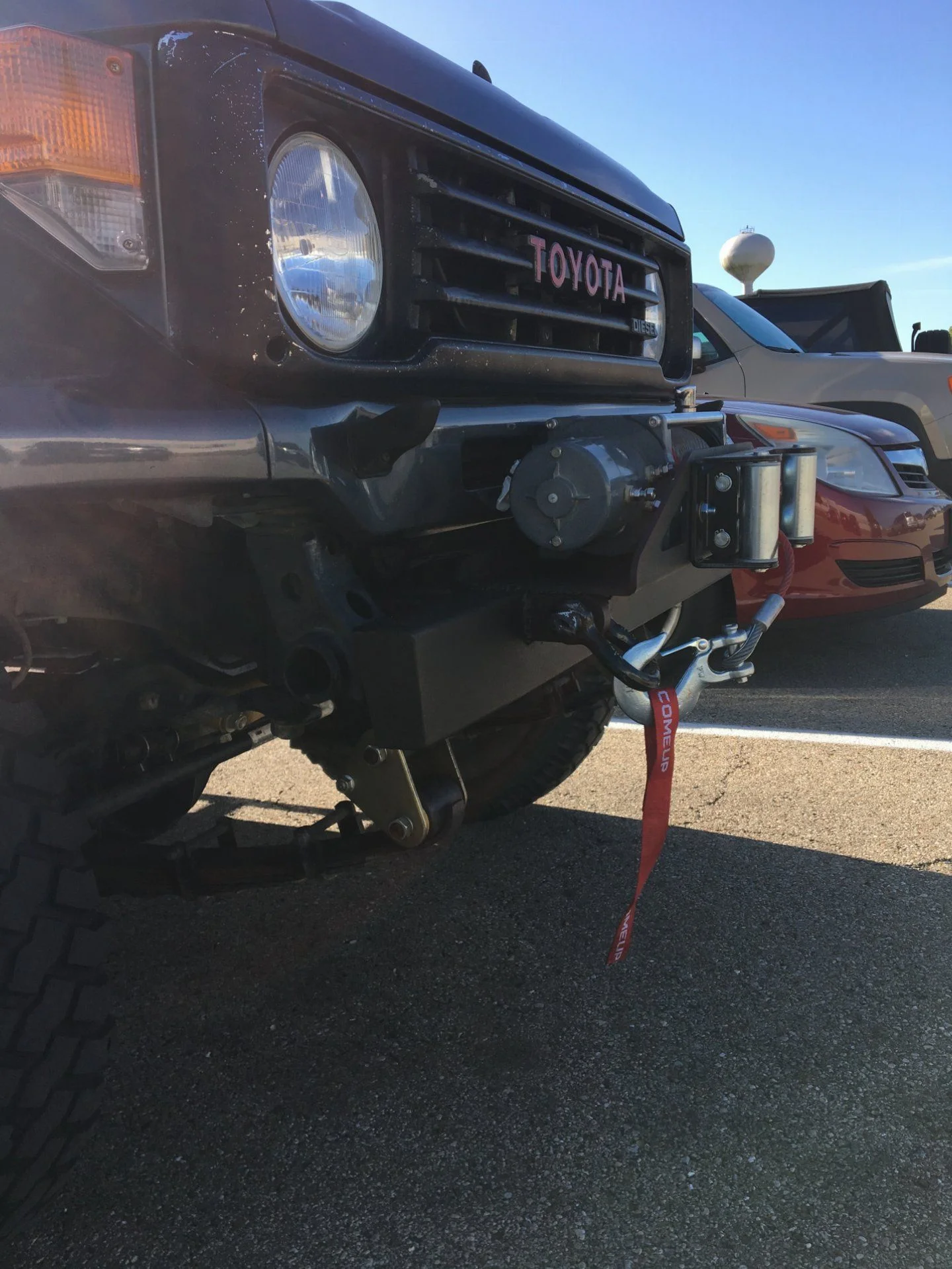

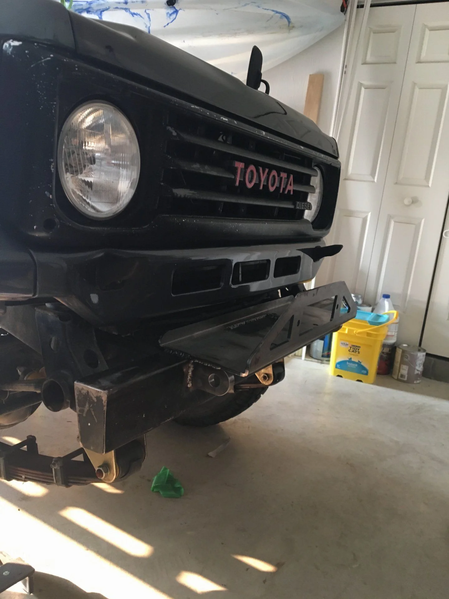

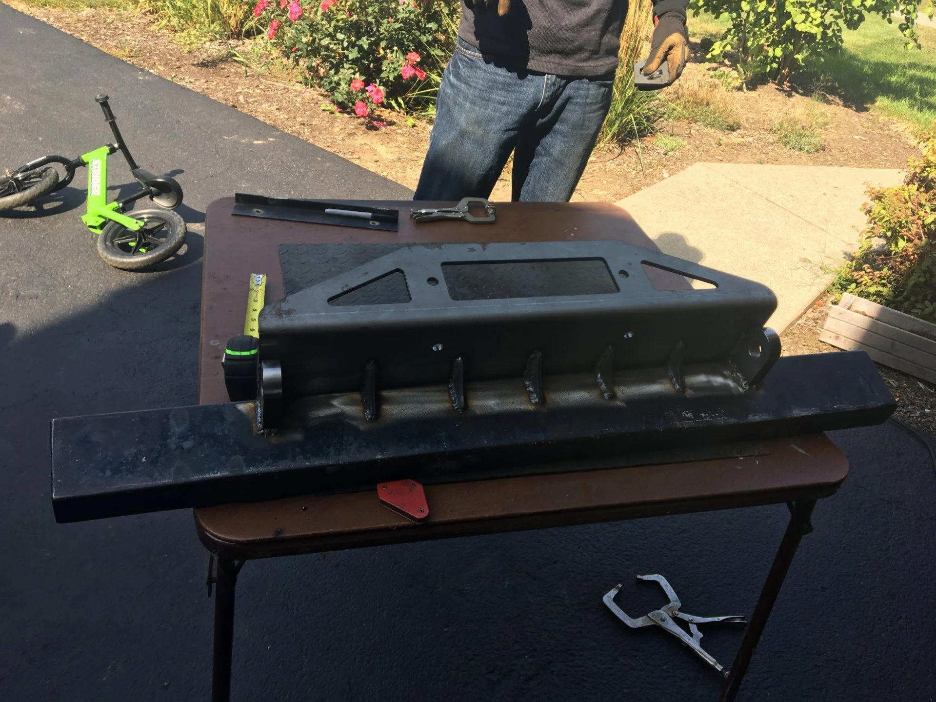

I found some time to start doing prep work for the upcoming 70-Series meet -I'm sure you're all aware it's around the corner. My goal before heading down is to get my truck a bath, a facelift, install a snorkel, and install my winch. Originally I had planned on ordering an ARB bar, but my wife had other plans with some of our excess funds. We ended up taking some time to ourselves down in Key West. Plenty of surface time in the bars and a few dives. Given the tightening of funds, I had to compromise somewhere. The ARB is getting push -yet again- but I still wanted to get the winch installed. I ordered some pre-fab'd parts and hoped for the best. The end result is much better then I expected. $75 and I've got a solid platform to winch off. I coated it in self-etching primer (3 layers, didn't bother sanding or allowing to fully dry) then hit it with rattle can bedliner (3 layers, dried over night in a cold humid garage). Regardless of the expeditious construction, it's functional.
Obviously I still need to mount and wire up the control box, but that should be too much of a headache. I'm likely going to be cutting the lower valence slightly (it's already dented and I have a brand new one on the shelf). Additionally, I'll be Refinishing the mirror arms and adding new mirrors. The grill will be pulled and refinished. I'm likely going to go with black plastidip and painting "Toyota" white. Finally I'd like to get my snorkel installed. We shall see...

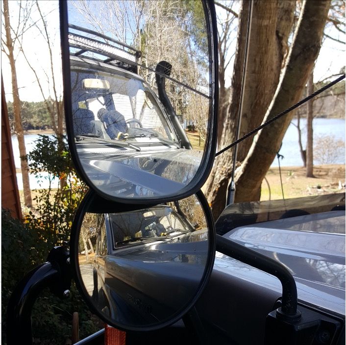

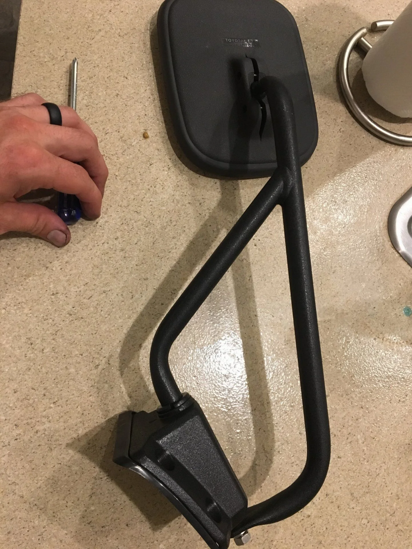

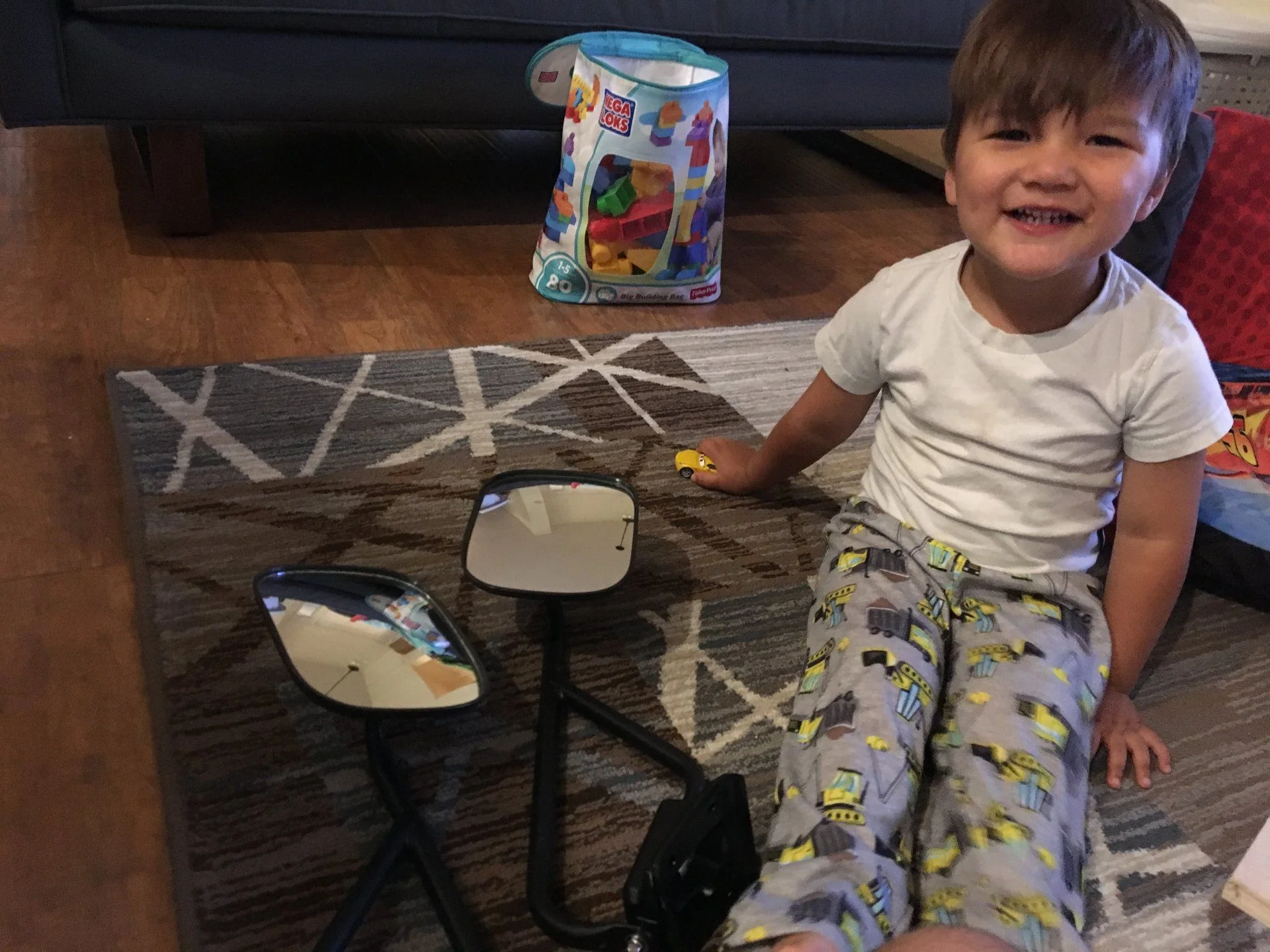

Refurbished my mirrors. Used new OEM lenses. I did end up breaking the carriage bolt on one. Decided to run down to Lowes. I was able to find a similar size carriage bolt in stainless steel. I finished the arms and the bosses in the same rattle-can bedliner. It's worth noting, it's proven to be very UV stable and the color and finish I find attractive on some applications.

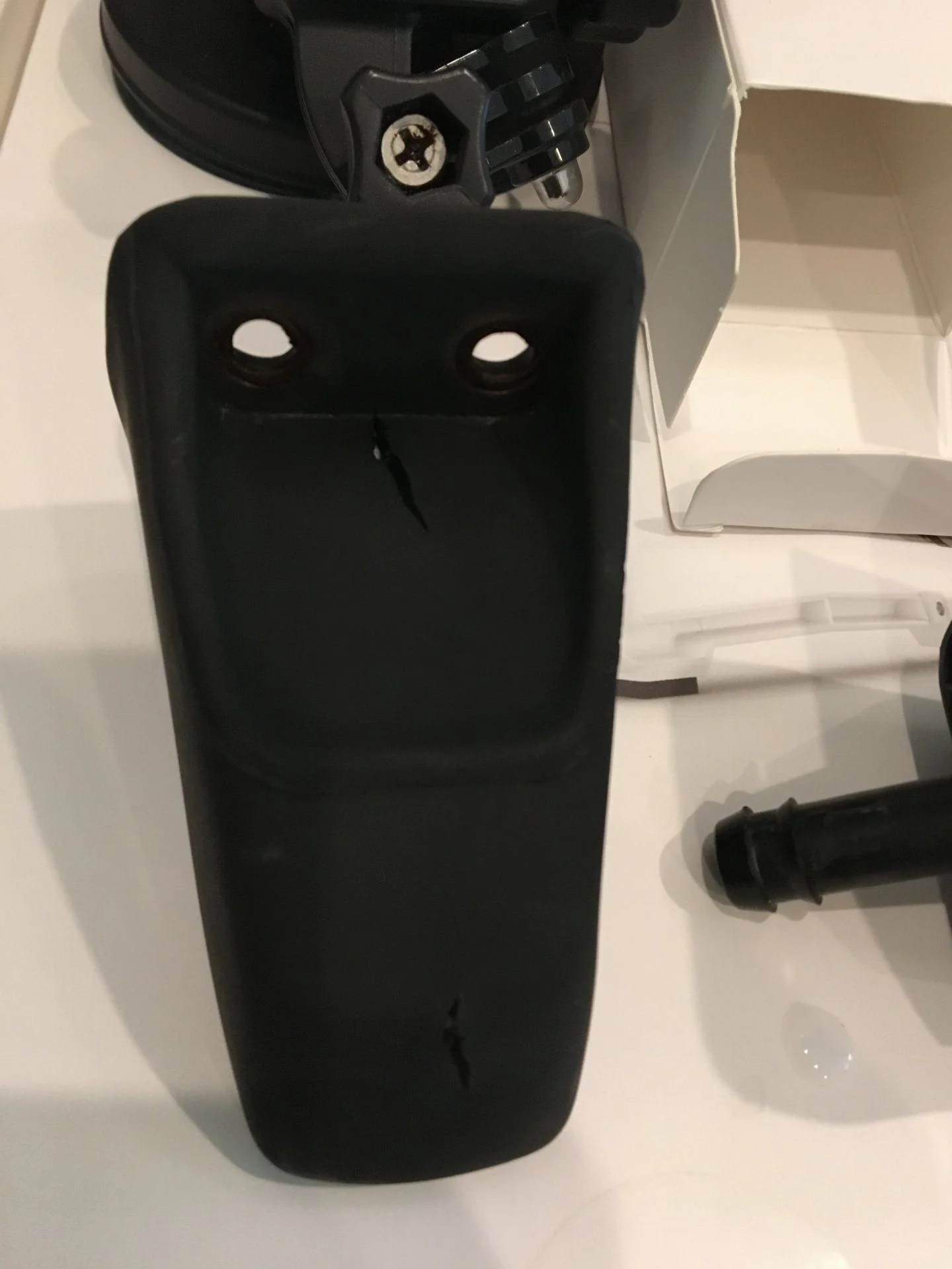

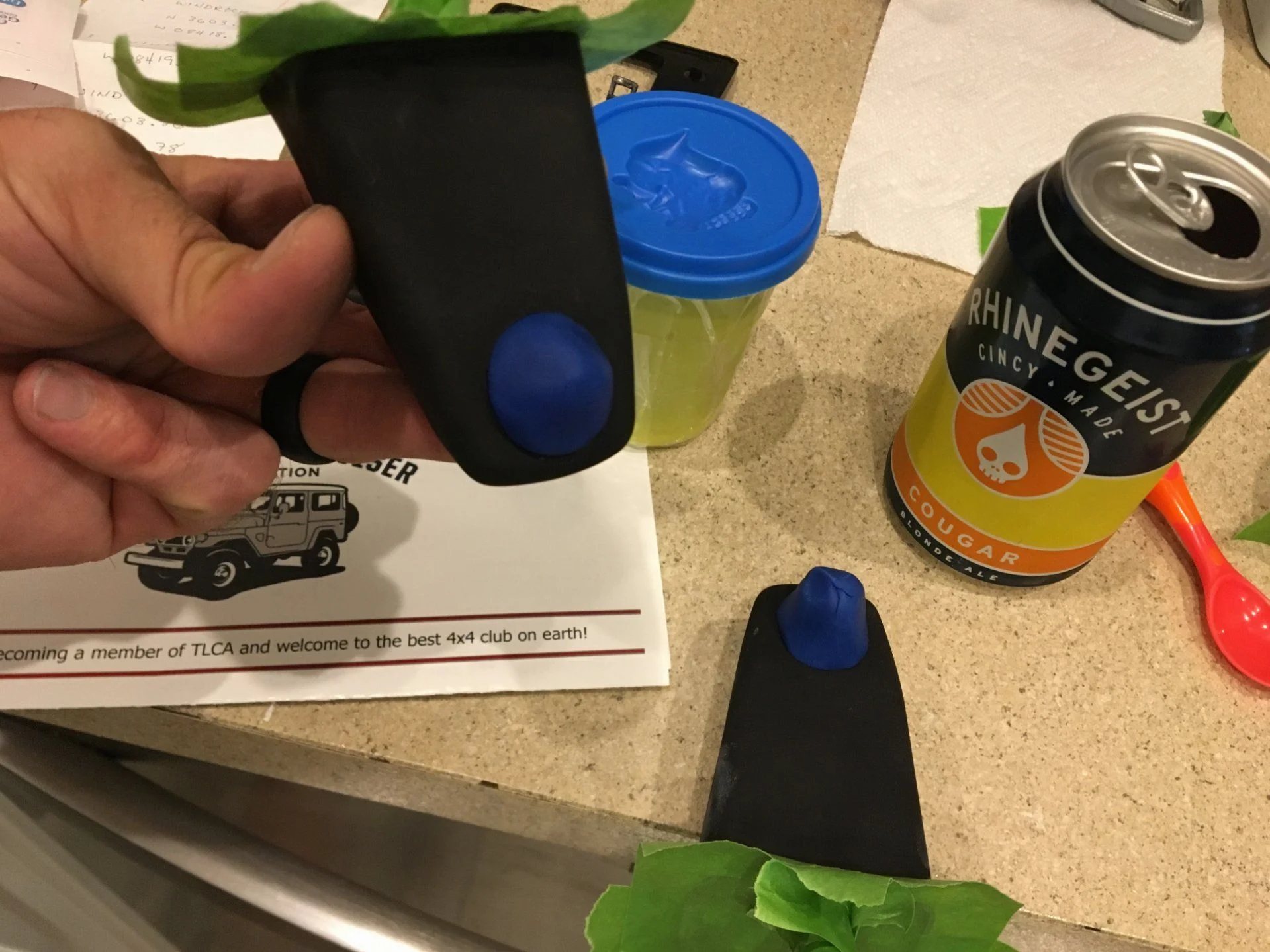

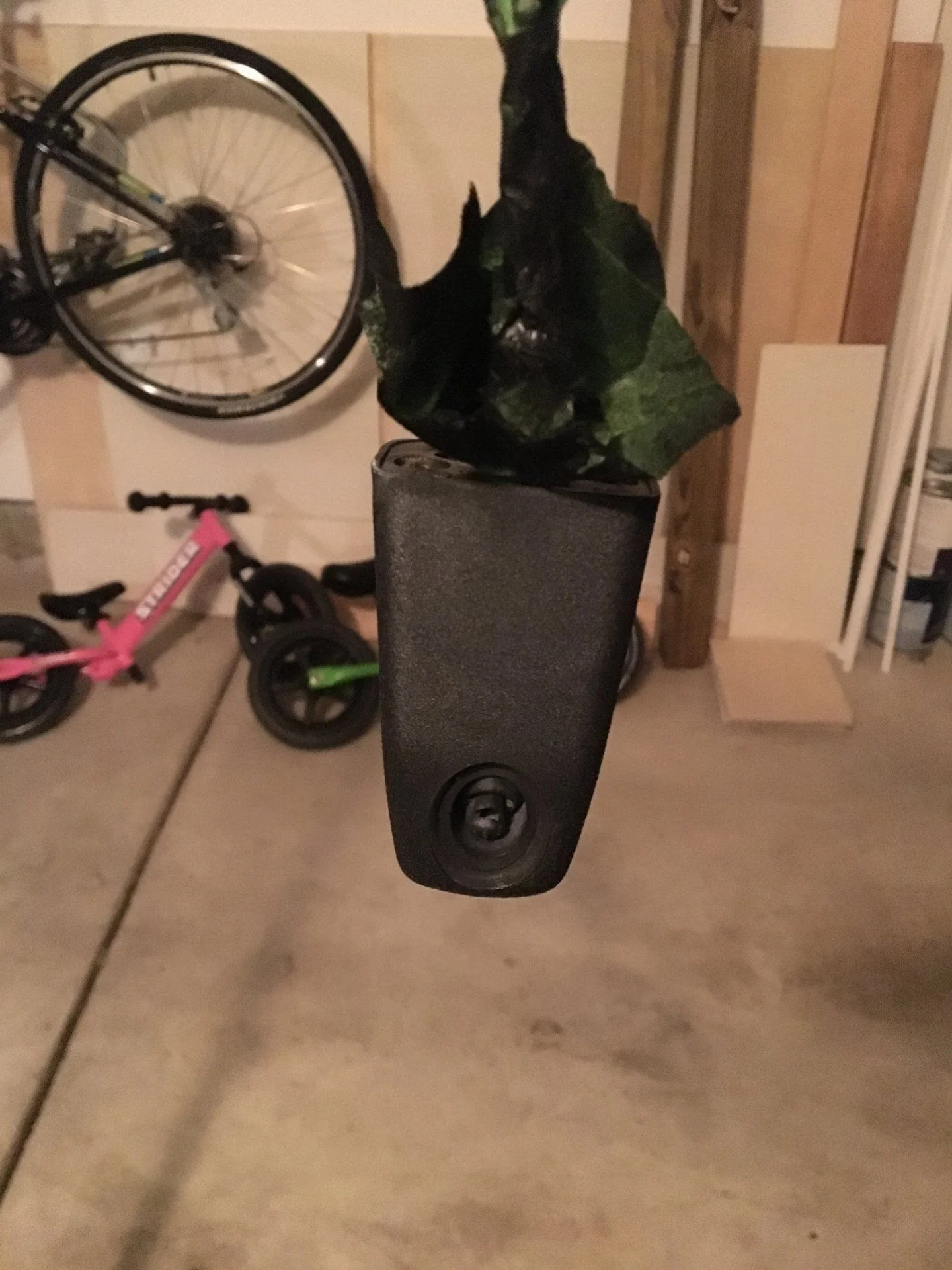

I also refurbished my headlight washer nozzles. I filled the splits with JB water weld putty and painted them with the same bedliner. Pro-tip: if your trying to mask an uneven surface play-doh works great. Spray and remove before the paint is dry.

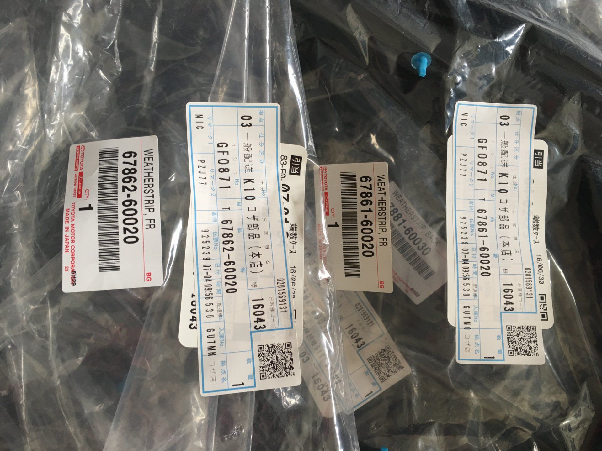

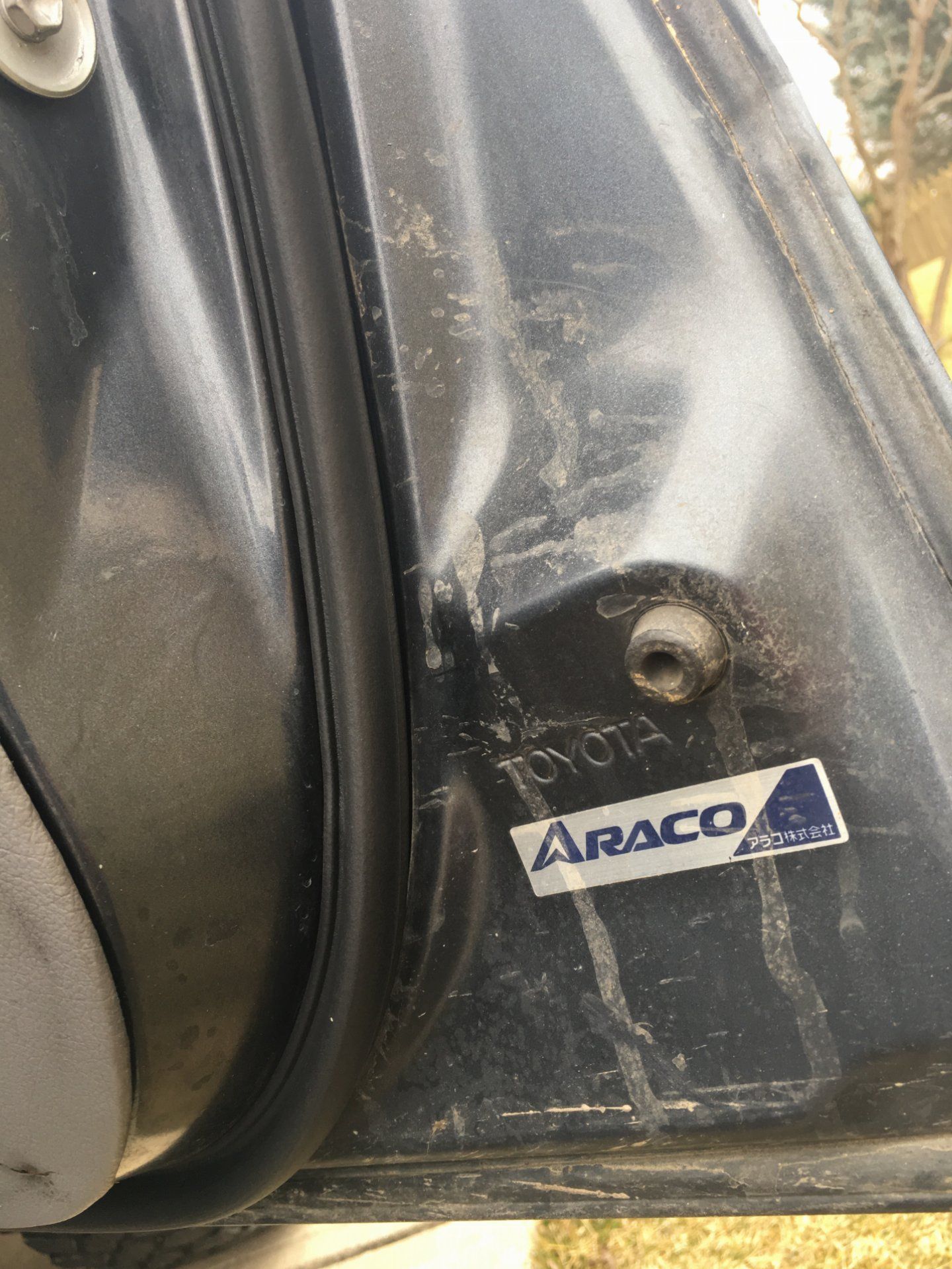

New weather stripping for the front doors. My parts guy in Okinawa is telling me the rear doors are out of production. I may be hitting up @cruiseroutfit for them.
Right off the bat it's harder to close the doors. They should reduce wind noise too. Finally decided to get them done after finding a frozen puddle from melting snow fall.

what application are those mirrors for? They look like they'd be perfect for my 55...
Nic, I added "fish eye" mirrors to my wagon. They really help with rearward visibility.
Definitely not getting in the parts game. I am assuming this guy is in Okinawa and will be shown the Toyota Dealer that we not give you the glazed eyes when you want to order parts..
I’ll take any help I can get...and new friends is an excellent bonus!
They're factory 7X fender mirrors. From my understanding they were optional equipment. Also JDM 60 series have similar fender mounted mirrors (which are better looking in my opinion). New units can be had reasonably. I opted to just buy mirrors and refreash the arms myself.
