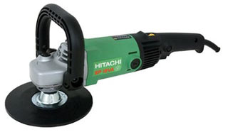

I use one of theose porter cable buffers and they work extremely well. The only downside is that when you're done, you body feels really shaky for about an hour since the buffer has crazy vibrations. You can also use sand paper with it which is a nice bonus. Buffers can get you in trouble if your not careful with them especially with dark paint. Years ago, I had a mishap with a black 911. I was close to tears as experience got the best of me. I learned to start with a side panel or an area least noticable. Even with tons of experience, I always start far away from the hood. Then do the hood last.
Spike, make sure you are using the right size counter weights. I have 2 sets (4" & 6"). When using the brush attachments, I switch to the 4" counter weights. When using the foam pads (6" & 7.5") I switch back to the 6" counter weights. Also, make sure you have the pad on there perfectly straight. That can make the buffer want to jump out of your hand!
Maybe I am just used to the Porter Cable. I have used it for 4 years (~4 to 5 hours every weekend) and I really do not have problems with vibration.

A warning about random orbitals... They can burn through paint. They are definitely more gentle than direct drive units, but they can and will build up heat. If you are buffing a vehicle with a good clear coat, there should not be a problem, just use your head and be cautious.
My brother has a BMC Hooligan chopper and wanted me to try to get the swirl marks off the tank and rear fender. Every time his clothing brushes against them, it causes swirls and slight scratches. I started buffing on the tank and burned right through the black paint. We determined it had little to no clear coat. No more buffer until he gets it repainted. Also, stay away from pinstriping. There may not be any clear coat over them (ask me how I know...).

I second the notion for using cheap orbital buffers that don't have enough guts to damage the paint. They will stall before they do any real damage, but are slow and shaky and will make your hands tingle after a while. Get one at Goodwill for $7 and you're not out much if you don't like it.
I used a pro-grade buffer on my FJ40 (which was too badly oxidized to use the cheapy buffer) and the spinning bonnet pad accidentally caught the outside rear view mirror and slammed it into the door, breaking the mirror glass. Ouch, but no biggie. Things to watch for, however.
Many paint shops sell quart bottles of liquid rubbing compound in different grits, and the 2000 grit is a good starting place for many non-clearcoat cars. It's enough to make a difference, but fine enough that it doesn't go too fast. I don't even use a power buffer on any curved or creased areas - just do those by hand. Practice on a beater car, first, if you can. The teenage neighbor kid might enjoy having his car buffed for free - or least part of it, until you get the hang of it.

A used buffer is a great idea. Just make sure you can still buy the accessories. A neighbor thought I would like another buffer and bought one at a yard sale. It was a 1970s Sears & Robuck 9" random orbital. It ran great, but you could not get pads for it any longer.
Just find a random orbital buffer with an adjustable speed setting. When I first started using the Porter Cable, I never ran it higher than the middle setting. Once I got used to it, I turned the speed up.
A stripped down Porter Cable can be had for about $100 and then buy the 6" counter weight and hook & loop backing plate. For less than $150.00 you will have a buffer that will last a long time.

A true orbital just mimics your hand in a offset vibrating motion. It's like applying wax with your hand only it doesn't have the voids your hand does. It's flat. They usually have about a 4 inch thick foam pad on them. Unless you're using some heavy grit rubbing compound, it would be hard to rub through paint. An actual buffer usually has a solid disc with no offset. Its basically a sanding wheel. Only difference is you can buy foam, wool and cotton pads for them. Some, like my Hitachi, have variable speed. That's one way to control swirl marks and burning through paint. The other way is both product used and pressure applied. Since there's no real padding you are basically applying solid pressure to the paint. You also need to constantly clean the pads. You're essentially pulling a thin layer of paint or clear coat off. This gets built up in the pad and needs to be removed. If its not, it will scratch the paint. For wool pads the make a tool that looks like boot spurs with a handle. This kicked the used up product out of the pad and fluffs up the pad. The critical area is your corners and fixtures. Corners are a prime area to burn paint off because its all of your pressure is being applied in that area. Also, when buffing around side mirrors and such, the pad can catch on something and really pull the buffer out of your hands. If you're not real experienced, stick with an orbital. Below are pictures of both a orbital which basically vibrates once pressure is applied and a buffer/polisher.

Actually I think you've got it backwards from my research. The buffers (simply rotate, have more power and speed) are much easier to damage paint with by an amateur than the orbitals (lower power, and do random circles). Buffers will easily generate enough pad speed to make serious heat and such. Just wanted to clarify and be sure we're on the same page.
Also, some have said don't bother with the cheap orbitals. Much of the point of this thread was to say that a cheap orbital worked perfectly so I disagree. I'm sure for those with detail experience they'd rather have a good one but that's the voice of experience speaking. I like the low power and idiot proofness of this approach and yet the lack of power did not make it slow or tedious. In fact, I was surprised how quickly I was standing there with everything put away. So to me I don't see a down side to a cheapy other than the good points about being sure the model you choose isn't an odd size where you cannot get replacement pads and such. Those are out there, so shop replacement pads before buying.

Doug, I was saying that even with a random orbital, low speed buffer, you can and will burn through paint if you do not use it correctly and with caution. The direct drive units will build up much more heat than a random, but if you do not use a random correctly, it can do the same damage. Please point out the confusion I created. I went back and read my previous posts and thought that I was clear about that.
As far as cheap buffers, trial and error. I tried a couple of cheap, department store buffers and just did not like the results. Once I started doing other people's vehicles, I did some research and found the Porter Cable. I dropped $200 on the set up from Griot's, but could justify it by charging $200.00 per detail. I spend 2 days on a vehicle (usually Sat. & Sun.) and clean a car like I own it. I will never get rich doing this, but make enough to keep a nice selection of tools and chemicals handy to do my own vehicles.
