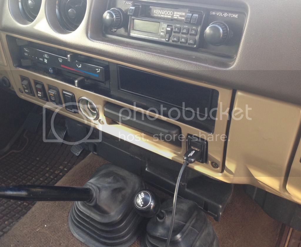

Modified a blank plate to handle a USB charge port. I tapped off of the trouble light socket so it'll charge even with the ignition off.
Now that is slick.
Any progress pics, or materials used?
well, I didn't really take any build pics, but I can show you this:
I started with a $5 lighter charger from walgreens, like so:
They come apart pretty easy and the board is compact. I clipped the LED off and epoxied the rest into the blockoff plate after cutting a slit for the receptacle. Power wires are soldered at the location of the original springs.
