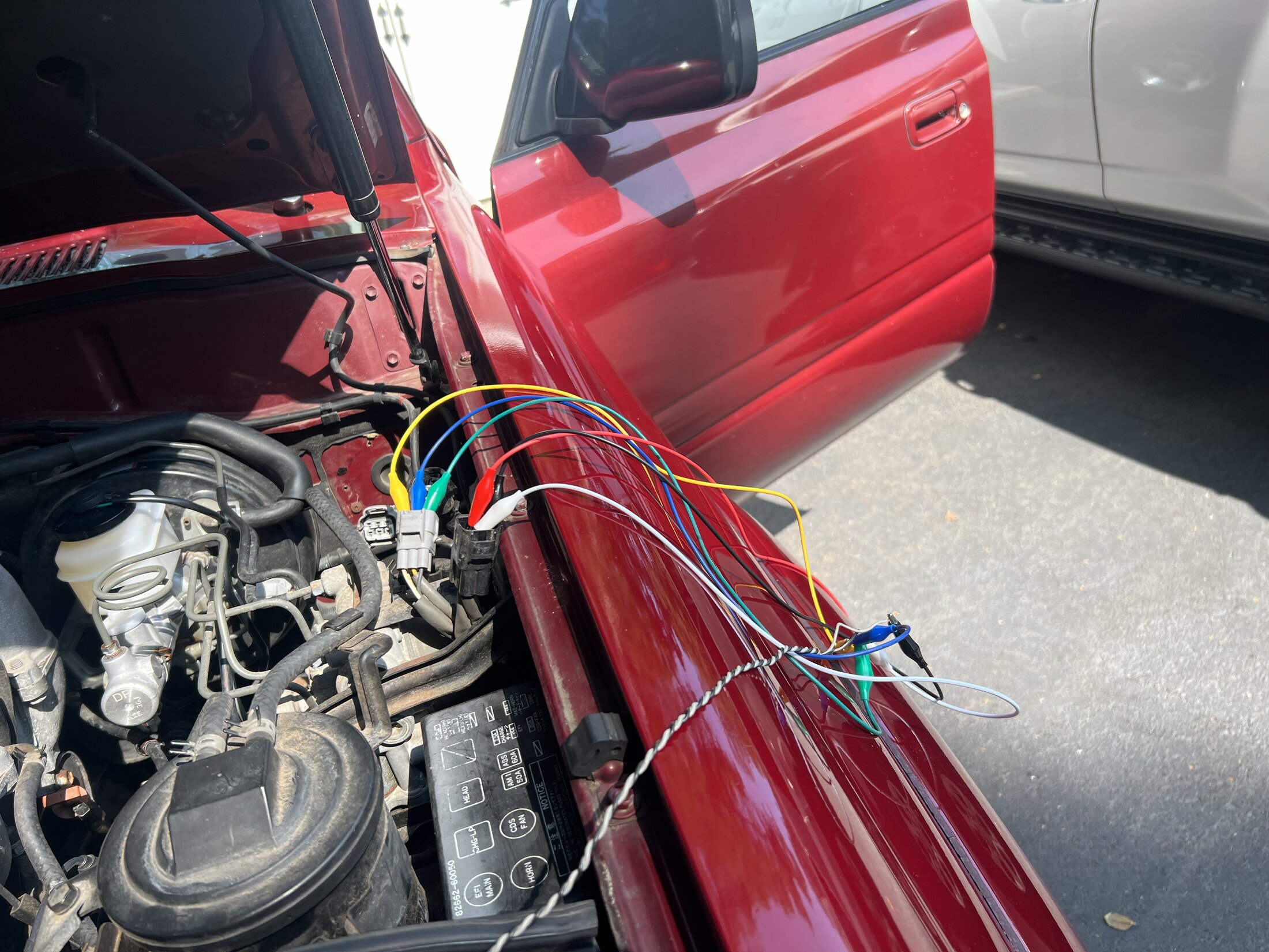

Update:
I activated the ABS with a battery. No change.
Abs light does come on with Low range.

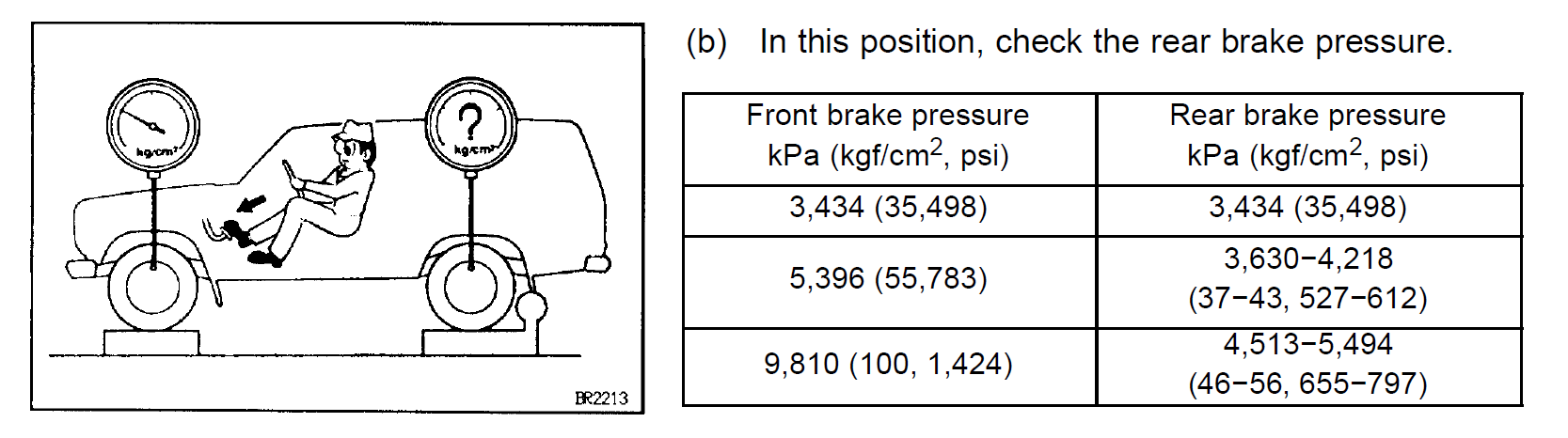

I've attached my annotated and bookmarked brake repair section (from the 1995 Toyota service manual). It includes the entire brake section (BR-1 thru BR-63, with ABS and troubleshooting sections. Hope it helps.
This chart tells you how the proportioning valve should be set, but also gives you an indication of target working pressures:
I would consider the first case to be dragging my foot on the pedal (just enough pressure to keep it from moving with a 1000rpm engine load). The third case is a panic stop. Unless you're trying to balance the valve, you can ignore the second case; it's there just so that the technician can see the valve is starting to open.
In any case, you should be able to generate the maximum pressure indicated. If you can't, there a system leak.
I would consider the first case to be dragging my foot on the pedal (just enough pressure to keep it from moving with a 1000rpm engine load). The third case is a panic stop. Unless you're trying to balance the valve, you can ignore the second case; it's there just so that the technician can see the valve it starting to open.
