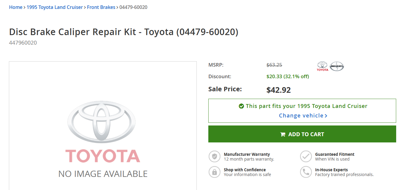

Front brake caliper, 2 each required:
Pistons (if required, usually not); 4 each caliper required:
Rear brake caliper, 2 each required:
Pistons (1 each caliper required, usually not):

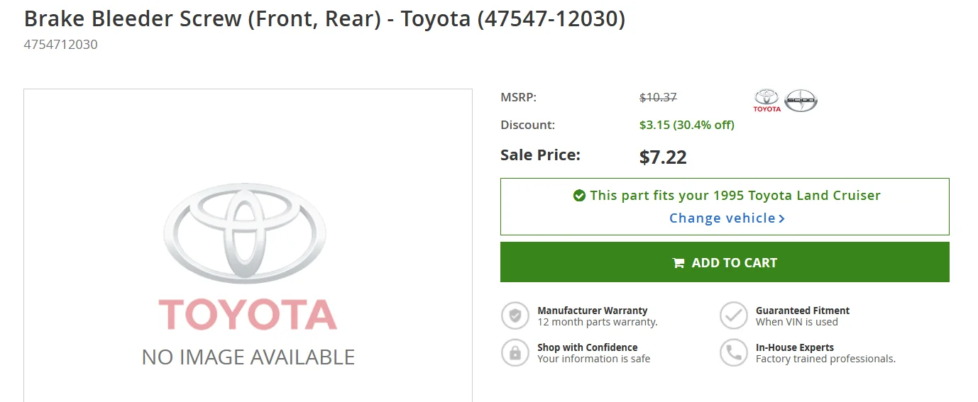

and just for grins:
This fits the LSBPV also. New valves come with a screw installed.
No bolts, screws or nuts required. You are not supposed to take the front caliper halves apart when you rebuild them, and the rear is one piece. If you need sliding pins for the rear:
47715-22010 @ $13.59 each (2 required, per caliper)
The front caliper pins come in the brake disc set.
If you remove the front caliper using the caliper mounting bolts (you are not supposed to do it that way), you should replace them when you remove them (if you're like me and follow the FSM recommendations for non-reusable parts). If, however, you follow the FSM and take the reaction arm off the caliper body, you do not have to install new bolts. If you replace them once, and keep the underside reasonably clean, they should last your lifetime.
So, rebuilding just the two rear calipers, less pistons, = $27.64, plus tax and shipping.
No way this is a wash with the price of just one caliper. A little more for the front, but same cost comparison.
All prices are courtesy of Ourisman Toyota of Richmond, VA.
