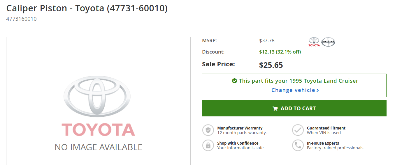

Pistons (if required, usually not); 4 each caliper required:

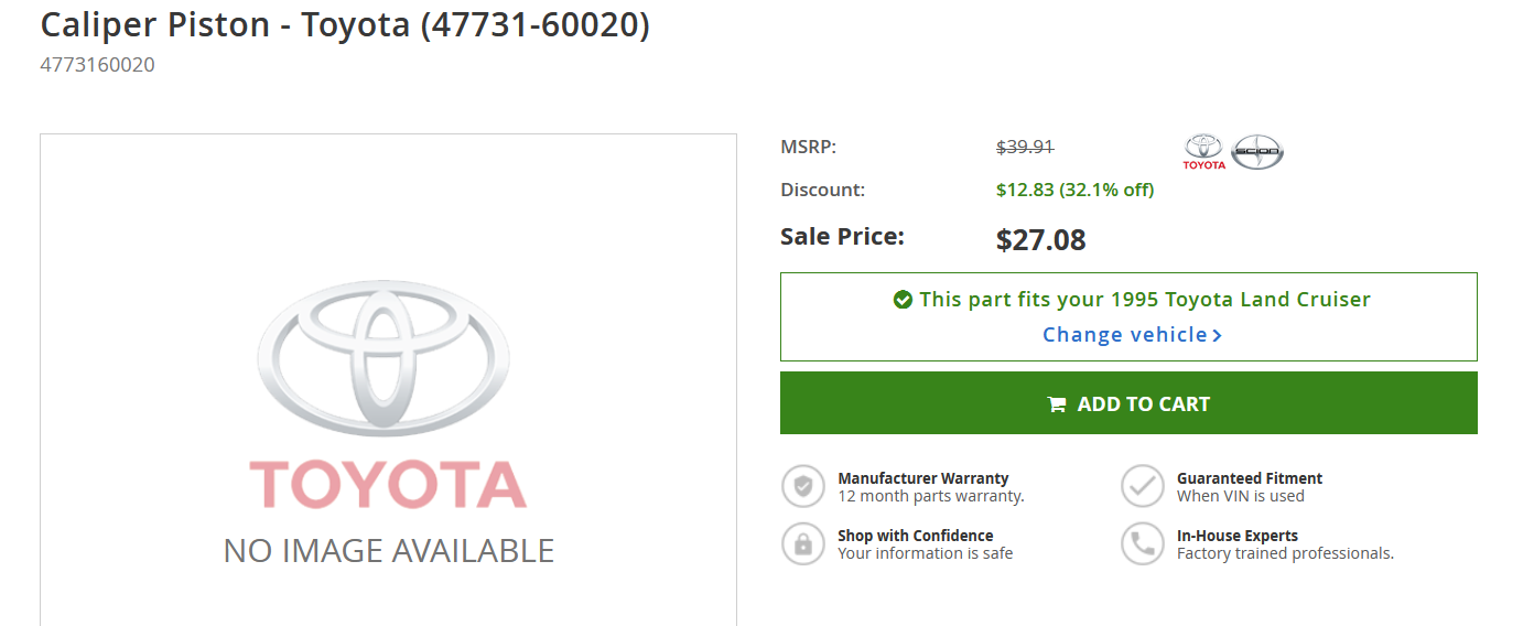

Pistons (1 each caliper required, usually not):

47715-22010 @ $13.59 each (2 required, per caliper)
The front caliper pins come in the brake disc set.
If you remove the front caliper using the caliper mounting bolts (you are not supposed to do it that way), you should replace them when you remove them (if you're like me and follow the FSM recommendations for non-reusable parts). If, however, you follow the FSM and take the reaction arm off the caliper body, you do not have to install new bolts. If you replace them once, and keep the underside reasonably clean, they should last your lifetime.

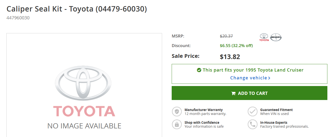

So, rebuilding just the two rear calipers, less pistons, = $27.64, plus tax and shipping.
No way this is a wash with the price of just one caliper. A little more for the front, but same cost comparison.

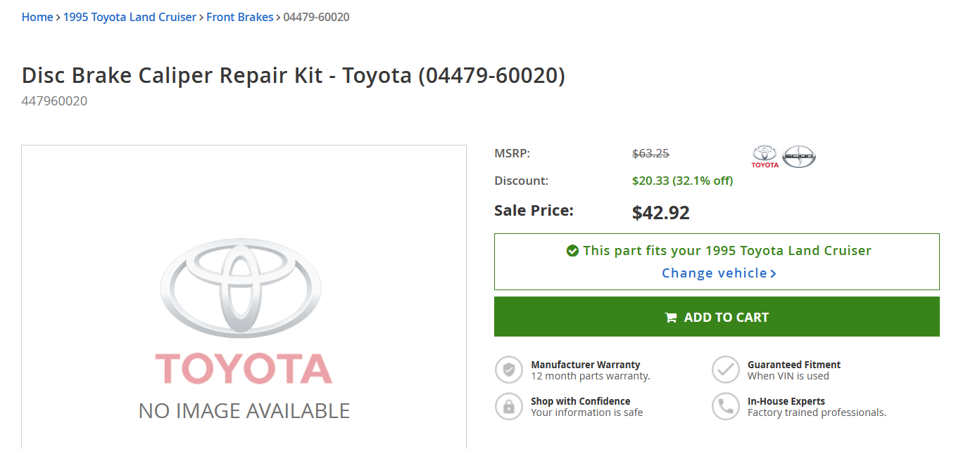

04479-60020 Front caliper overhaul kit (qty 1 does both sides)

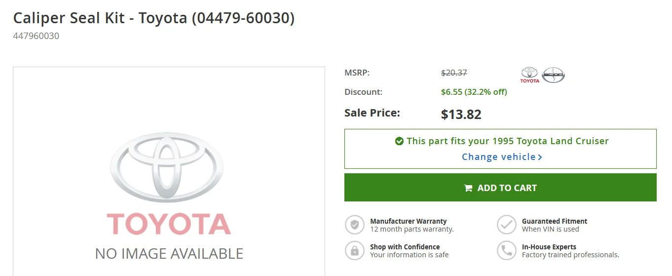

04479-60030 Rear caliper overhaul kit (qty 1 does both sides)

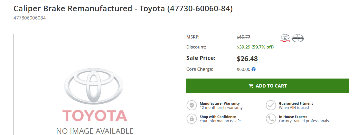

I also noticed that Ourisman is selling rebuilt front calipers for $26, which is ridiculously cheap. Maybe a mistake?
47730-60060-84
47750-60060-84
Rear calipers are $61 without the mounting bracket.
47730-60070-84
47750-60070-84
Unbelievable!
I'm buying some just because I can. Even with shipping the cores back, that's a smoking deal.

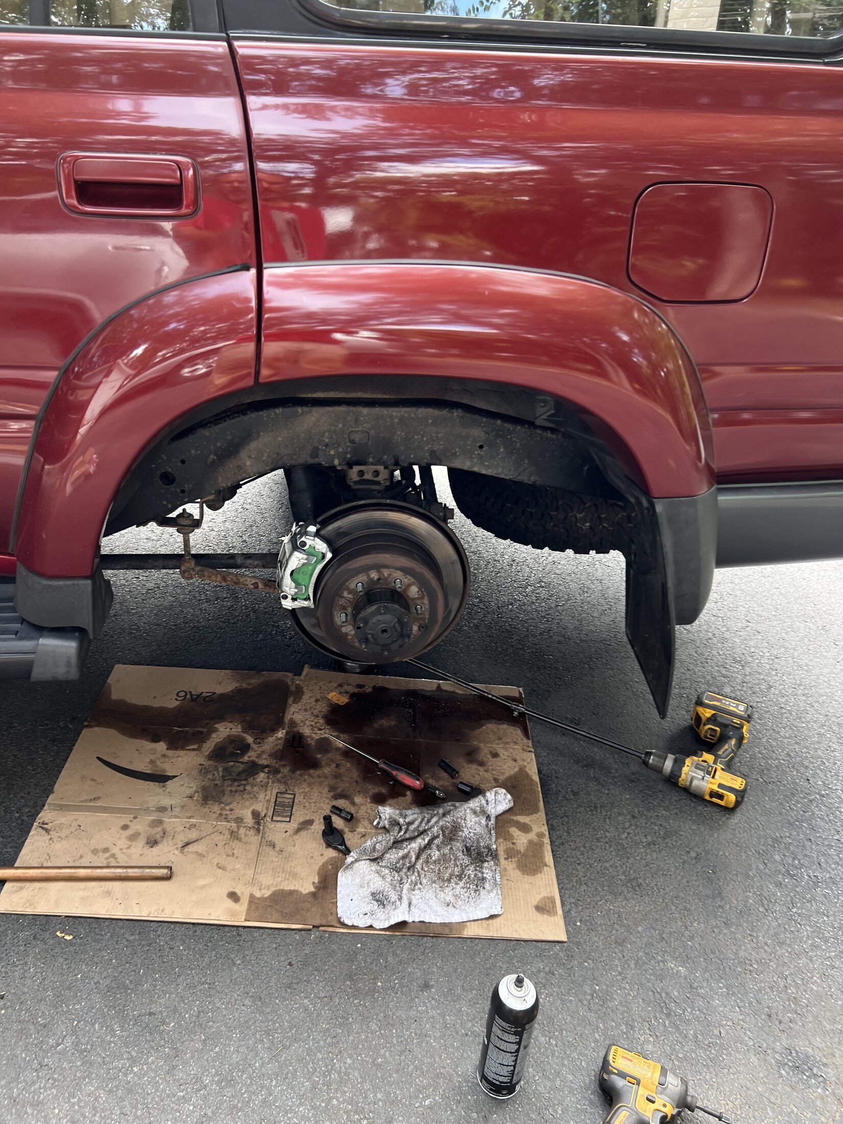

TL;DR: Calipers fixed 90% of the problem.
I replaced all four calipers with remanufactured ones from O’Reilly’s, which solved 90% of my issue. The difference is dramatic! I can Stop now.
Unfortunately, the right rear caliper they gave me was defective and wouldn’t seal around the banjo bolt, so I still need to fix that wheel and am waiting on the replacement part.
The old calipers were in worse shape than I thought—the retaining clips for the rubber boots had disintegrated and weren’t doing their job anymore. Front pad wear was even, but some of the calipers must have been stuck. Now, the pedal is super sensitive, and more importantly, I can actually stop—so well that I’m giving everyone whiplash because I’m not used to it!
On the bright side, I went from getting 12 MPG to 15 MPG!!!!
I should also mention I did a half-ass job bleeding the brakes, so I might still see some improvement. Overall, I’m glad it worked, but something still feels off. I suspect the lines might be bulging somewhere I can’t see. For now, it’s good enough.

Update 2:
I got the 4th caliper on. Brakes are near perfect. All the strange pedal feel must have been that 4th on. One more good bleed and it will be perfect. Thanks for all the help.

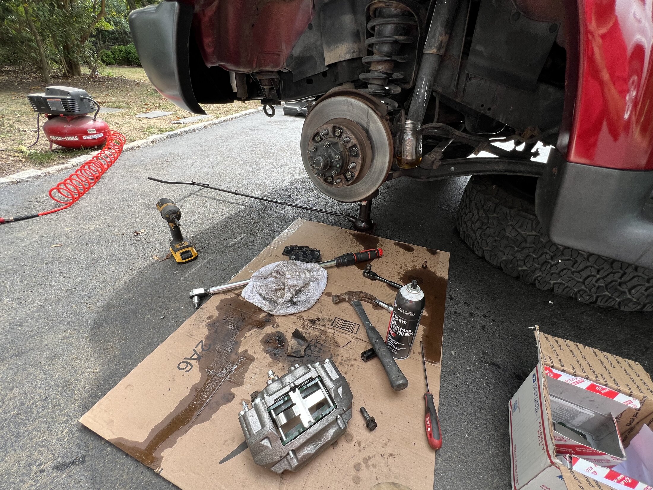

I tried a few rounds of caliper rebuild from auto part stores and they all sucked bad. Very poor workmanship. Buy the toyota kits and rebuild your own. It is so much better that way.
I heard some stories / reviews about some bad ones but these looked mint. One had an imperfection of the seat for the banjo bolt but other than that one, they look indistinguishable from a brand new set. Very happy with them.

Well, I don’t have unlimited time on my hands so I have to try to actually fix the problem in the time allotted. I accomplished that goal with the new calipers and they work absolutely perfect now.

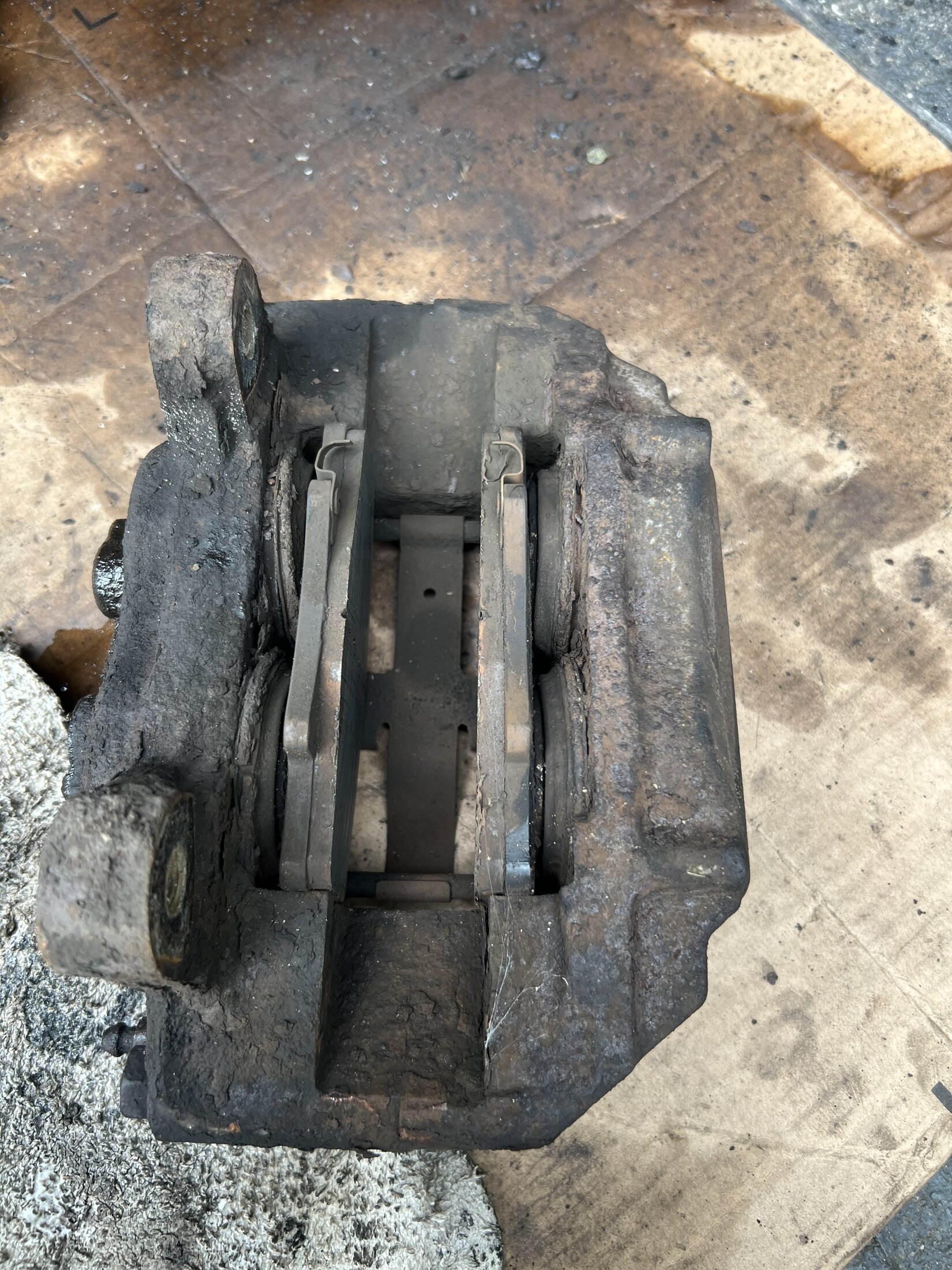

My rear calipers were not fully retracting and grabbing the rotor. These were Napa remans and were replaced 8 to 10 years ago and replaced OEM. I was never impressed with the quality of them but they worked but better than my OEM. My dealership is running 25% off OEM parts so I picked up Toyota remans to replace the Napa calipers.
Final price is $147 with tax. Checking Rockauto, this seems to be a better deal and in the future I will rebuild these instead of replace.
