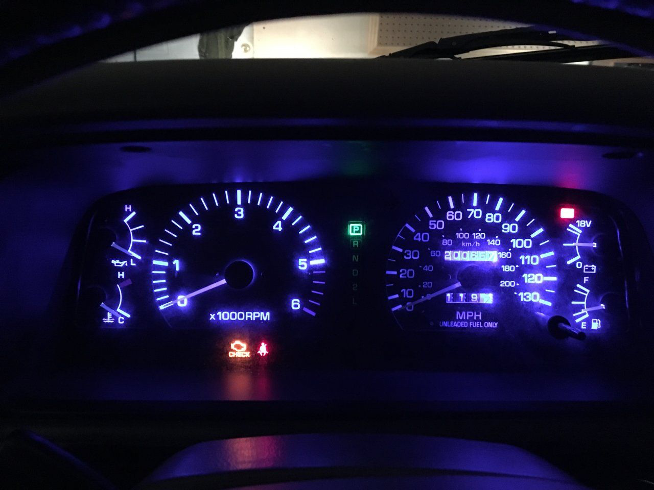

If you've no CEL on the dash it's burned out or someone removed the bulb - it's an easy fix.
When you start the truck does it light up ?
I'd replace the bulb and reset the code and see if it reappears = you may get enough time before it triggers again to get through emissions
Then go ahead and properly address the issue of the P401.

I'm not sure? I'm a female that knows nothing about trucks but trying to learn because mechanics are expensive. As for the lights, seatbelt light, brake light.... regular stuff. Are these fixable things I can find in my Haynes manual? I'm in DT Portland. I appreciate your time.

Fixing any burned out warning lights is a matter of a removing a few screws and a bit of swearing to pull the gauge cluster out - not that hard at all.
When you first start and turn the key to ACC position - the truck the CEL light should light then go out as you start the engine - directly below the x1000 rpm.
