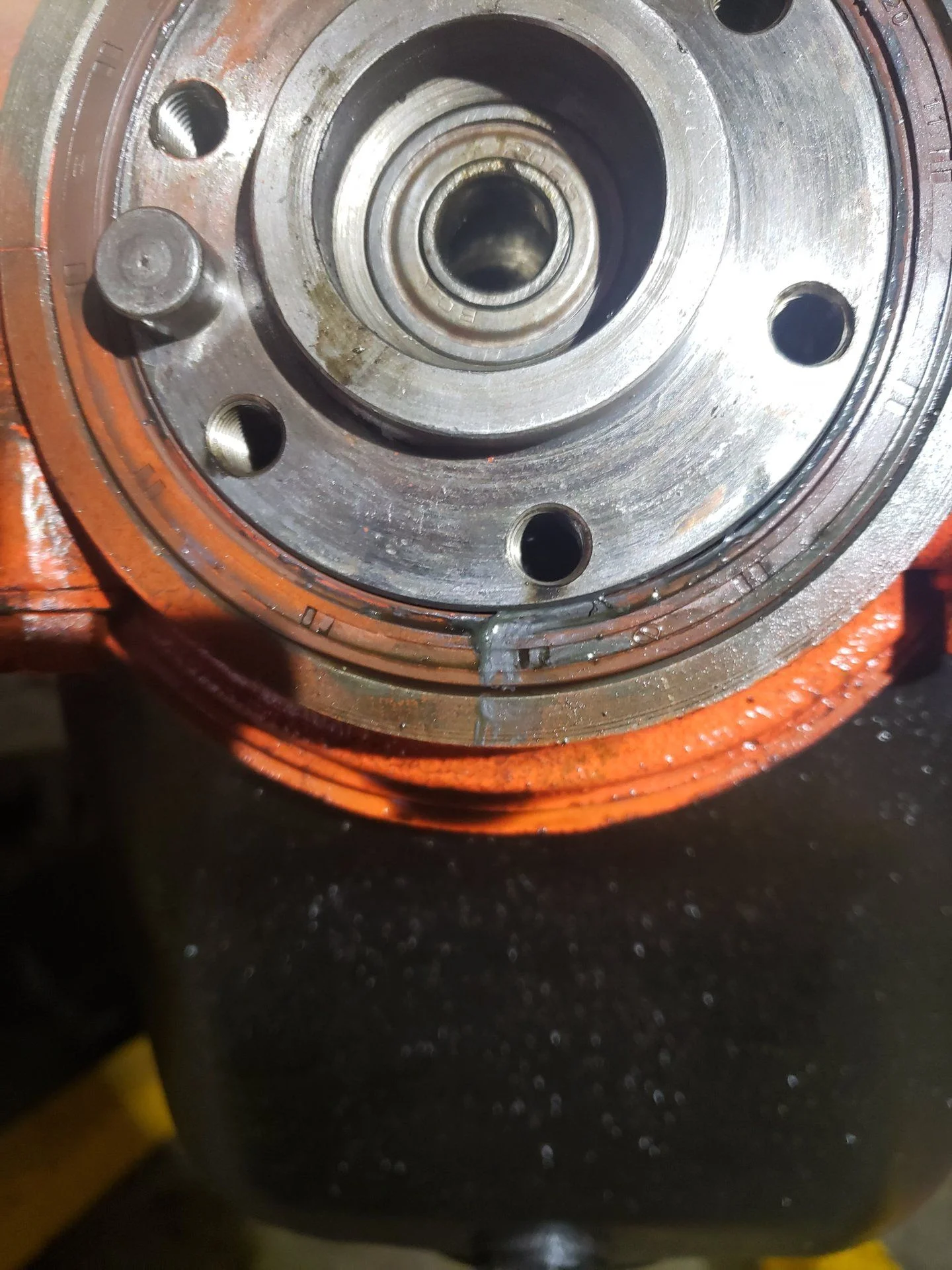

Hi, I would love advice. I'm at a loss. I rebuilt my 5/1973 F engine a little over a year ago. Full rebuild, new cam, etc. It has been leaking since then so I decided to pull the motor and check.
The rear main seal is definitely one of the leaking parts. Does anybody know why/how it could be leaking? Could I have installed it wrong?
I am ready to install the new seal but I'm scared to put it back together before I identify what I did wrong in the first place. I don't want to do the same thing again unknowingly.

In the pic it looks like a tiny piece of swarf stuck to the seal. I assume it's on the outside and not lodged between the seal and crank?

And yes, the fragments, or swarf, that you see are all on the outside of the seal. Thanks for teaching me a new word lol
