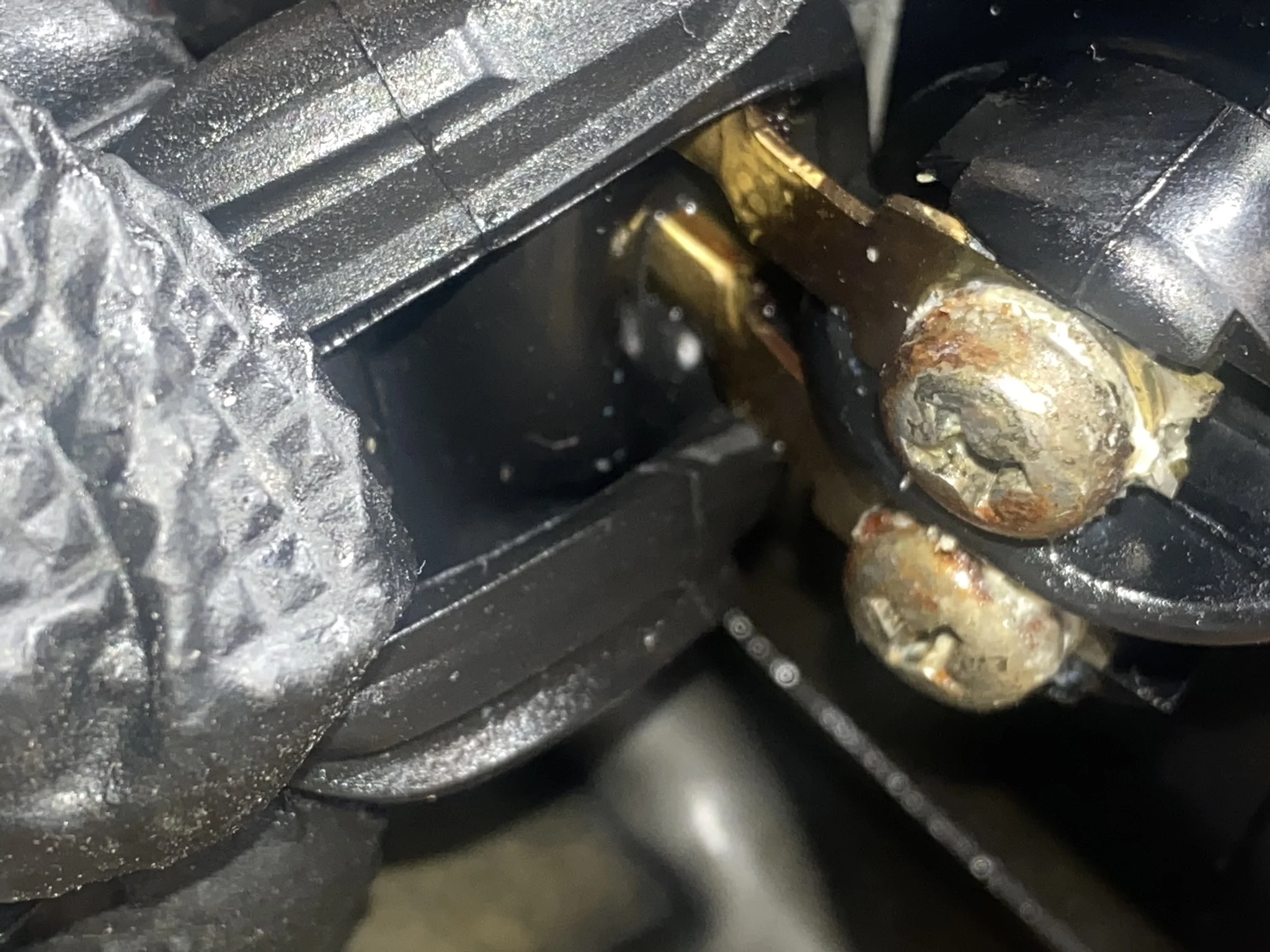

2020 pictures of ABS leads.
So this brake system, other than pressure alarms. Graded fairly well in 2020, and now. But I'll admit, I did recheck brake wires under boot. Since I knew hadn't had spillage or resevoir overfilled since I inspected in 2020.
Still I was 98% sure, issue was in the masters. Most likely internal leak or fault in ABS unit.

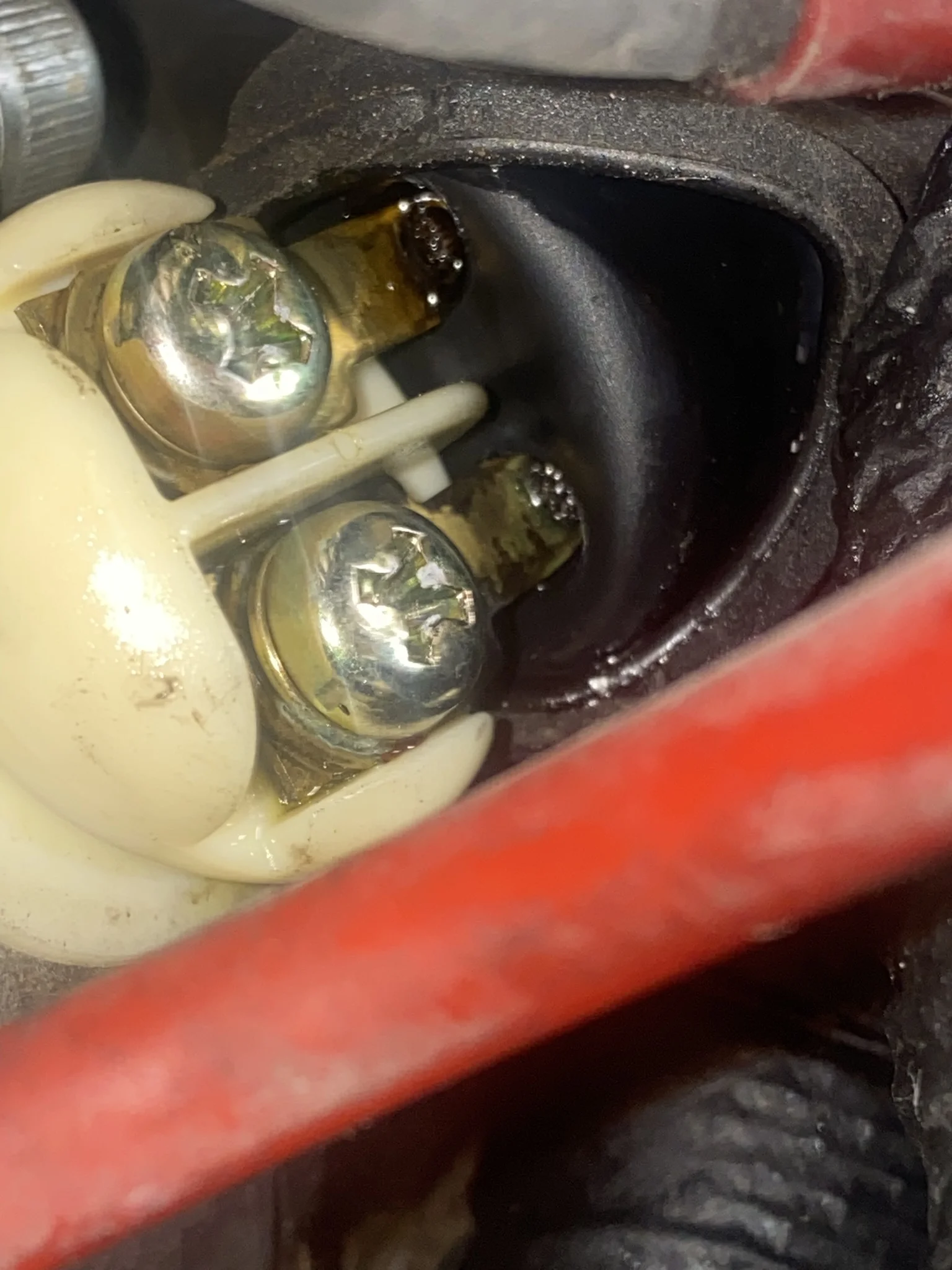

While replacing the brake master. I found the leak. It was, at the ABS unit.
Wet ABS, in 2025
Wet ABS side of wires, in 2025
wet motor side wire, in 2025.
New master problem solved.
Wet ABS, in 2025

This may, be a sign of a brake fluid leak
Post video in YouTube, then link here.
I agree that this looks like brake fluid weeping out of the ABS module…
As a secondary sign of confirmation, what do the other bolts look like that hold the ABS module together? Brake fluid would cause crusty surface corrosion as appears to have happened to this bolt. If all of the other ABS module cover bolts look to be in better shape than this bolt, I think that brake fluid leak is confirmed.
All clues need consideration. Even dust that has collected/stuck in/to area and not others.
Get phots from below and fender well below. Rinse, spray with degreaser and wash & dry. Get phots showing perfectly clean and dry. Watch! We usually find some wetness, starting near bottom, if ABS leak.
Make sure no wetness 360 degrees around reservoir. Some say, reservoir grommet leak. But, that I've never seen. What I do see very often. Is leak from cap, when overfilled.
Inside boot will normal get wet, but not always. Depends on how bad leak, for how long and where. These ABS unit leaks, usual get worse. They are a pressure loss. Resulting in pressure alarms. They'll eventually result in excessive long booster motor run times. Motor will then fail prematurely. Motor fail to run, no brake fluid pressure, little to no brakes.
I would agree, that master will need to be replaced in time. Mine started like that but quickly I noticed the whole master slightly damp on that side.
Video of the sound I was referencing ^
Front and underside where the ABS module meets. I wiped it off about a month ago, haven’t touched it since.
They all look to be similarly corroded, although that may be another wet spot starting at the bottom left
Open hood, and Video the brake reservoir, during sound event. Like seen in first video of OP of this thread.
I do not see leak in picture of brake master, you posted.

So no concerns about the brake performance - all in spec - but I am wondering if a new accumulator would a) reduce booster fill times and b) the number of presses to discharge the accumulator. If all the above is correct, it ought to.
This is more a theoretical question than a practical one, as the wise but $$$ course of action is to replace the whole dang thing when it starts to fail.
Thoughts?
(Supplementary info: Owned car 18 of 24 years, 350,000 kms, in my time always Toyota fluid flushed regularly & correctly filled to max level with accumulator discharged. Booster pump wire terminals spotlessly clean, zero corrosion. No alarms or braking issues. No master cylinder seagull noises. Brake reservoir is clean. New genuine T calipers F&R inc. bleed nipple covers. No evidence of any hydraulic fluid leak anywhere in the system.)
