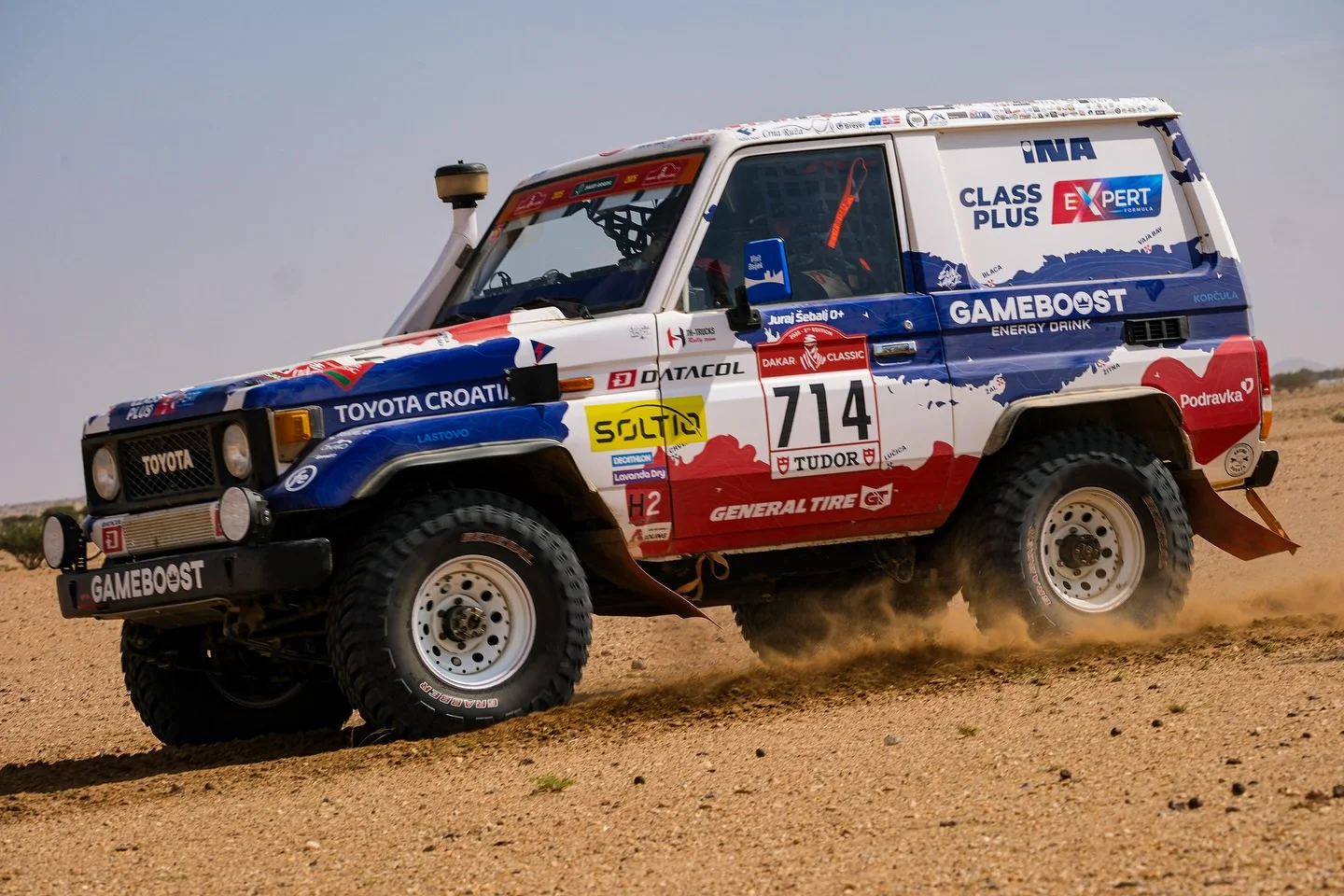

Gratuitous pic from 2025 Rally as an intro.

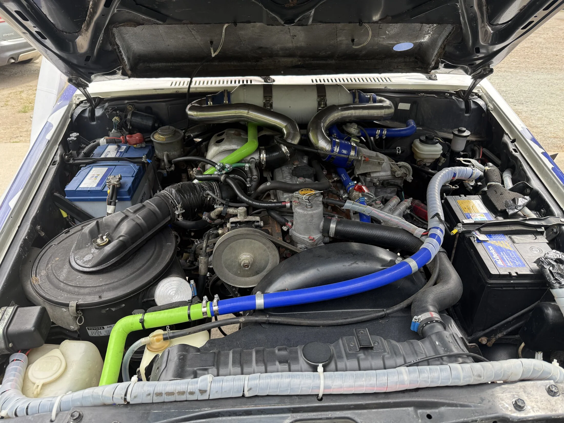

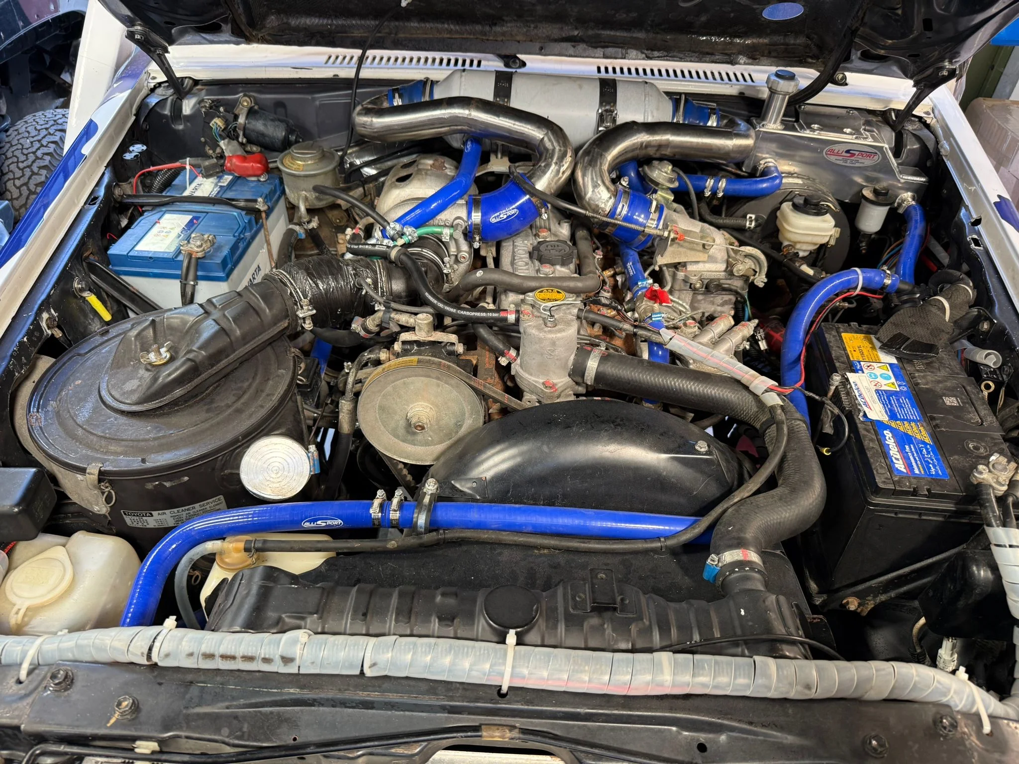

Would love to see more pictures of this cruiser! Any other mods to the engine?
Any engine pictures? Looks like the intercooler is sitting out front
Very cool build, hope we can help

The engjne was rebuilt with as many OE parts as possible, the turbo was modified to a hybrid using some elements from the 4.2TD 80 so it spins up very quickly and makes a bit more power from that. The chap I purchased it from had the intercooler fitted, it makes a big difference, sits on top of the engine at the back, the bonnet had to be cut out and a new carbon bulge has been fitted.
No other tuning on the motor, It makes more torque and about 170bhp. It pulls strongly right off tickover.
We are looking to make up some more progressive leafs and match them to the Oram remote reservoir rally shocks, we are fitting a new FIA spec roll cage and changing the wheels to the Braids, making some new internal wheel carriers and storage.

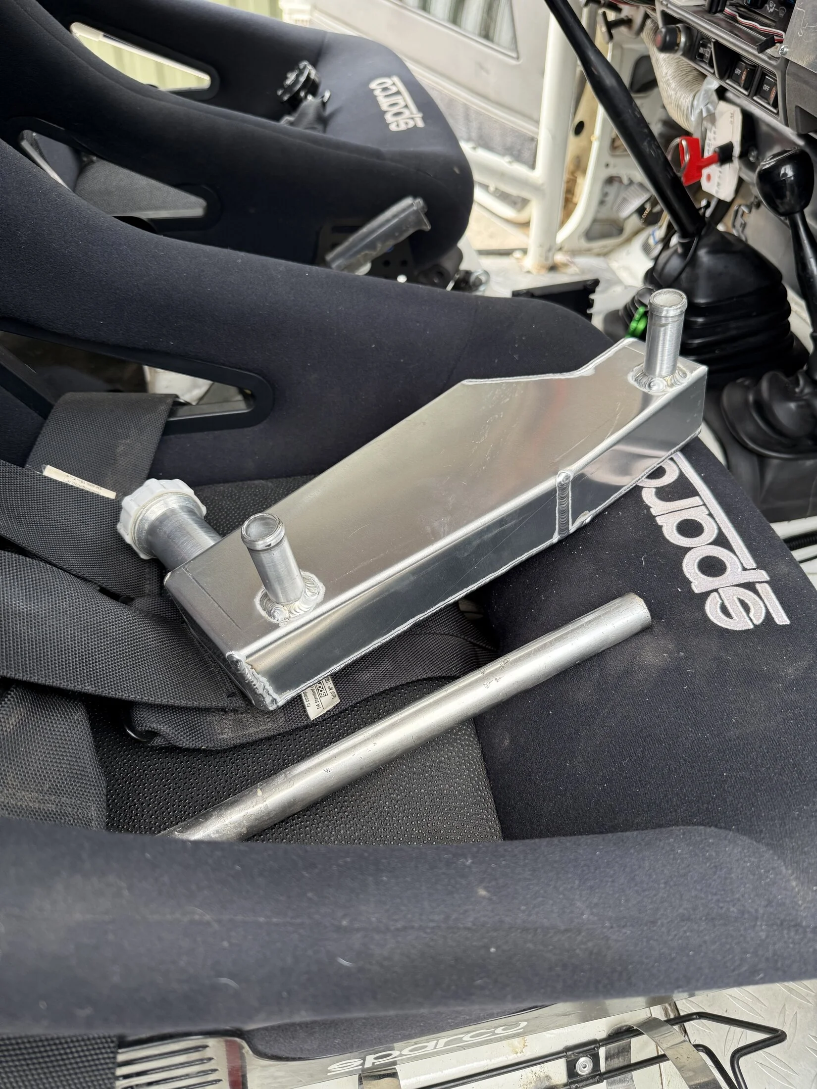

Currently tidying up the engine bay hoses and making a new intercooler header tank (my friend runs Allisport here in the UK and makes radiators/intercoolers/airboxes and stuff for motorsport and 4x4s and objected to the chequerplate tank!)

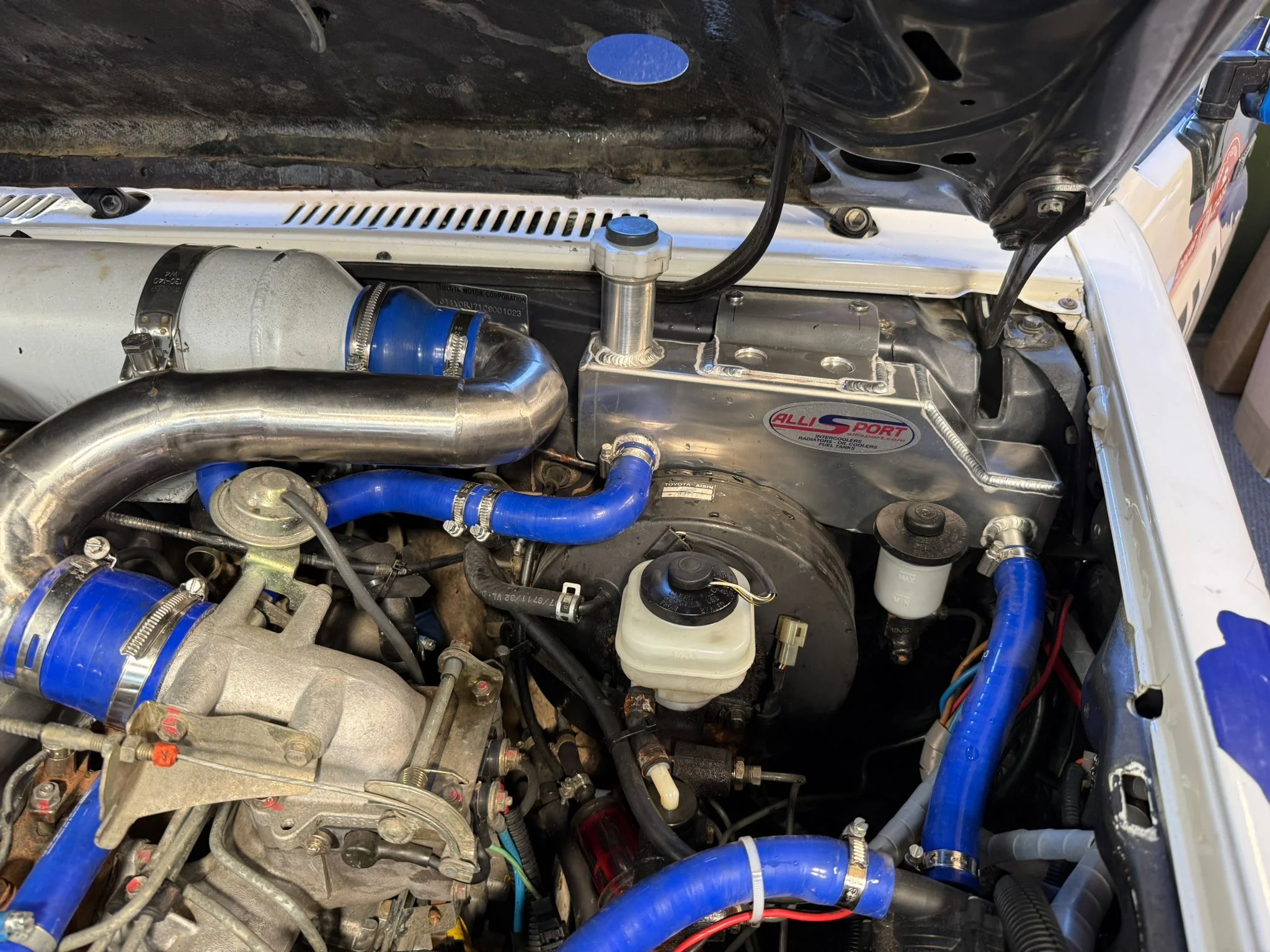

Changed headlights today for what we call an MoT to complete the import process. I took a couple a pic of the current bay and the progress on the new tank for the intercooler.
Not finished yet. The cooler uses an electric water pump.
We have some tidying up to do in the bay as mentioned.
