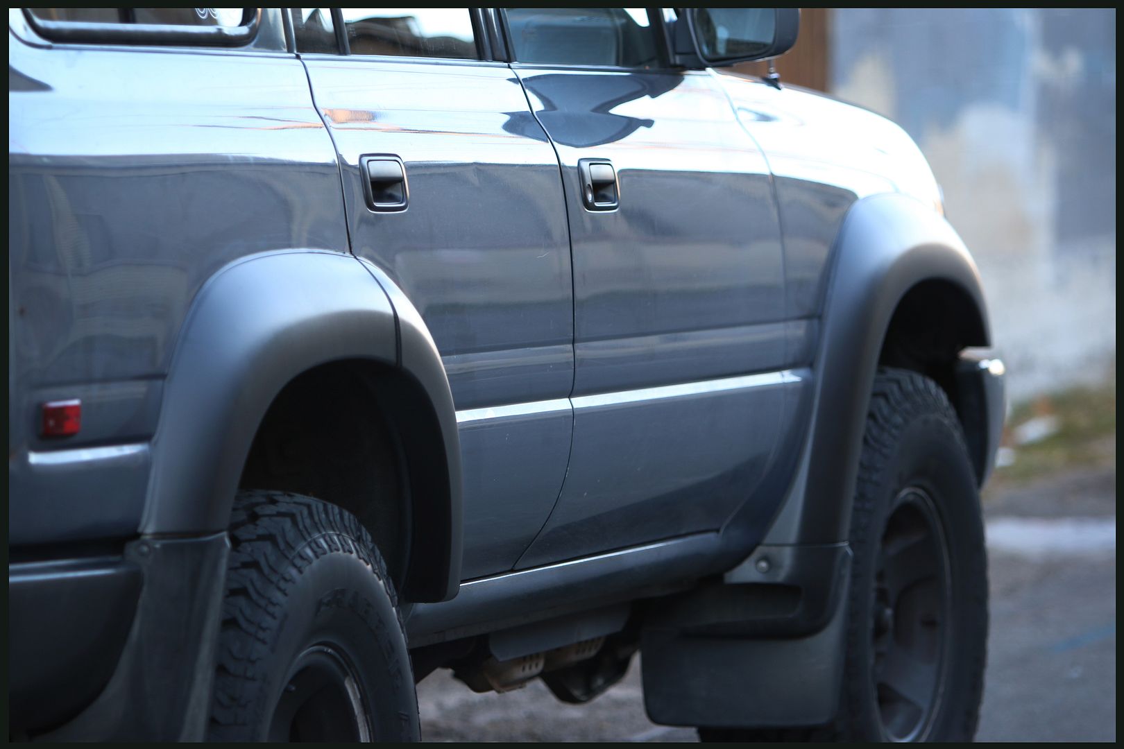

Was able to get a few pics this morning of the painted flares and a few other small things I've been able to address since getting it home on Saturday. The flares cleaned up nicely I think and look good with the black handles. There are a few interior shots too to show the seats. First off the flares.
Before:
After:
Before:
After:

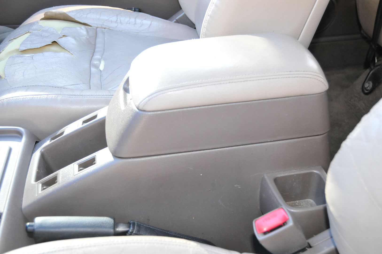

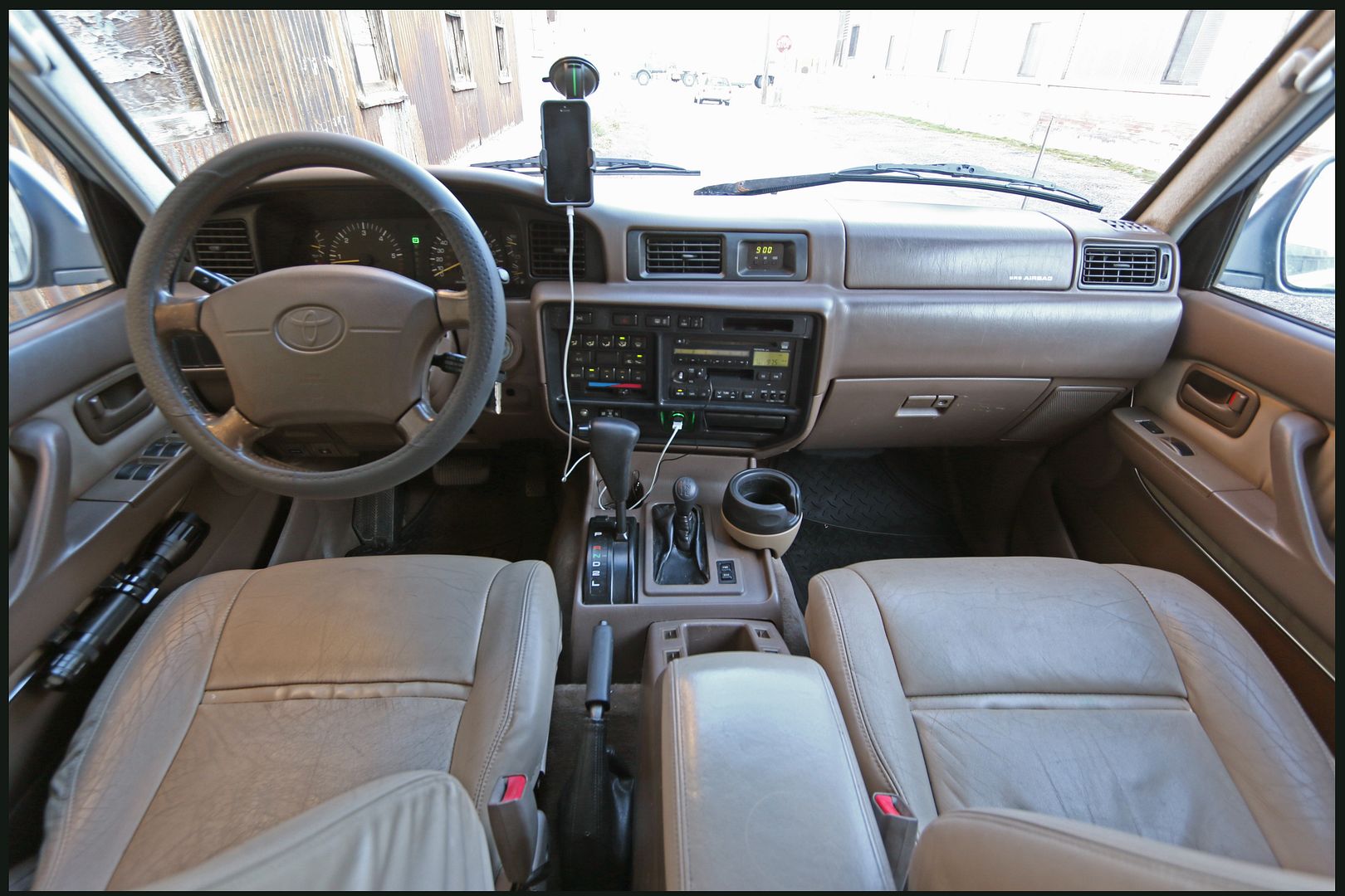

Now the seats. This is the only photo I have of the original seats. Both front seats were similar condition. The leather was torn and the foam was deteriorating badly.

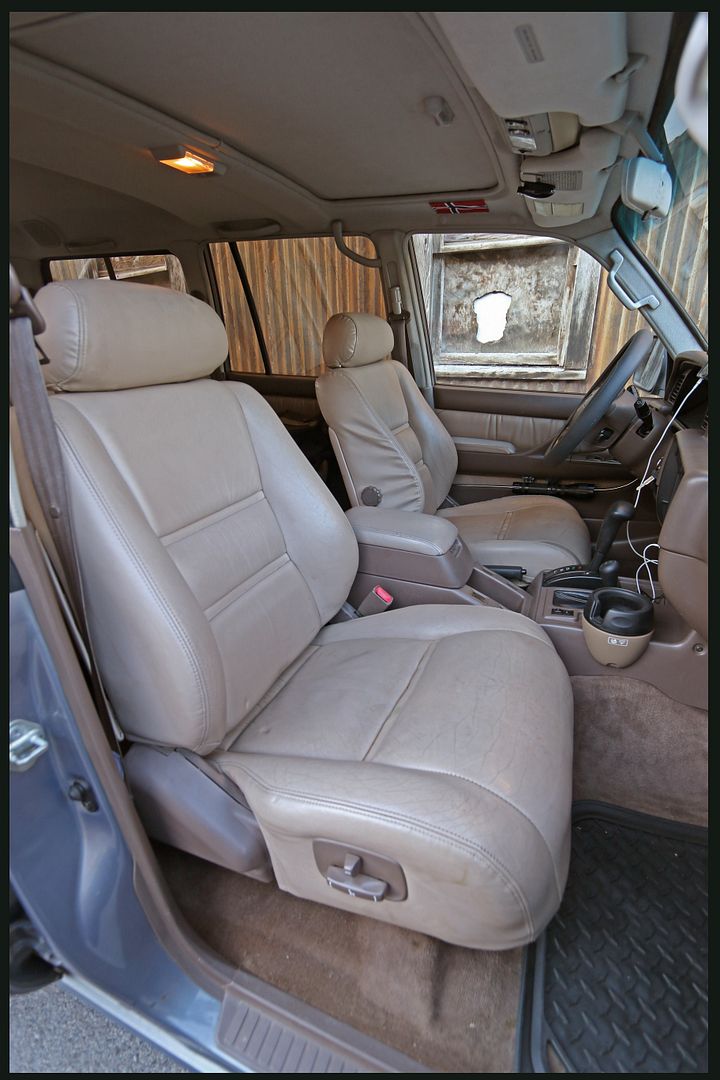

These are the seats I was able to replace them with. They came out of a '97. Like I said they are pretty dry right now, but I'll try to soften them up with some conditioner over the next few weeks. Power features work perfectly and they clean up the interior feel quite a bit.

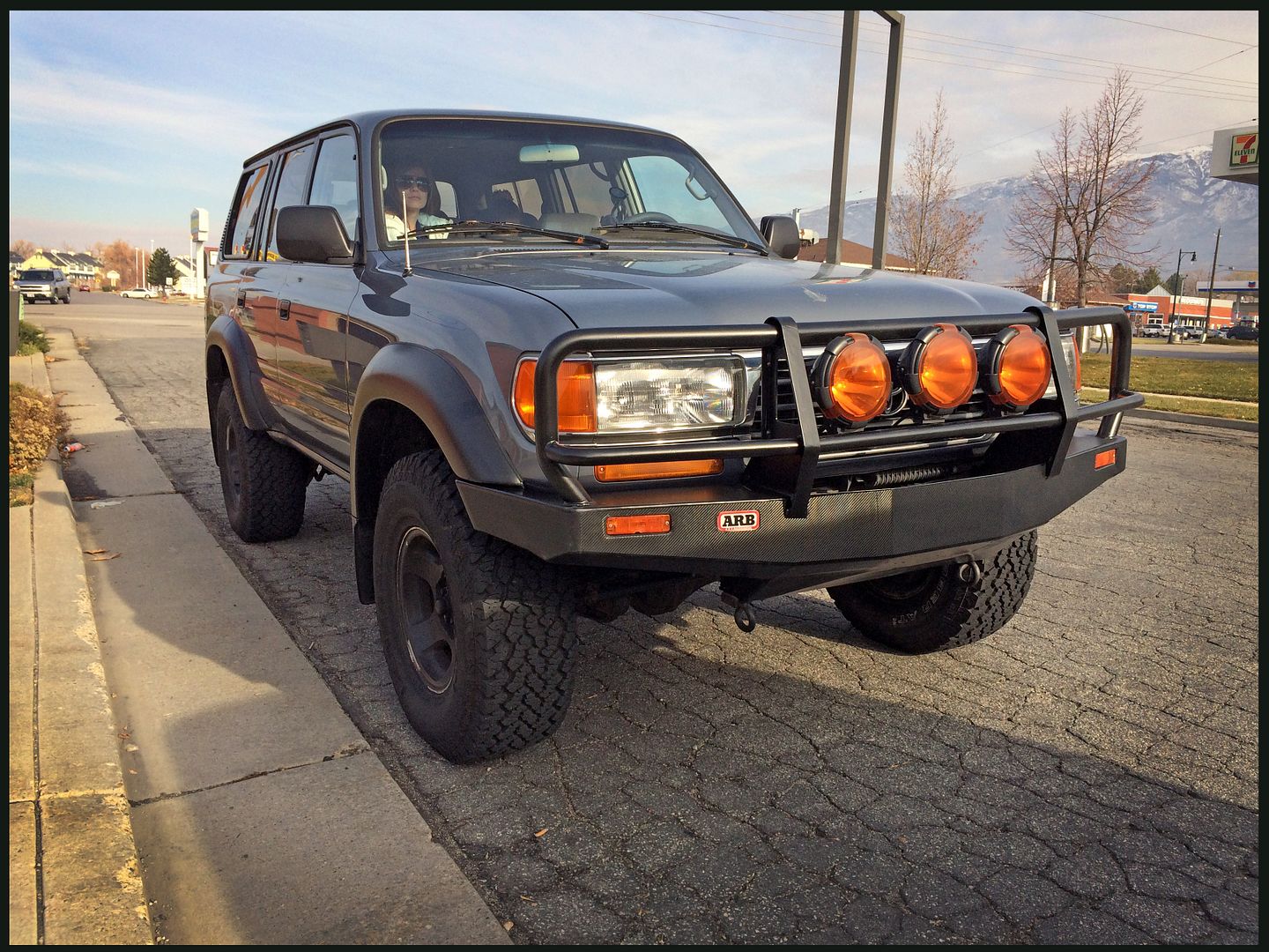

I did however, get the ARB bumper off my '93 last night. The bumper has definitely seen better days. For starters its a modified bumper with all the lower skirts cut off. All the winch brackets etc have been removed. I'll add a new winch mount when I get a winch for it but it will just use a Haws fairlead on the smooth face of the bumper since I plan to use synthetic rope. I like the better clearance it has. It's been well used on my '93 for more than a decade so it's got a couple of little dents and tweaks. Also since it's been sitting on the side of my house for a couple years the weather has been working on it and there were some rusty spots. I got it pulled off a couple nights ago and cleaned up. Sanded it down to bare steel and rattlecanned it with Rustoleum Satin since it has a finish that looks similar to the original powder coat. I got it mounted to the new truck this morning and moved over my HIDs from the Tacoma. It's starting to look a bit more like a real cruiser now.

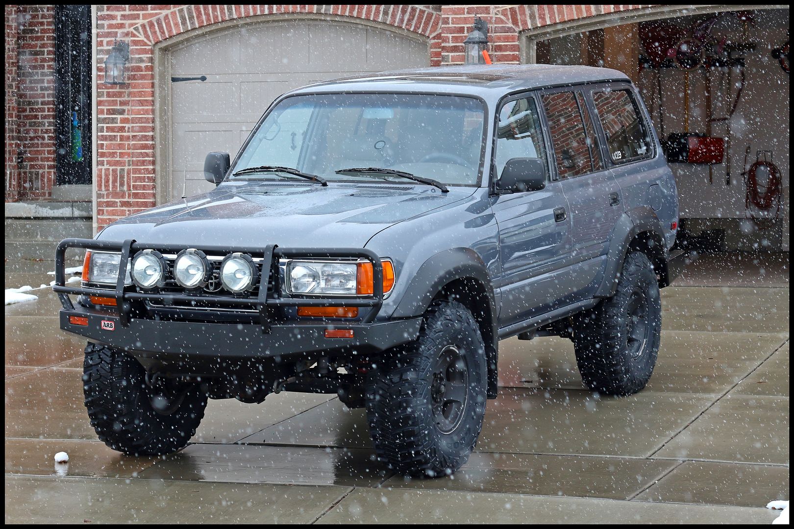

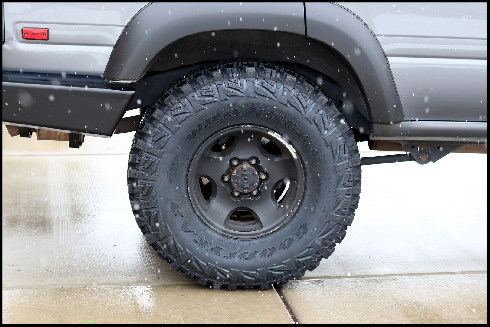

Here's some pics of the updates over the last few days. Some new 315s on the factory wheels. I'll be stripping and repainting the wheels in the next couple weeks just to get them cleaned up and looking nice. I also have a set of 1.5" spidertrax wheel spacers that will go on just to widen the stance a little.

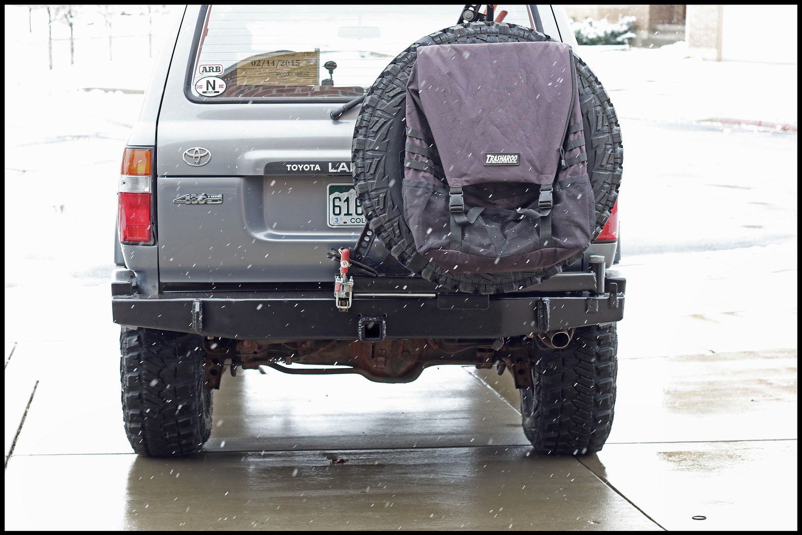

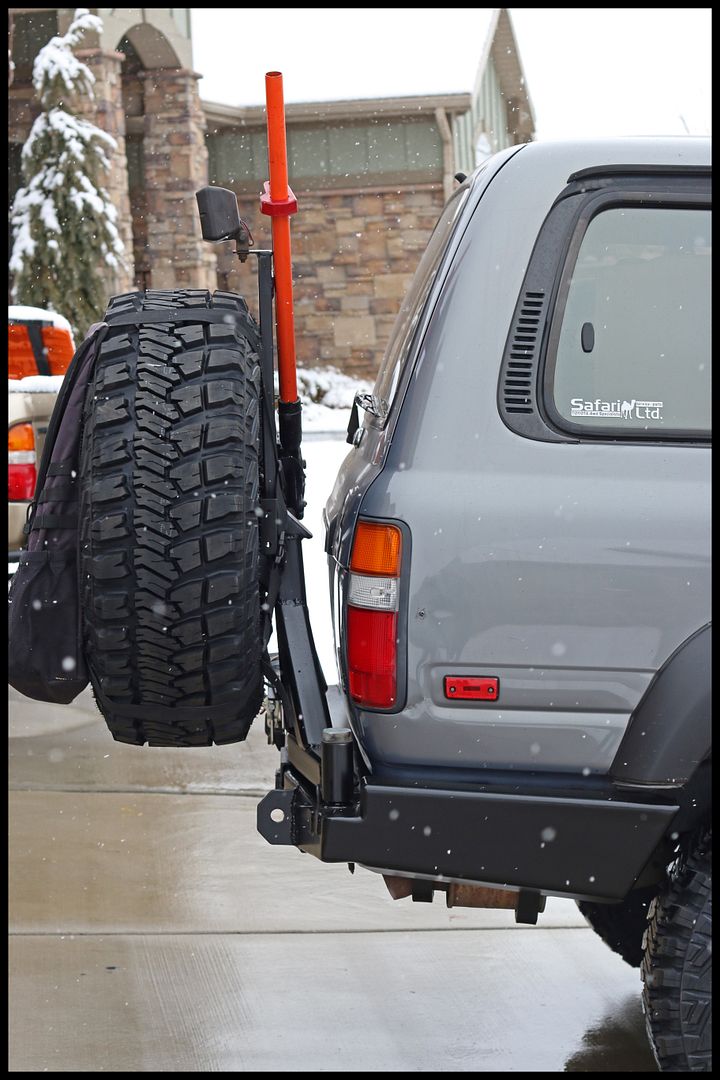

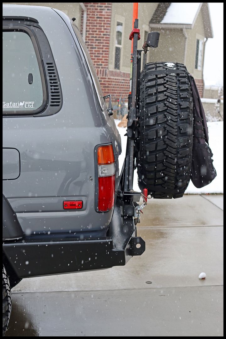

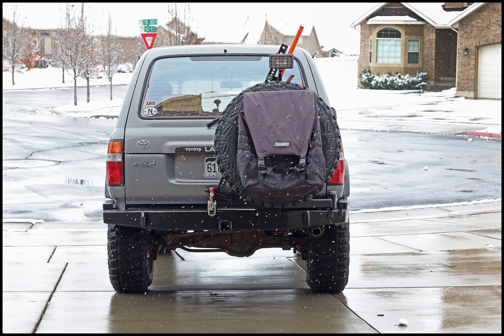

A few pics of the rear bumper. This thing took some elbow grease to get all cleaned up, but it turned out nice I think. I need to make final adjustment to the latch but it's all working well. This was a bumper kit designed by Wildyoats and there were about a dozen kits made a few years ago. I'm glad I got one of them while they were available. I really like the lines of the bumper and it works great.

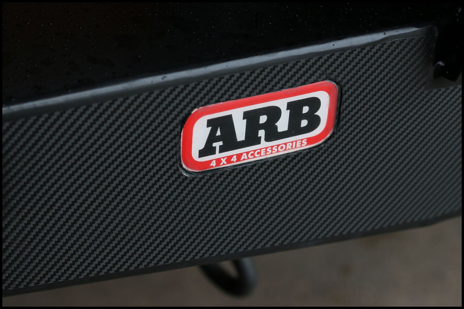

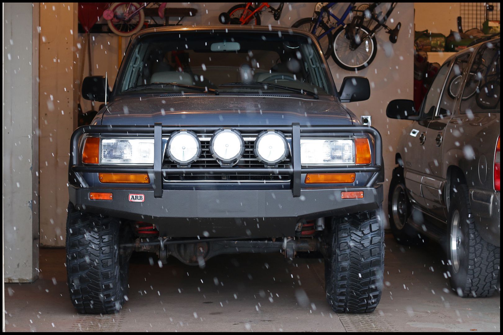

Finally a couple better photos of the ARB front bumper. This bumper is 15 years old and shows it. It took a lot of work to clean it up and there is a little pitting on the top surface, but it's still structurally sound. A winch will be added at some point but I like the clean front face and it will look nice with a haws fairlead.
The front of the bumper was tough to get totally smooth so I did what I could to get it close and then used some scraps of carbon fiber vinyl I had and laid it down across the front. Turned out pretty good I think.
