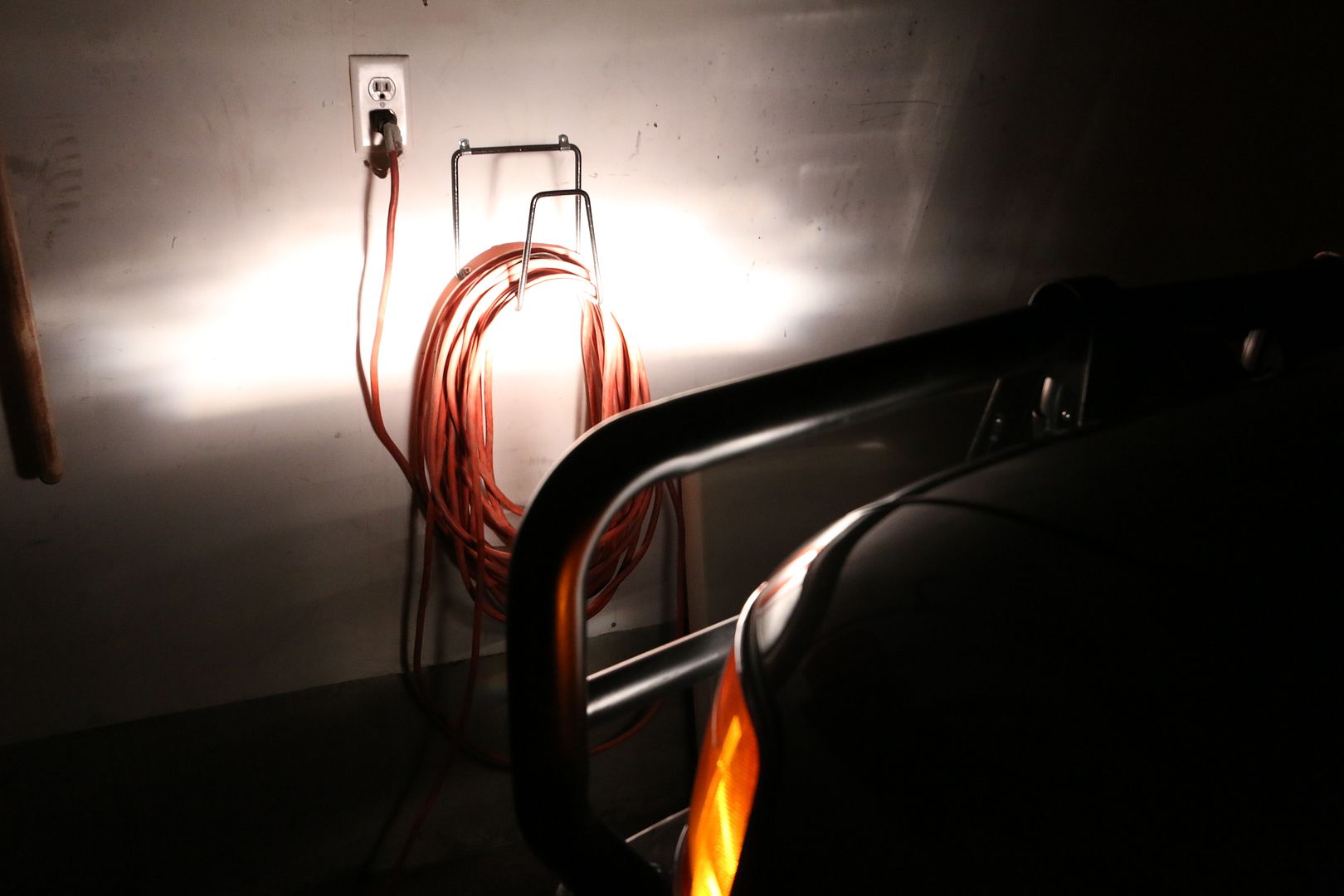

I have recently been reading about some LED headlight upgrades and I went ahead and ordered a set. Label says they are 2000 lumens and they're straight up plug-n-play so it won't get much simpler. Should make for a much brighter whiter headlight. They are CREE LEDs. I ordered them from ebay.

Some of us are still working at 9:30pm. :) I should have some time tonight to get them plugged in and I'll get some pics.

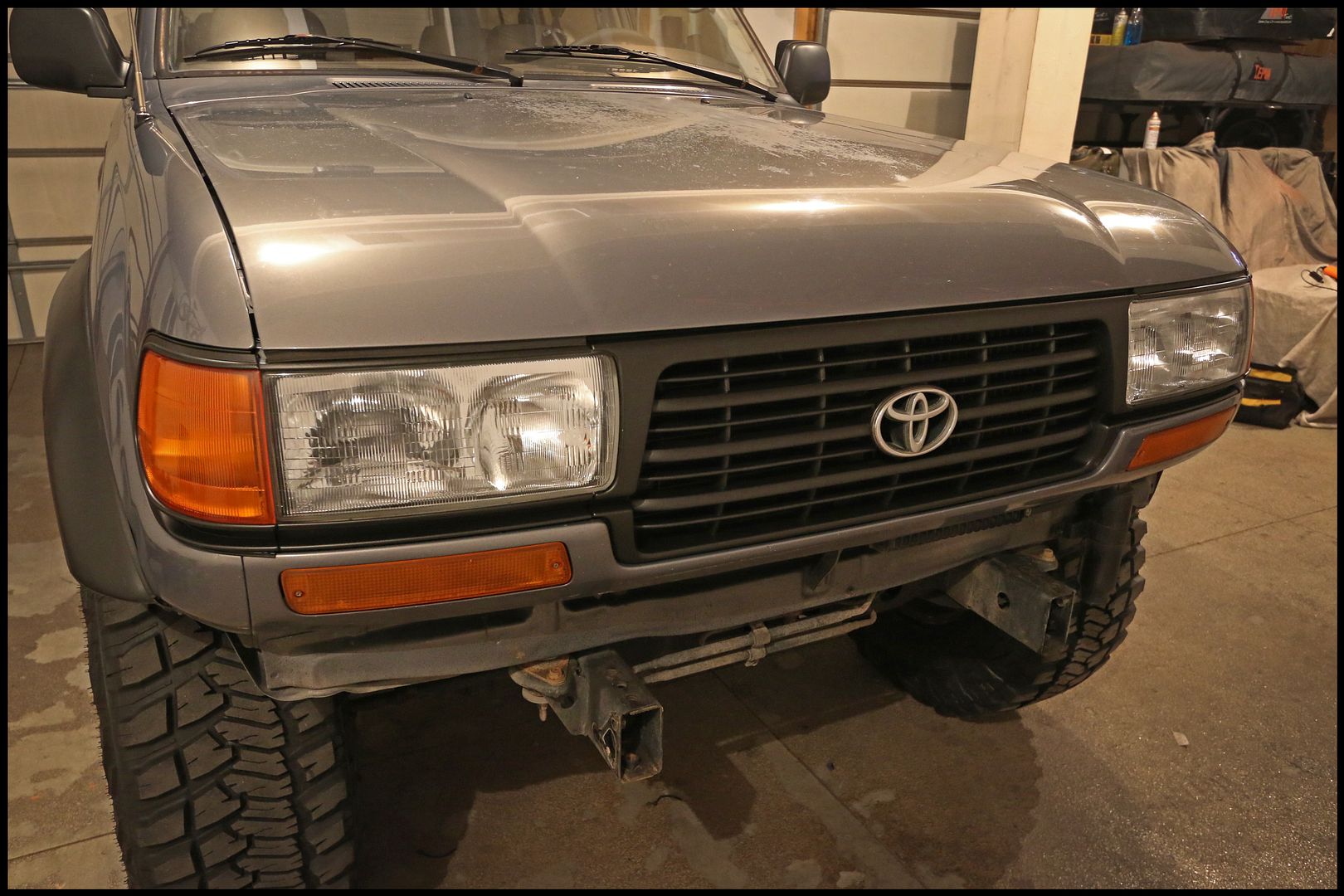

Really liked ur blacked out grill and trim, think that would look sweet on my white one, what was ur method used to remove the chrome plating, if at all?
Was planning on doin mine cuz it's staring to chip and flake and look awful,
Curious about the chrome trim around the corner lights, didn't think it was removable? Skinny masking tape to contour the corner then cover the rest of the lens to spray?

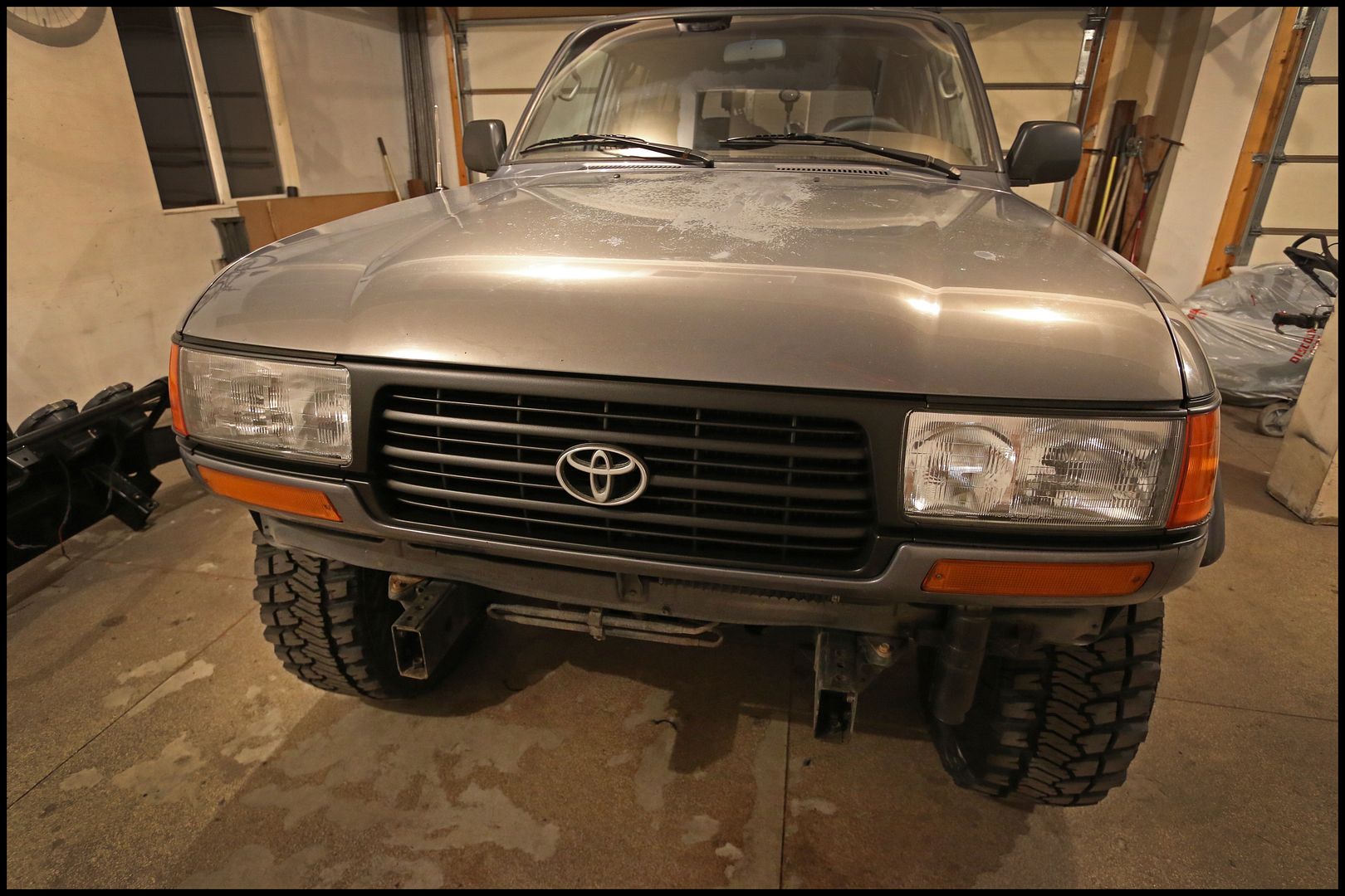

for the grill I went simple. On my old 80 I pulled the grill and sanded it down and painted it with Rustoleum satin black. It was time consuming but turned out pretty good. Over time the paint would still chip and need to be touched up. On my Tacoma I blacked out the grill using Plasti-Dip. It didn't require stripping the chrome or the time consuming sanding of the grill. The plasti-dip adheres well with just a good cleaning of the grill. the other nice thing about the plasti-dip is it is somewhat rubbery so it doesn't chip like the paint did. So it is much more durable to rock chips etc. I've had it on my Tacoma for over 3 years now with no touch-ups needed so I decided to use it on the 80.
If you haven't used plasti-dip before it is really cool how it works. You don't need to perfectly mask everything. Actually you want to mask things to allow roughly an inch or so of overspray. So I opened the hood and covered the radiator and core support, I masked the fenders and headlights but left about an inch of fender exposed around the grill and corner lights. Same thing with the headlights. I masked them but left about 3/4" of the headlight exposed. Then you want to spray several LIGHT coats of the plasti-dip, slowly building up the coverage. When you have everything covered well you can remove all your masking tape. You'll see how the plasti-dip starts to pull away around the masked edge. Use your finger and rub the edge of the plasti-dip like you would to remove rubber cement. Then when you can grab the edge of the plasti-dip on the overspray on the fender or light just start pulling it. It will tear on it's own right along any seams leaving a clean finished edge. So the seam of the fender/corner light will tear as you peel the overspray off the fender and leave a perfect edge on the painted corner light. Repeat for the overspray on the lights. Viola!

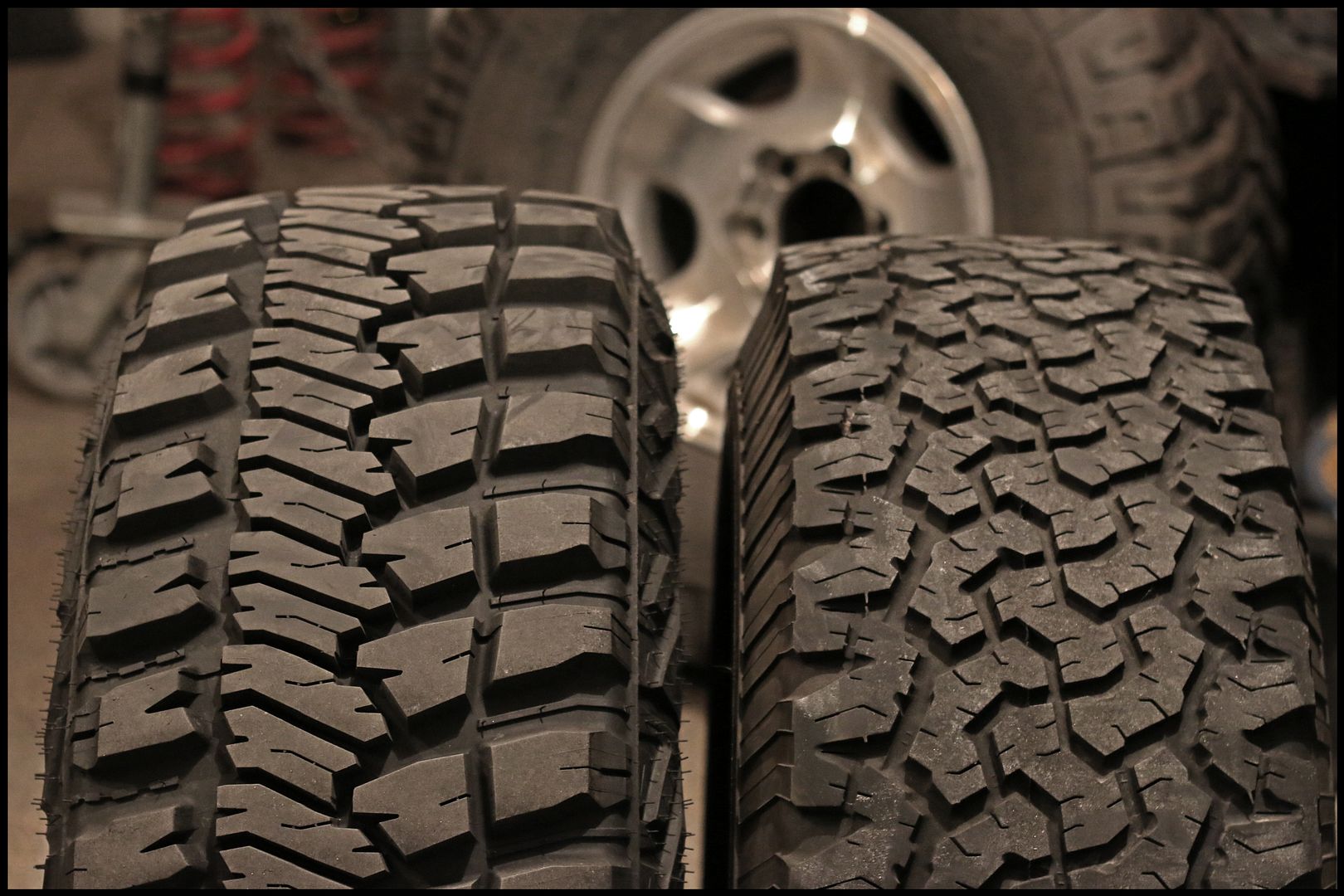

In case anyone is curious my Goodyear MTRs are about an inch larger diameter than the used BFG ATs that have been on my old cruiser. Both are 315s.

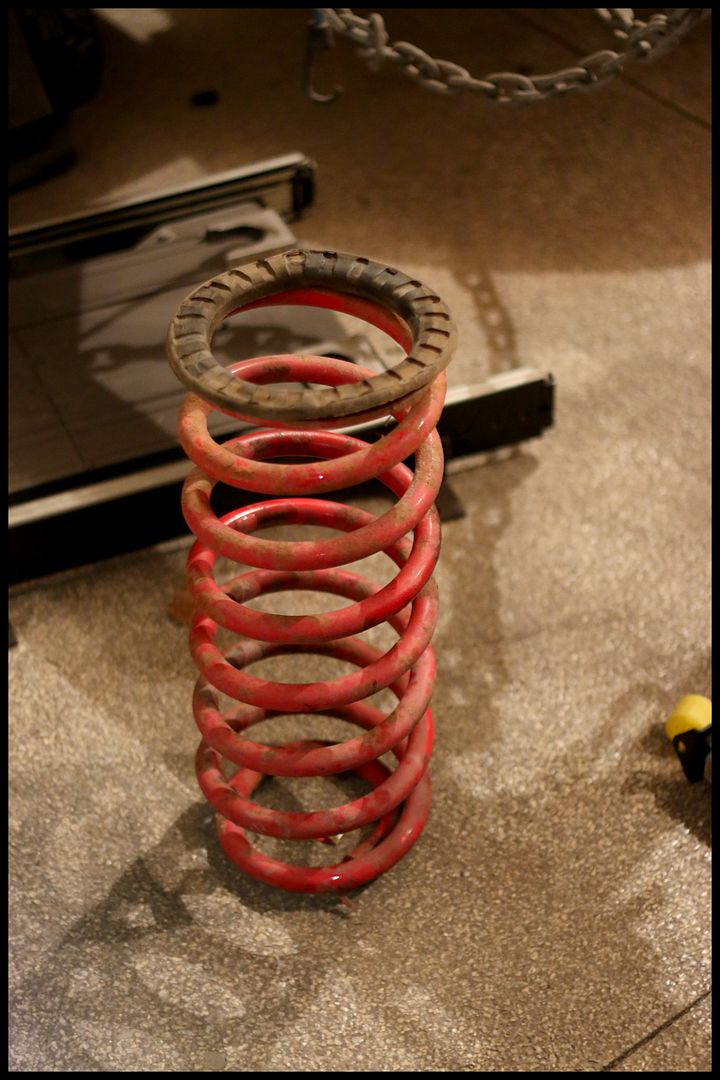

Skyjacker 2.5" lift coil

Here's the comparison of the OME J spring and 2" spacer next to the 2.5" Skyjacker coil.

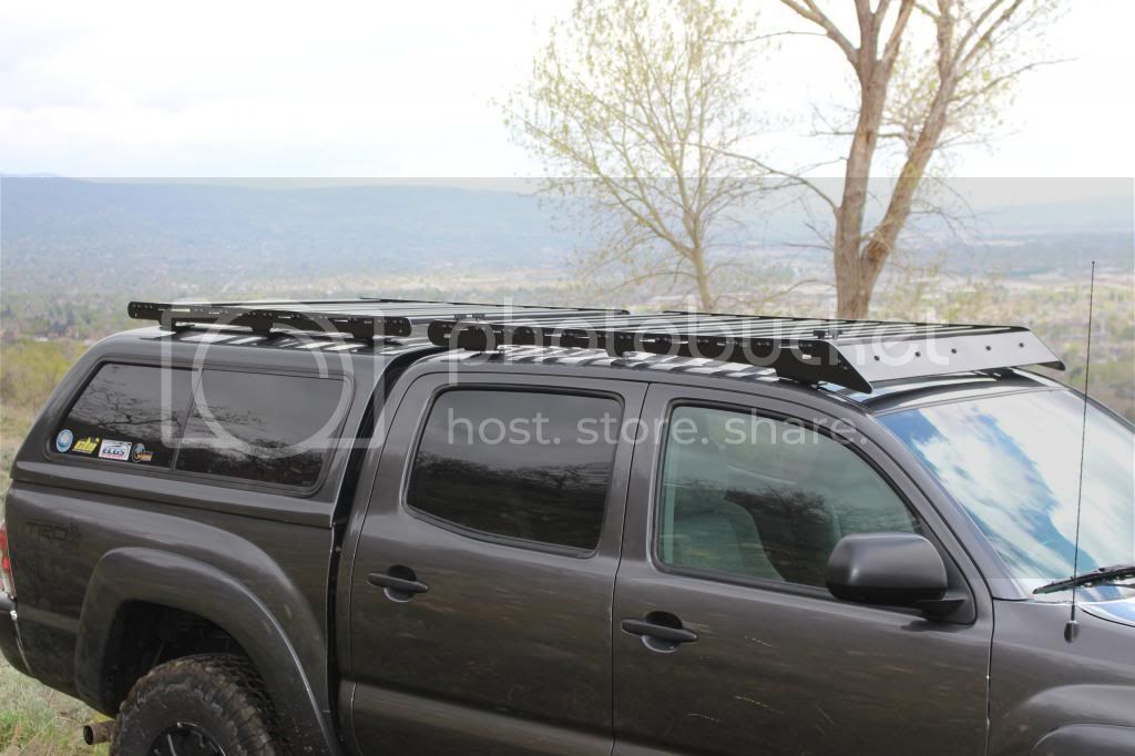

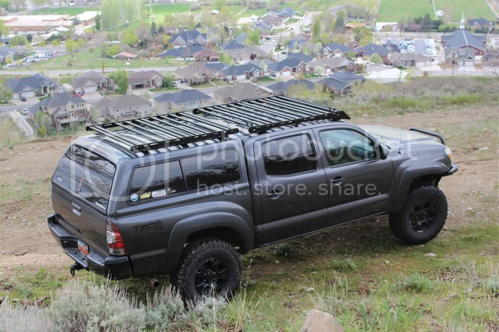

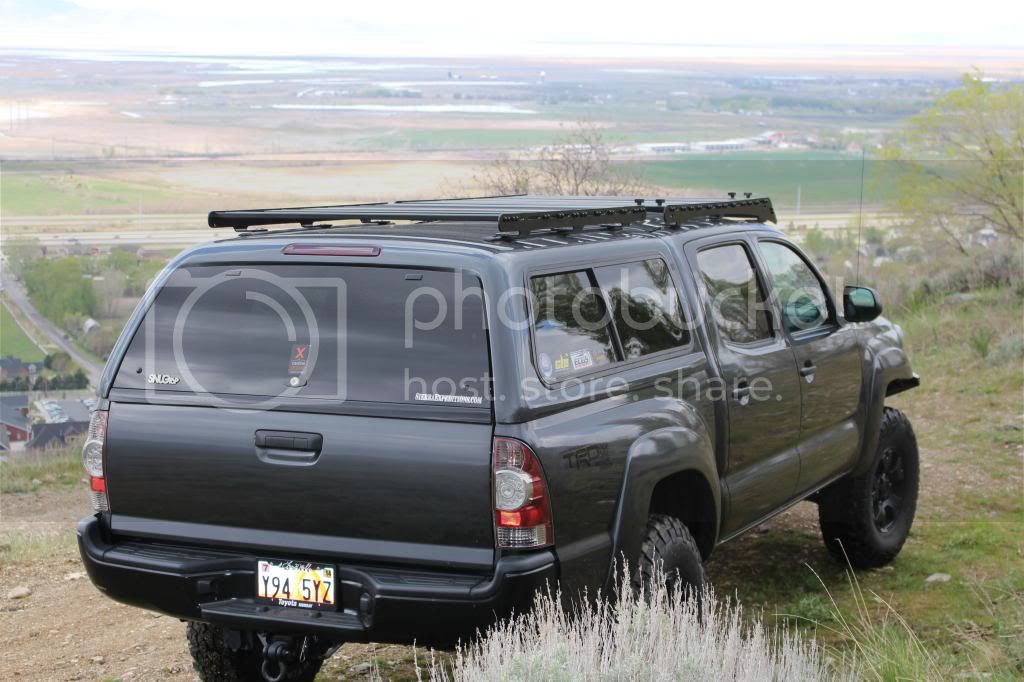

Last night Zach Scott from PrInSu Designs came over to measure it for one of his roof racks. He's been primarily focused on Tacomas and FJ Cruisers so this will be the first rack for a 80 series. I really like the design of his racks. All aluminum, low profile, very sturdy with good lines. One thing that will be great about it is the side rails will not have individual feet but a rail that runs the entire length of the gutter so the load will be spread out well and the load capacity should be outstanding. I think it will be the best looking rack option of 80 series cruisers on the market. He should have a prototype worked up to test fitment in a couple weeks and then the final version will be built.
Here's a photo of one of his Tacoma racks. This is actually two racks, one on the truck and one on the camper. But should give you an idea of the basic look of the one for the cruiser.

Damn that has to be the best looking rack i have ever seen...on a truck!
Yep it's good looking. We test fit the prototype on the cruiser this past Saturday. Made a couple tweaks and it should be ready to install in the next 2-3 weeks. It's going to be really nice.
I am impressed by this as well. So are these going to be available to the rest of us and if so is there a estimated price? Just got a 92 few weeks ago, have one stubborn screw left to remove the factory rack and have yet to find a rack I want to replace it with to house my future RRT.
Yes the plan is to make them available for sale. One caveat that should be noted if the design is the same is mine will be then you'll be required to remove the factory luggage rack. I wanted a rack that was as low profile as possible and fortunately my cruiser never had the factory rack so I didn't need to remove it. Zach (who is building them) has discussed building two versions so there could be one that would still work with the factory rack. I'm not sure what the final decision on that will be.
One of the features I like most about it is the rails run the full length of the gutter so the load is spread over the entire length of the roof rather than at just a few points with multiple feet like many other racks. This should make for an incredible load capacity, although I don't intend to carry a lot of weight up there. Mainly just a RTT. Regardless the rack will be very strong.

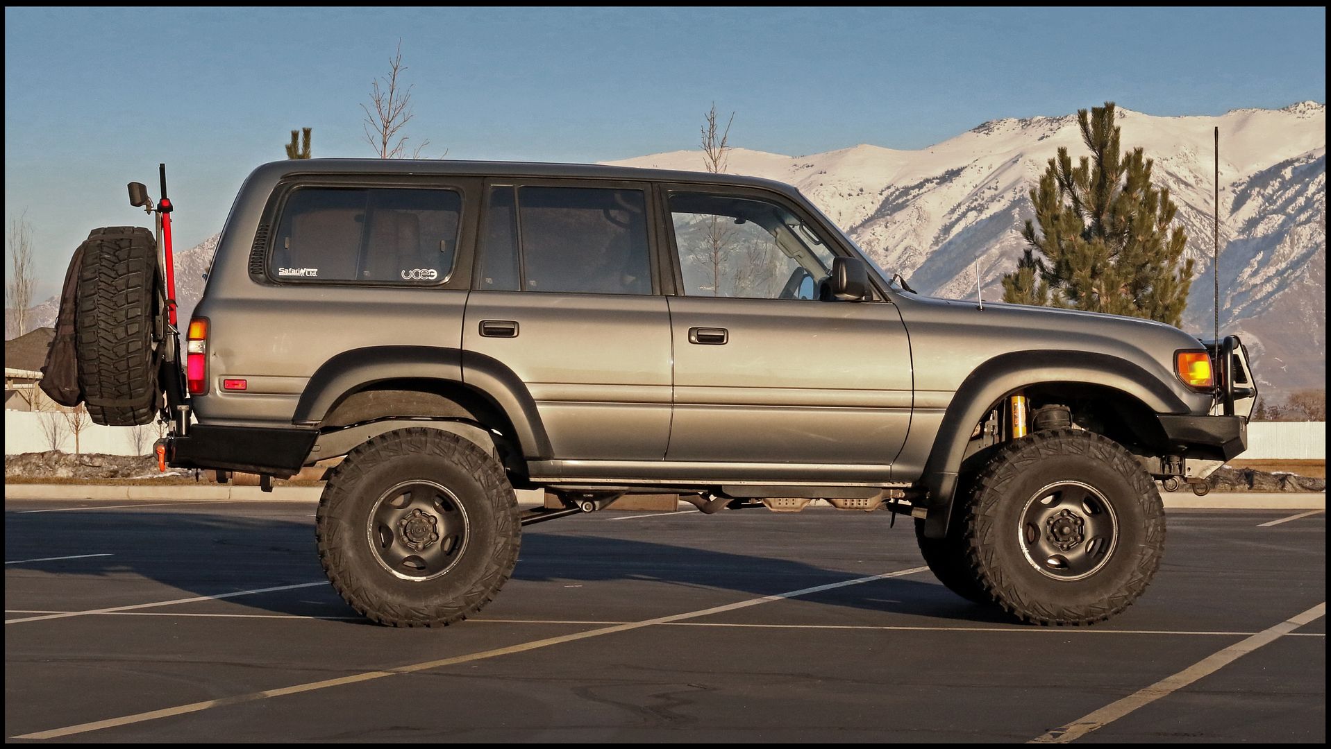

Before:
After:
