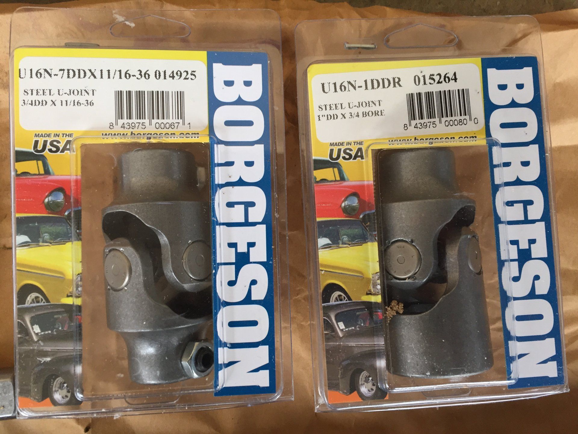

I’ve read several different things saying to not weld the borgeson steering U-joint to the steering column and others that say just weld it.
I’m using the 3/4” bore ujoint and it doesn’t come with a provision to pin it. I’ve also read just to weld slow and let cool and keep a wet cloth on the u joint to prevent damage.
Need the collective thoughts on MUD. Thanks!
View attachment 1699723 View attachment 1699724
I have the joint like the one on the left in your pic. It has adjustment screws on both ends so I had to grind a flat on the column shaft for it to slide over then I tightened with the screws. For the other style I would probably run 2 or 3 short beads cooling in between with water immediately to not melt the bearings. If u weld it on though, how do u get the column out if u need to pull it for some reason? In my experience the more permanent I make something so that it's difficult to service, it seems like said part for some reason I find myself servicing in the near future and upset I made it so difficult.

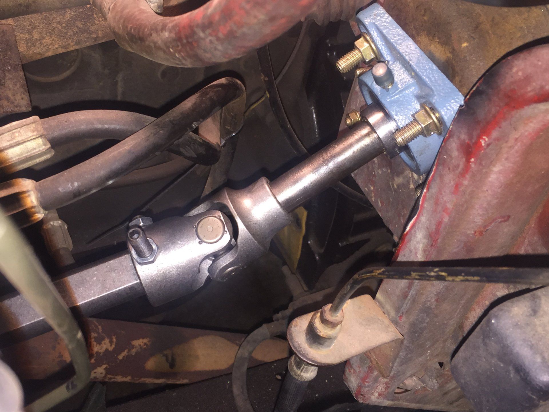

I just finished a P/S conversion and I ran into the same problem, albeit with the older style steering column. I ended up ordering the same style joint but with set screws on both ends so I didn't have to weld it on, and like White Stripe said it can be easily removed for any servicing that needs to be done. Hope it helps, good luck.
@moonshadow and @White Stripe ...guess I’ll order the right borgeson joint to be safe. Did you guys do the double D and shape the column or just rely on the set screw? Seems like a screw would have the chance to sheer.

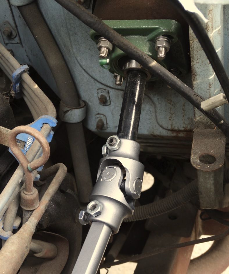

You need a different universal joint. When I did mine I picked up a universal with DD on both ends. After cutting off the rag joint end I ground flats onto the steering column shaft and slid on the universal.

I did use the DD joint and ground the two flats to match on the steering shaft. Slow and sure though, you don't want to take off too much and have it be sloppy. Then you can drill a through hole for the set screw.
