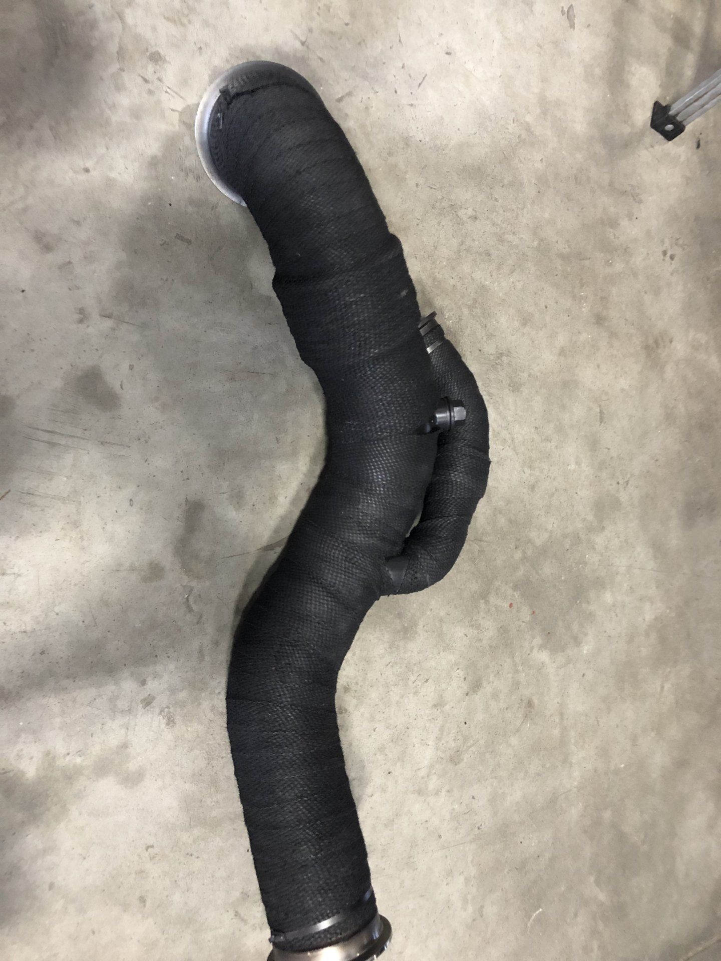

@NLXTACY - I'm preparing for the turbo install - do you suggest a tape type turbo down-pipe wrap like this for your kit? Do you have any concerns about the wrap pre-maturely cracking the down-pipe?
titanium wrap is newer than the stuff I used on my 68 Camaro so I can’t say specifically but in my experience wrap tends to hold in moisture. It’s likely a small issue if you live in drier climates. I know @Briano is using it on his truck now.
FWIW I have a downpipe blanket being developed now.

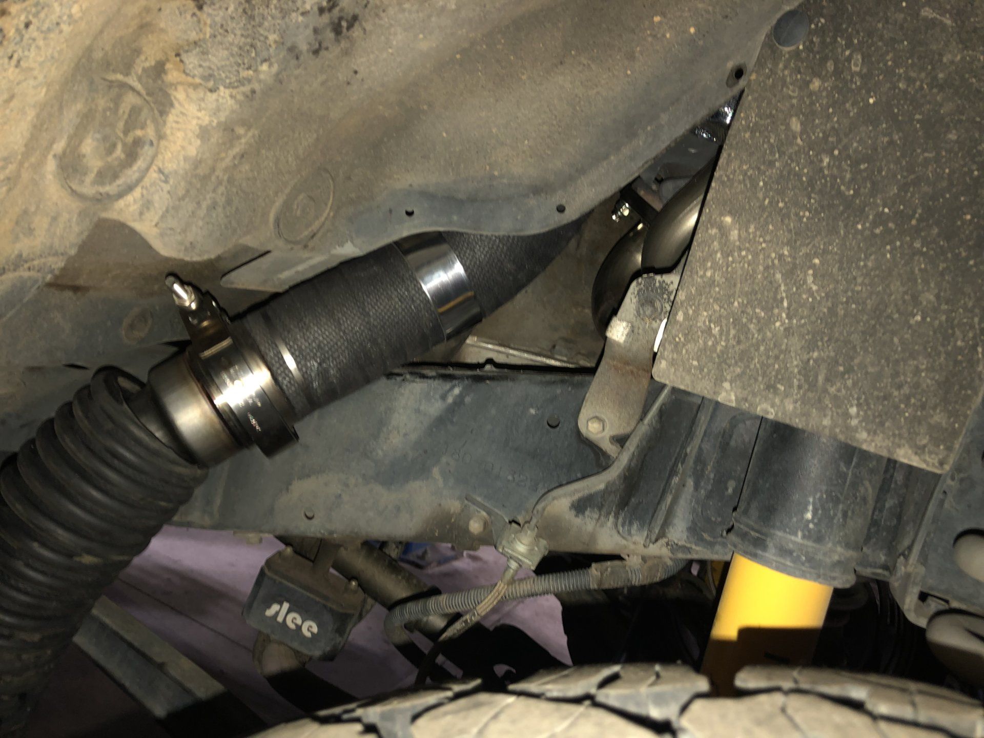

I wrapped mine, along with the short connector I had made, I’m not all that worried about moisture, I live in Colorado and don’t do much winter driving in my 80!
As a side note, anyone on the fence should go for it, this is the single best improvement I’ve made to my 80!
