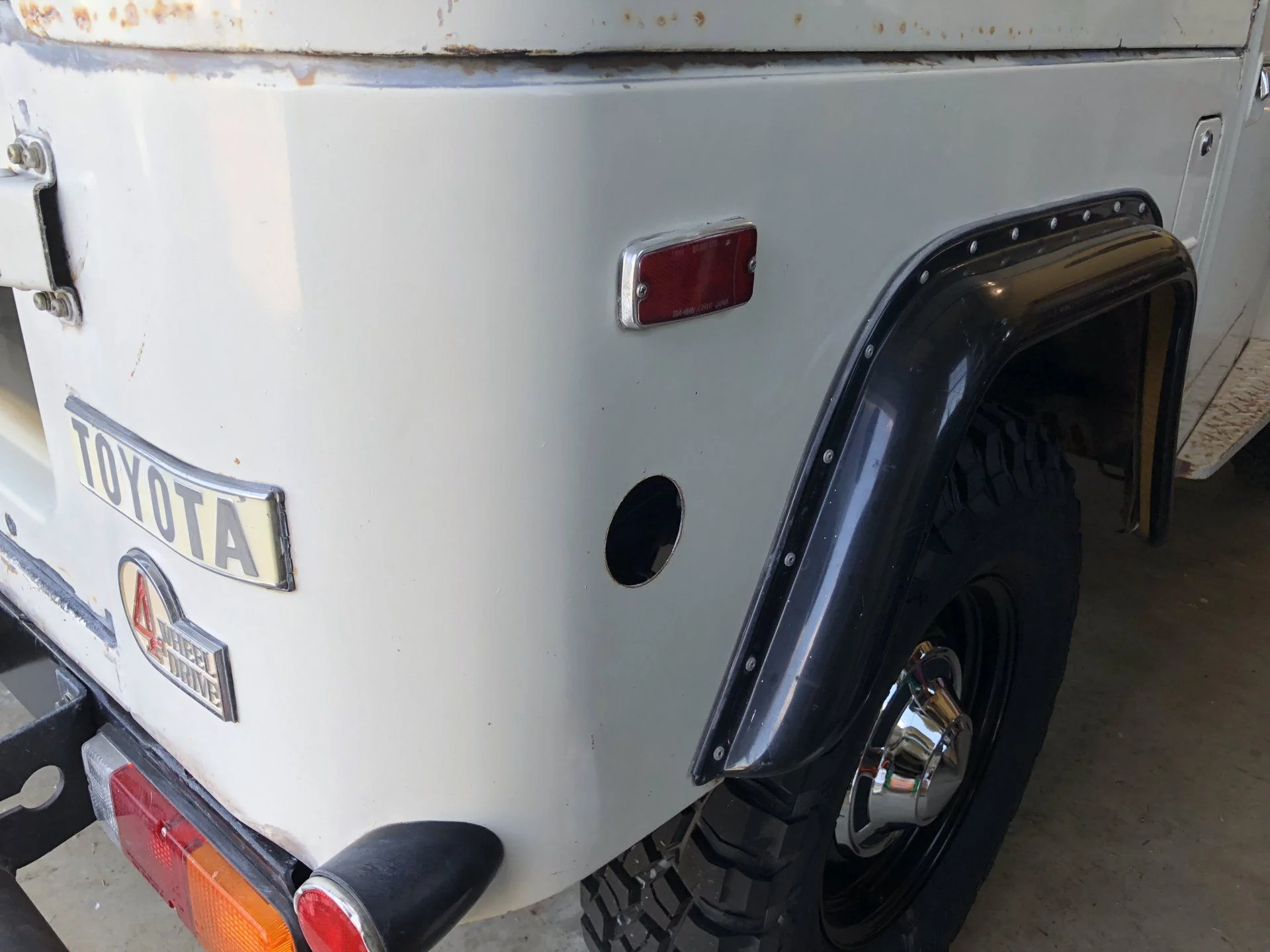

Bodywork/patch panels - opinions on what’s salvageable
b0ffe77d-cdb1-4849-a2d3-67eb1ccc24c6-jpeg.1778345
I'm not sure about that big ass hole there though. I would weld a patch in there for sure.
As far as your rear sill and quarters, I wouldn't cut em out.
Clean them up a little on the inside and spray them down with some kind of rust converter, top coat it, and keep up on it. Mine was trashed when I worked on it. Yours doesn't look bad at all. I wouldn't go off the deep end yet.
Clean it and treat it.
This is 100% the direction I'm leaning - with all four doors and the hard top pretty rotten, plus the infant, I strongly suspect any work on the back end of this tub is 4-5 years out at a minimum. My big concern right now is that Real Steel Cruisers is "for sale," so I'm debating if I should start stockpiling sheet metal. Seems like we lost a 40-series component vendor almost ever year :cry:
@Awl_TEQ for the sill, you won't be disappointed.
I was just looking at his work on his storefront. His sills are a work of art, and absolutely priced right. I wonder how badly shipping from Alberta would break the bank.
Keep in mind when I did my tub it was upside down on sawhorses, sandblasted, primed, rust cut out, new metal welded in. After 2-3 coats of epoxy primer on the underside, 2 coats of paint, I used SEM seam sealer on every seam underneath, then I lathered Monstaliner on the entire underside of the tub. I tried to cover every seam underneath the body that I could as good as I could. The inside of the tub I didn't seal as much, I wanted moisture to be able to evaporate from in between seams.
This is exactly the approach I'm planning on someday. I always set out to have this truck be a "rolling refurb" moreso than a concourse restoration. I'll probably wind up painting it in sections (top and doors, fenders and bib, etc.). Then, when everything else is done, I'll yank the tub and basically do just what you did. My problem is, with the absurd timeline of this build (mostly due to the snails pace I work at) I want to make sure the sheet metal is there when I need it!
This truck came with one of the "bolt-thru-floor" craptacular departure angle aux tanks that a PO had started installing, but never finished. The exhaust shop who routed my exhaust didn't listen to me, so now I couldn't remount it if I wanted to (and I don't) so this hole will definitely get patched.
As far as I can tell (I haven't put a ruler to it) I should just be able to cut a patch of flat 16 gauge and plug it, I believe that section of the panel is pretty flat. Naturally, if I also end up cutting out the rear corners to replace the sill, I'd be time/money ahead just buying a new quarter panel and using that. Hence the dilemma...
Perfection is the enemy of good..... In hindsight, I could have saved most of our quarters and used a wheel well patch. It would have saved a huge headache with first shop too.
Looks like your tub is solid. It would probably be a good idea to get some hardtop parts and weatherstripping while they are still available(and while Avery is still kind if inexpensive).
My advice on the sill... You really want to make sure that's not through rust. I would use a wire wheel on an angle grinder and hit every area on your rig where there is bubbling in the paint. You will learn how bad each spot is really quickly.
Not to freak you out, but on my rig, I was really surprised how the tiniest little paint bubble turned into an area I had to patch.
Be especially skeptical of any area where two panels overlap. The last place you'll see rust is on the outside in those cases.
As for welding and grinding... A few things i learned on my rig....
1) be super patient. Do not overheat your panels. Tack in one spot, move over 6 inches or more, tack another spot, and stop ever so often and hit everything with compressed air. It may feel like it's going slow, but if you badly warp a panel, it's going to cost you way more time. damhik.
1a) I hate grinding. And it's extremely tedious. You can easily overheat your panels while grinding. Move around a lot, never focus in one area. Again compressed air is your friend.
1b) they get some hate, but I much prefer flap wheels to grinding wheels. They work faster, throw off less dust, and leave a smoother surface. The downside is that they create lots of heat. Refer to 1a above.
1c) be super careful when you weld the patches on your front doors. I warped the bajesus out of mine and it ended up creating days of extra work for me. Be especially cautious on big flat areas of your panels. For the doors, I wish I had removed some of the material on the outer skin patch to make it into a horse shoe shape before welding them in (ie. Like the inner patches look). Welding closer to creases in the panels reduces the chance of warping since the panels are stronger in those areas.
2) know when to buy good used parts rather than sinking tons of time into parts that will be hard to fix. My rear quarters were a good example of this. I ended up spending lots of time patching, trying to fix prior body damage, only for it to not turn out right. In the end, I replaced them. Same with my front fenders. You can always sell your old panels... Somebody else might want to save them. I guess it depends on your personal time vs. money math.
3) wear a good P100 respirator while grinding. I didn't at first, and after lots of grinding, my lungs really felt irritated. I now find myself coughing a lot more than I used to. Kind of scary. The car shows on TV rarely show people wearing masks... Don't mimic them. The grinding wheels through off a lot on sandy dust... Silicosis isn't a joke.
Good luck!
