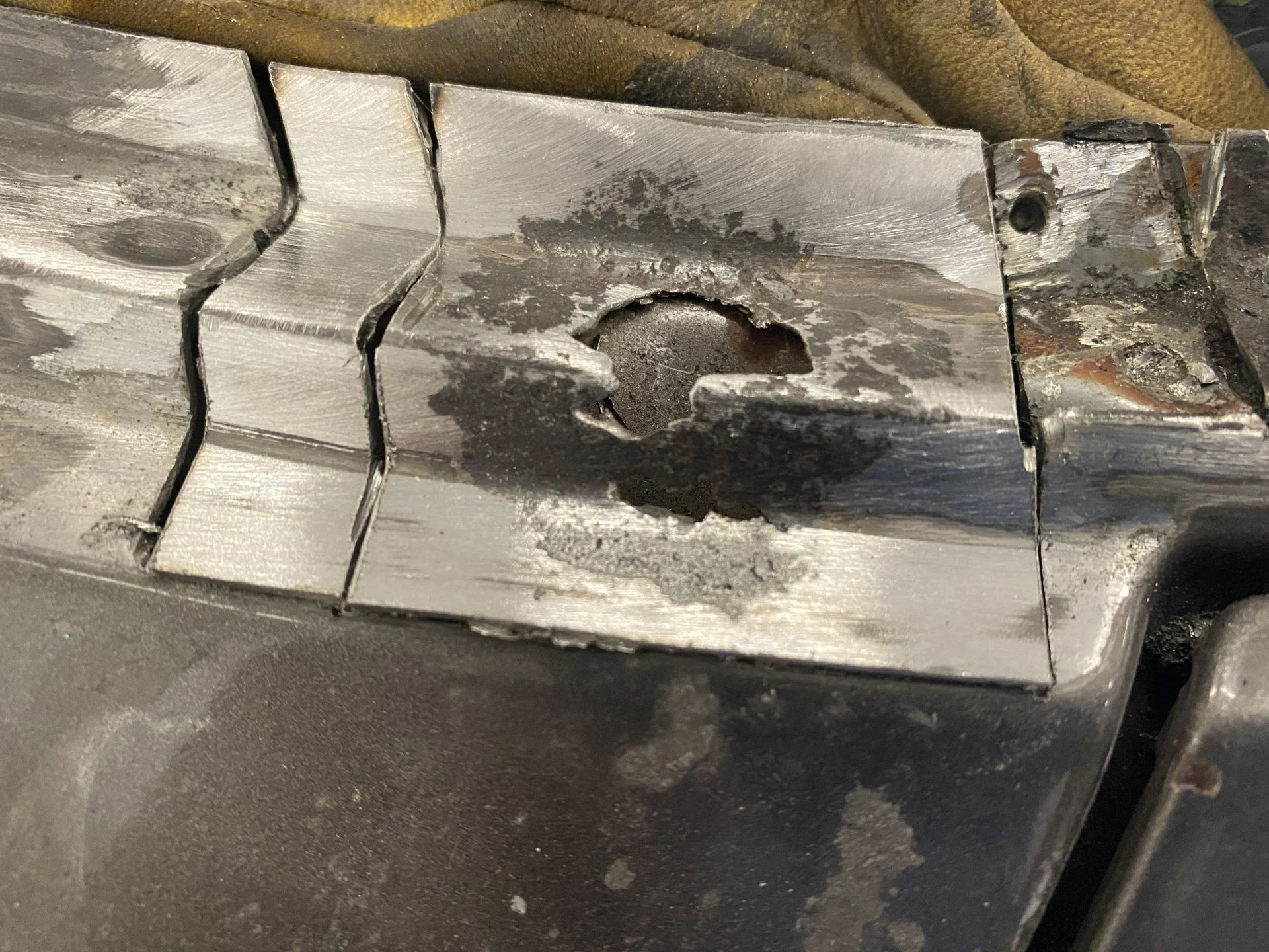

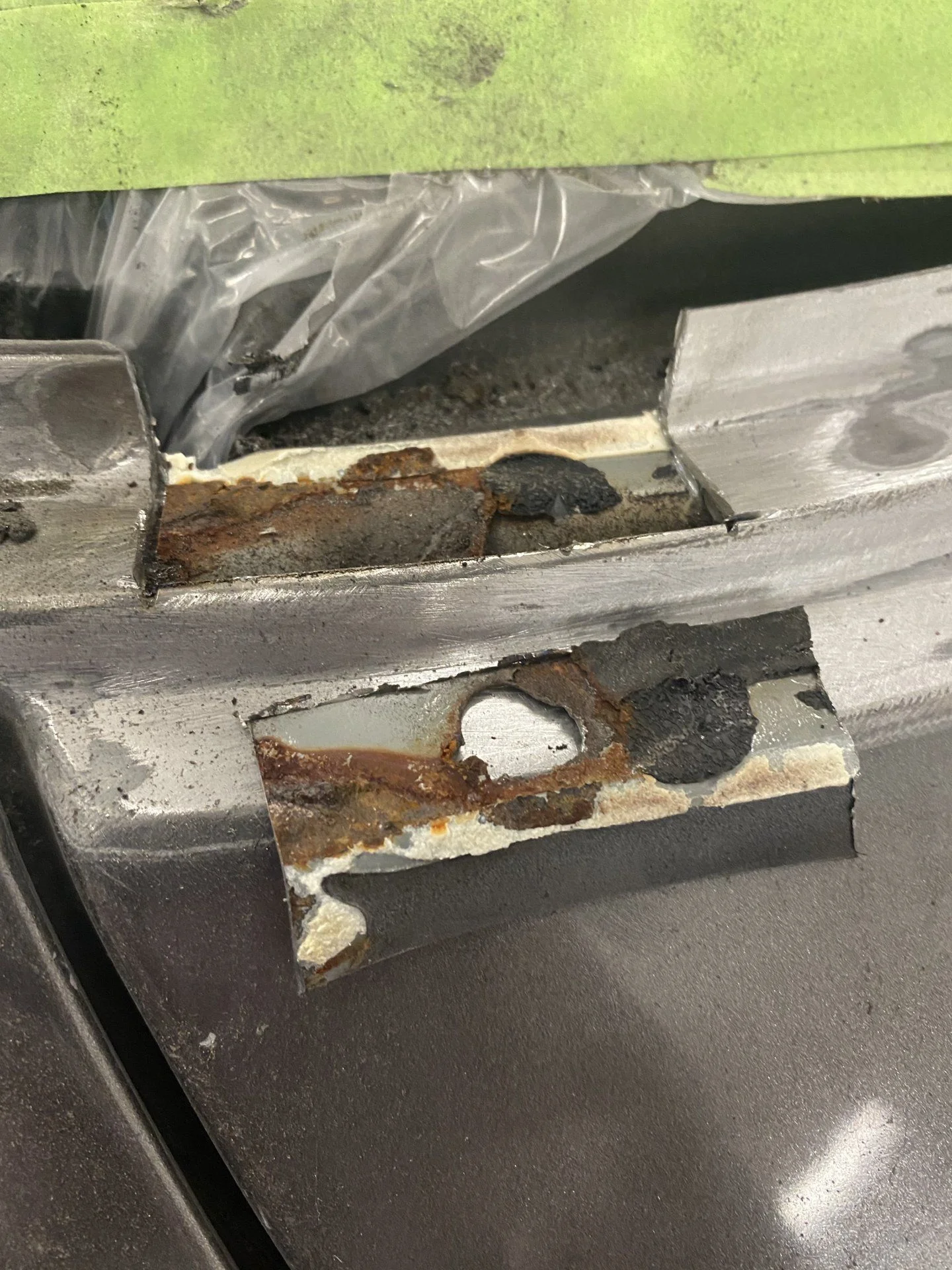

I did find rust hidden in the lower doors. I have separated all the skins, and now I can access all the rust that was pinched in there. It is an area that seems to rust on these vehicles often and is impossible to access unless the skin is separated.

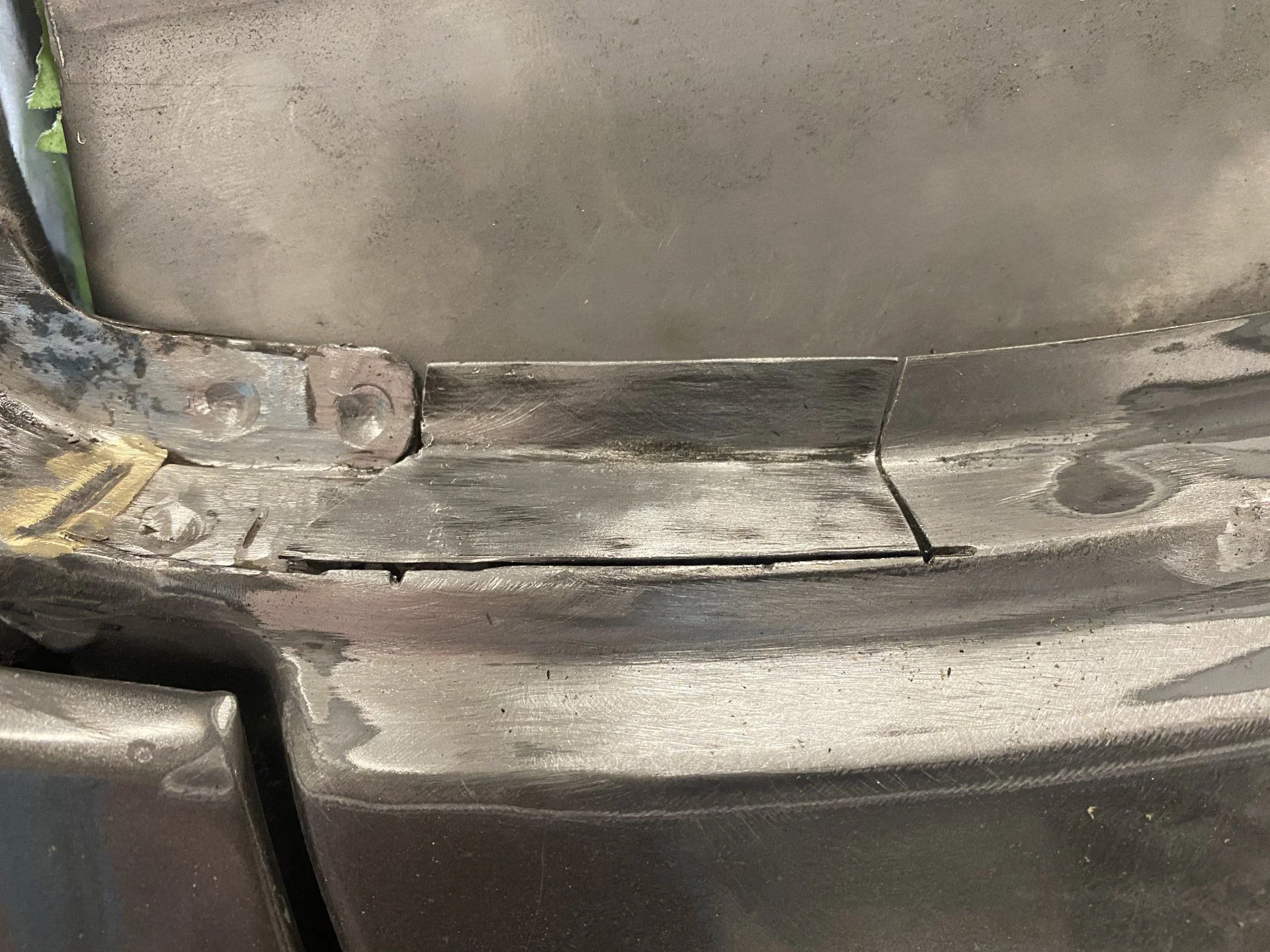

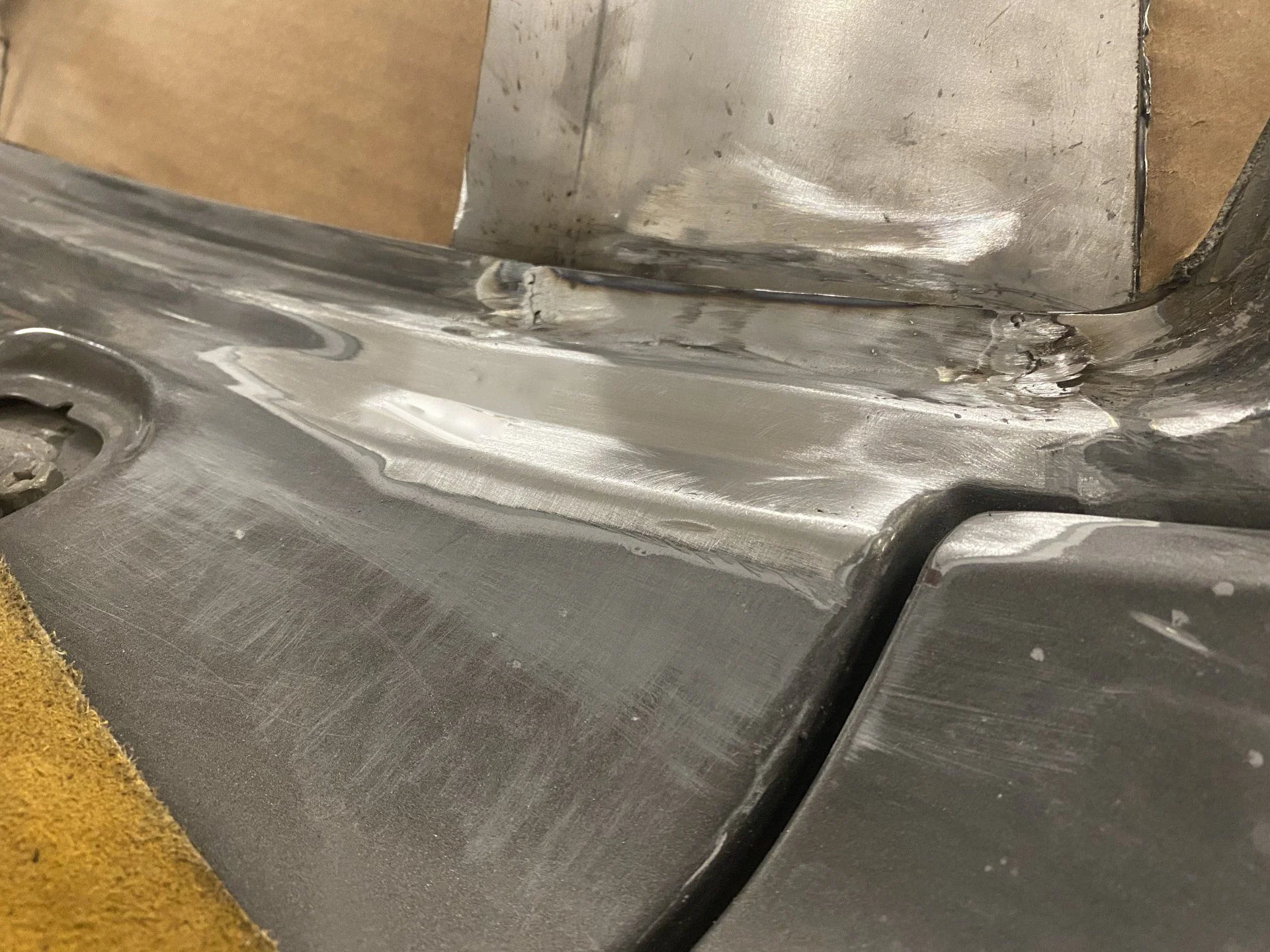

3. Repair rust in rocker/lower fender.

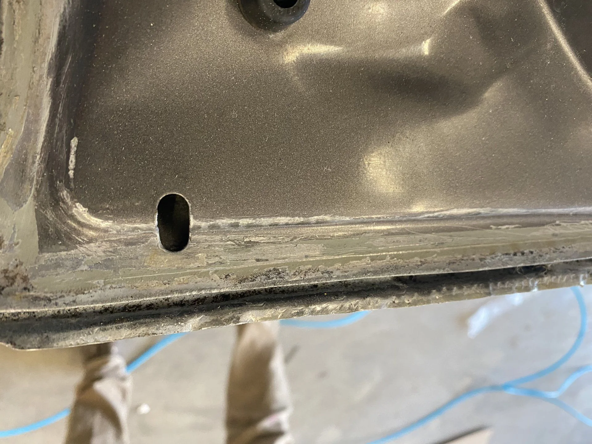

4. Weld closed all holes in rocker panels.

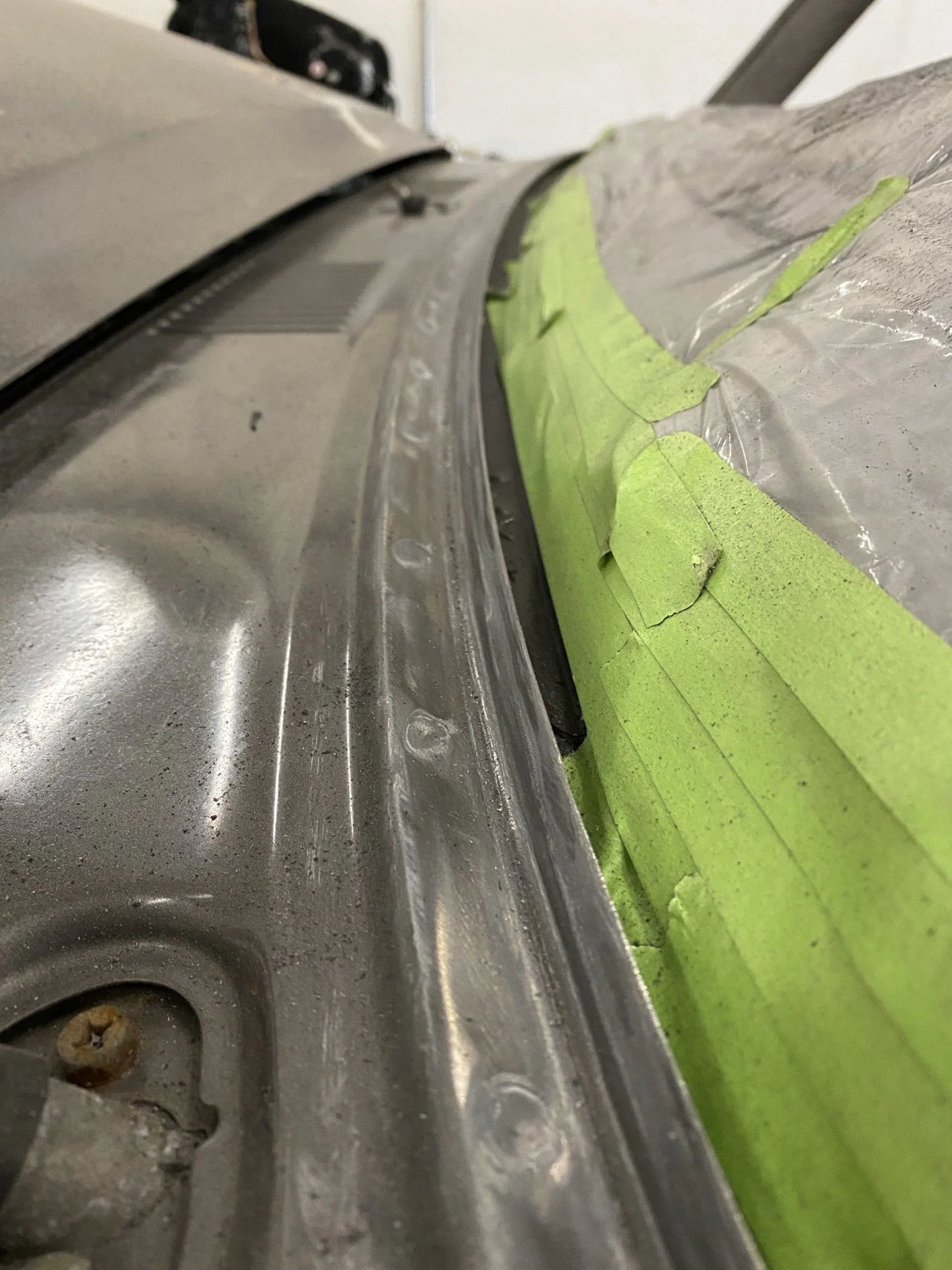

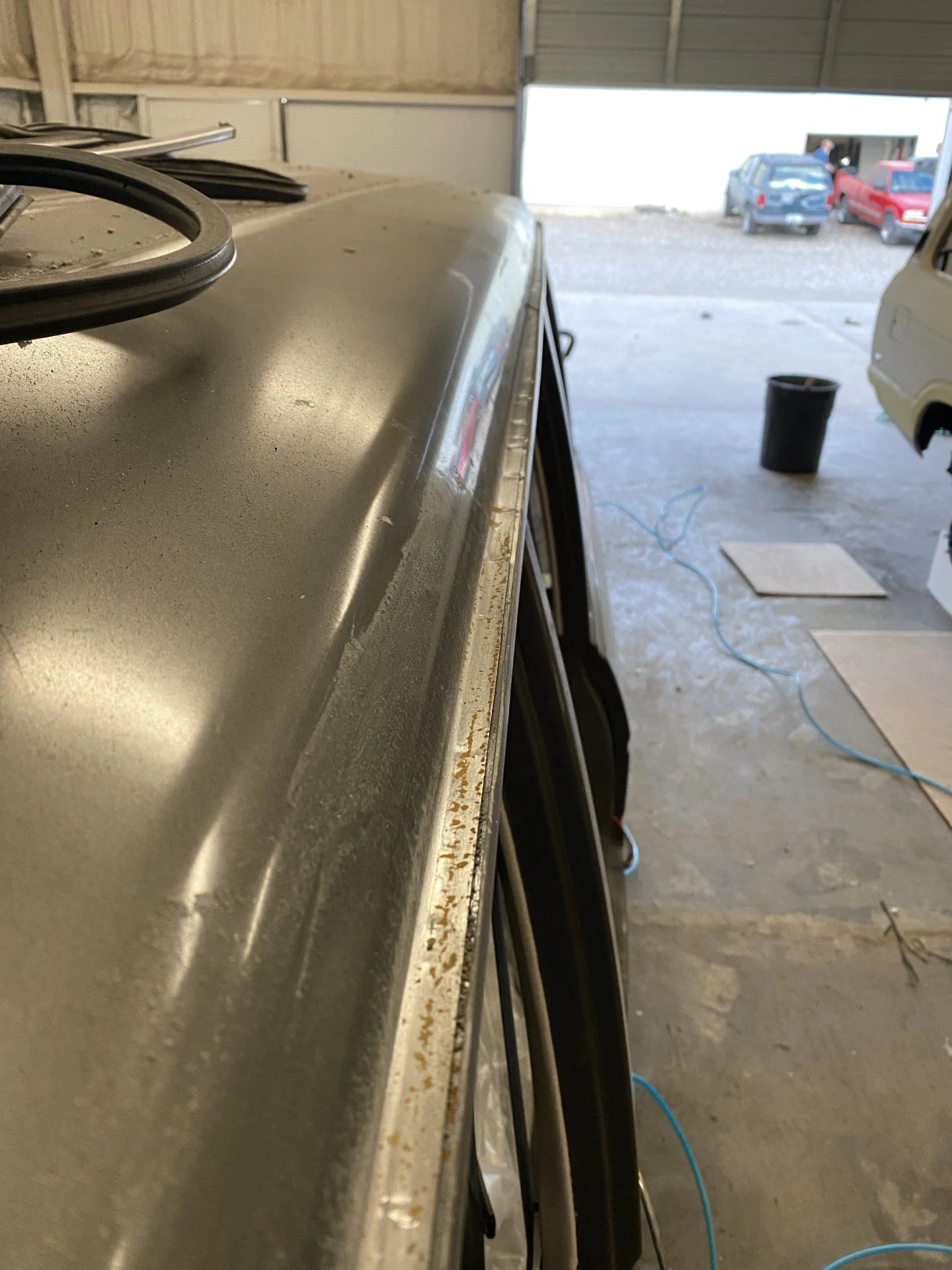

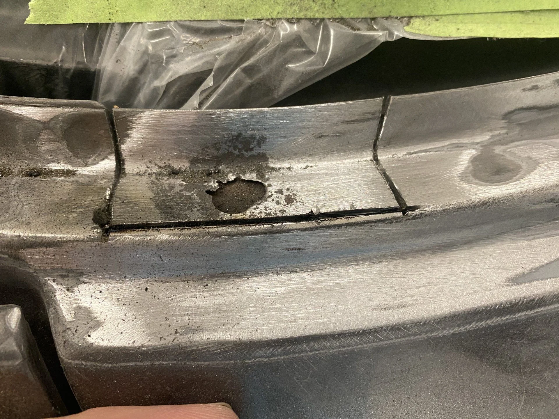

5. Remove seam sealer in roof gutters, and windshield area, repair any rust, seal again.
I presume you mean the factory holes for the snake blinders (rocker trim), and not the drain holes along the bottom lip. Those should be left open....

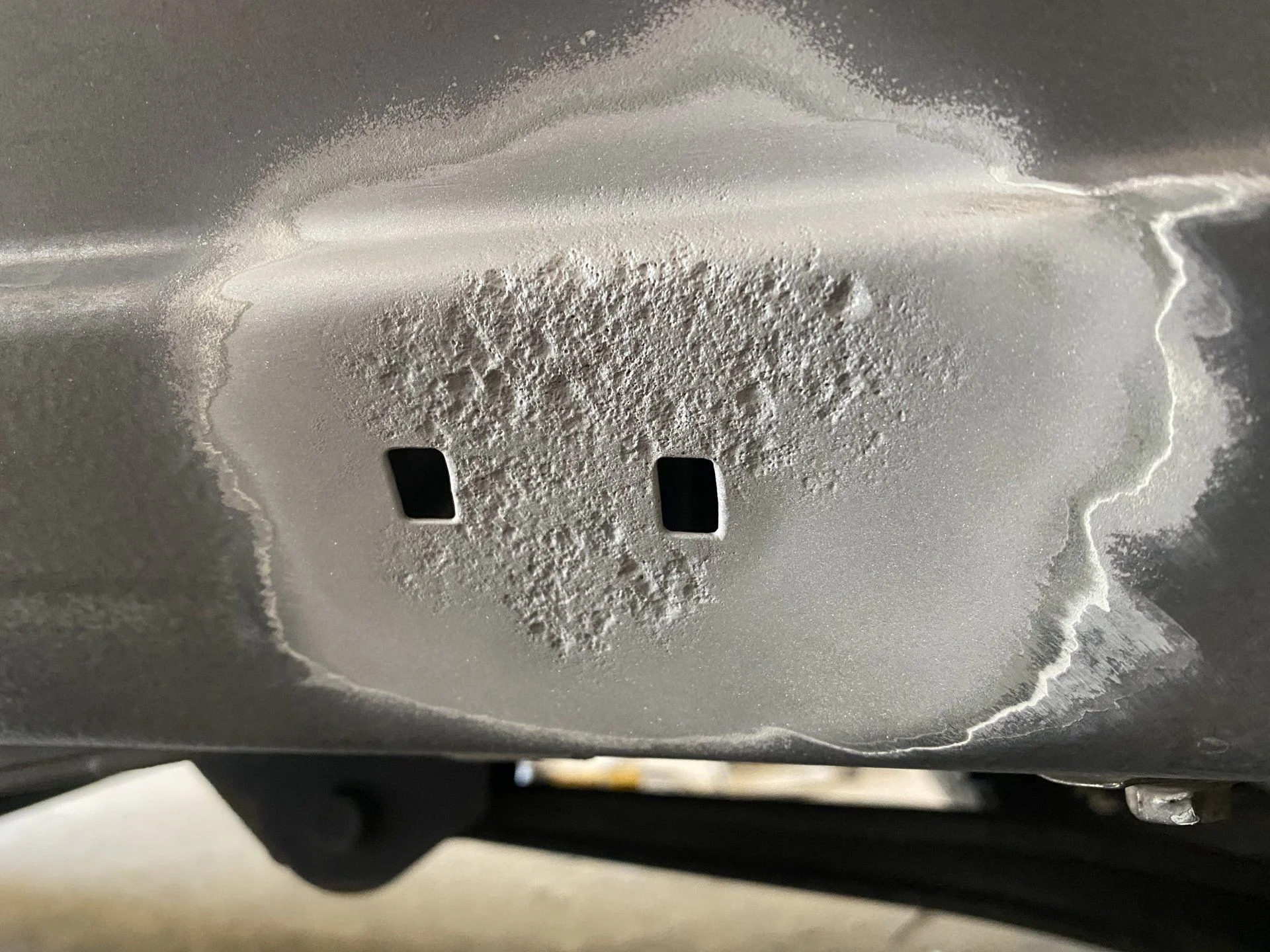

Pitted rust on the lower fender. Sometimes if rust isn't too extensive, and has not formed a hole, the best way to remove it is sandblasting. In the photo here, this is a pitted rust area after sandblasting. It leaves clean, rust-free metal that can be filled.
Takes some skill to weld sheet metal with out burning through it- nice work!
How did you go about removing the sealant from the gutters? Seemed to work well
Actually, a cheap wire wheel, the small diameter one worked really well. It doesn't have to be at a high speed either, slower worked best. There are other abrasive wheels too but I liked that little one. It was thin enough that I could control it and not screw up the paint on the side. It helps to flip it to reverse and bend the wires back occasionally.
