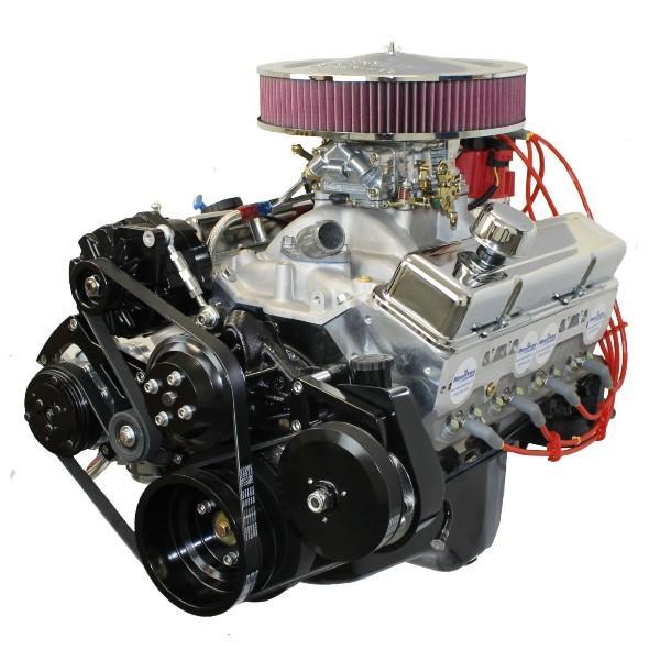

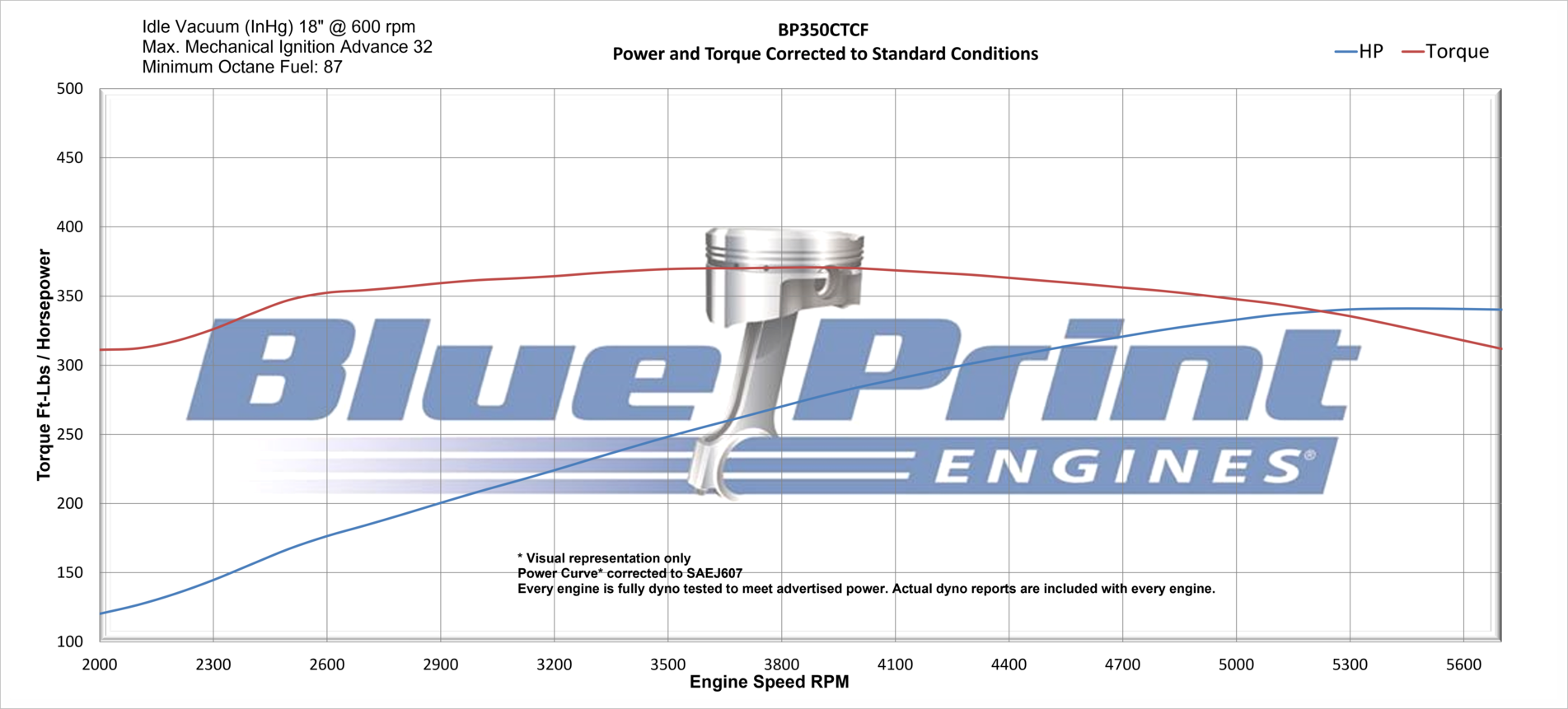

These are the specs of the 350 crate motor I am considering:
  • HP & Torque: 341 HP / 371 FT LBS
    Compression Ratio: 9.0:1
    Aluminum Heads
    Hydraulic Roller Cam
    Cast Iron Crankshaft
    Hypereutectic Pistons
BLOCK:​
  • NEW BluePrint Cast Iron Block
    Manufactured and Machined in the USA!
    4-Bolt Main
    4.000" Bore
    1-Piece Rear Main Seal
    Mech fuel pump provision: Yes
    Passenger Side Dipstick
  • Drilled and tapped for clutch linkage
ROTATING ASSEMBLY:​
  • Cast Iron Crankshaft
    3.480" Stroke
    Forged 5.700" connecting rods
    Hypereutectic pistons
    Internal Front/ External Rear engine balance
CYLINDER HEADS:​
  • BluePrint Aluminum Cylinder Heads - H8002K
    64cc chamber
    2.02" intake/1.60" exhaust valves
    195cc intake/75cc exhaust runners
CAM SPECS:​
  • Cam Type: Roller
    .477 Intake .471 Exhaust
    202 Intake / 212 Exhaust duration
    @ .050 - 115 degree lobe separation
IGNITION TIMING:​
  • 32 Degrees Total at 3500 RPM
ALSO INCLUDES:​
  • Valve covers
    Oil pan
  • Harmonic Balancer
  • Spark plugs and Wires
    Timing cover
  • Aluminum intake
  • Waterneck and Thermostat
    HEI distributor
    EFI system
    Dyno test results shipped with engine
  • Front Accessory Drive with Water Pump, A/C Compressor, Alternator, and Power Steering Pump (Does not fit Corvette)
WARRANTY:​
  • 30 month / 50,000 mile
Engine picture shows carbureted but it would have Sniper EFI kit installed
