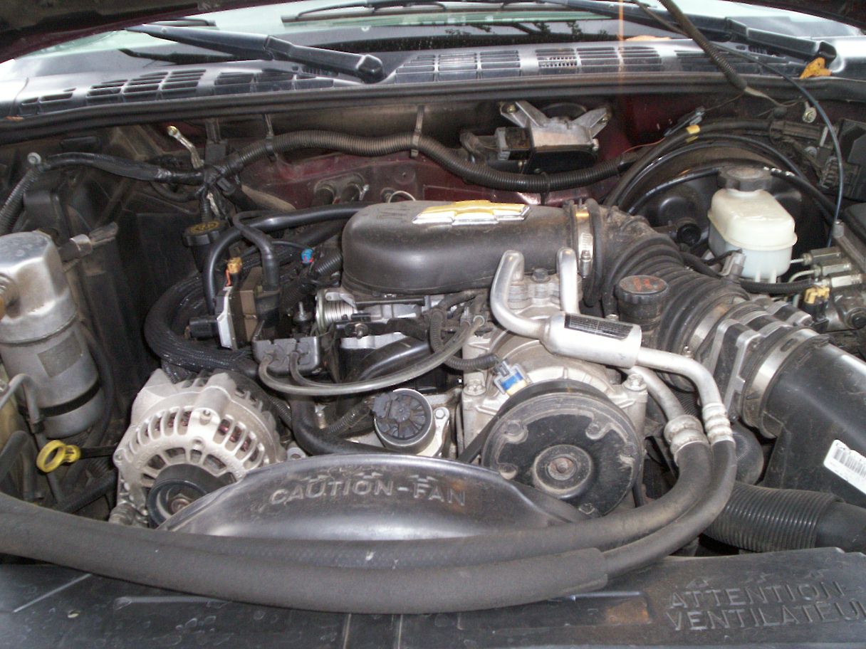

Who's rig is this, anyone know. Not sure what MUD thread I picked this photo up from but I got it on Nov 29th. Hoping someone recognizes this. Looks very similar to what i am considering.

Darned if I can help you. I just searched all the Vortec build threads I have bookmarked and it’s not in any of them.
But I saved the same picture on November 29th!
