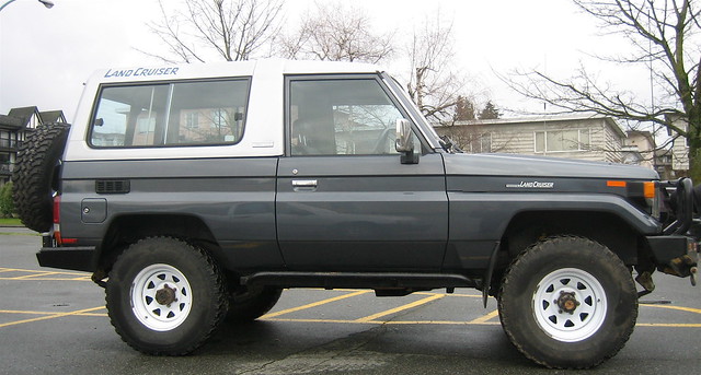

I finally picked up my truck a few days ago and the adventure has been going great so far! Met some great folks and owe some photos and updates to my other thread, but for now I have a quick decision to make on the suspension setup.
I went with the ARB Dakar OME heavy setup but asked them to remove the 3rd leaf from the rear pack as per some references found here on the board. As it's setup right now I'm a bit surprised how low it is sitting in the back. I've got some gear and stuff in the back, but planning to build a full drawer system, fridge, etc. So maybe another ~150lb in the back. That's 68kg for our metric friends :)
The ride is really good, I've driven it around town and on the highway and up and down a pretty bumpy dirt road and it handles great. I'd like a bit more height in the rear and am even fine with a bit of a rake if needed when not fully loaded. Also really want to put some spacers on so that it looks a bit wider stance but honestly drives well as-is and I went to quite a bit of effort to find the 16" prado rims so I wouldn't have to run them!

Yes, the obvious answer is to put the leaf back in and see how it sits/rides. As I am the one who told them to remove it in the first place I'm seeing if any first hand experience could offer something along the lines of:

I would add the leaf back in and see what it gets you to. That would be my first step. I have the same suspension in my 70 and with the rear bumper and a bigger spare tire it sits somewhat decent I think

I know it is kind of pain to add the leaf back in, but it will be nice to have the cargo capacity when you go wheeling and camping.

Another vote to put the leaf back in.
Mine sets a tad tall in the rear with an OME setup. I guess the only weight back there is the spare tire.

They are setup for 'constant load' so if it sags with no load add a leaf, which will be a tad too stiff without a load.
Drawers, water, Puma, 40 l fuel, food, fridge, tools, recovery gear, armor -it adds up quickly. My 74 is 6,200lbs fully loaded for a week in the bush with no support

I'm putting heavies in the back. I'd say throw the leaf back in, you've added weight back there and are planning to add more.
FWIW this is how mine looked when the rear bumper first went on, still on 255/85R16s. Pretty similar to yours:
Truck looks great! I'd put the extra leaf back in if I was you.

I had to remove my 3rd leaf but I don't have the swing out bumper on mine, just the stock flimsy one. That extra weight of the bumper is what makes the difference of needing the extra leaf. If you think the rear is low now then you will want to get the leaf in before you build the drawer system. Either way you start, with or with out the leaf it's nice to have the option of tuning the leaf pack down the road.
