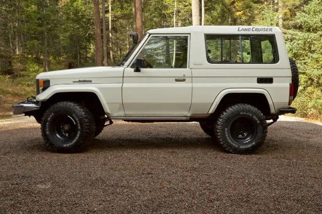

That is exactly what I run in Boulder, CO! (3bii included). In short, no issues. I drive an '89 BJ73. I've run this tire size since I bought the truck though, so I have nothing to compare to.

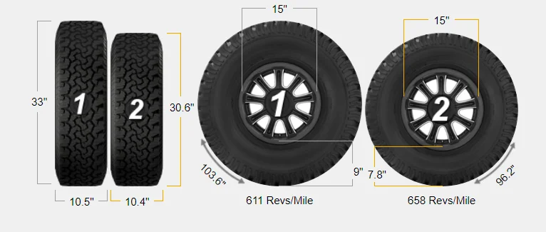

The difference between the 33's and the OEM spec'd 265/75/R15:
The width difference is minimal, so not a huge burden on steering. Regarding height (and impact on power to the road), BFG's run shorter than specified by about 1 or 2 inches, so I figure they are probably closer in height than indicated above.
