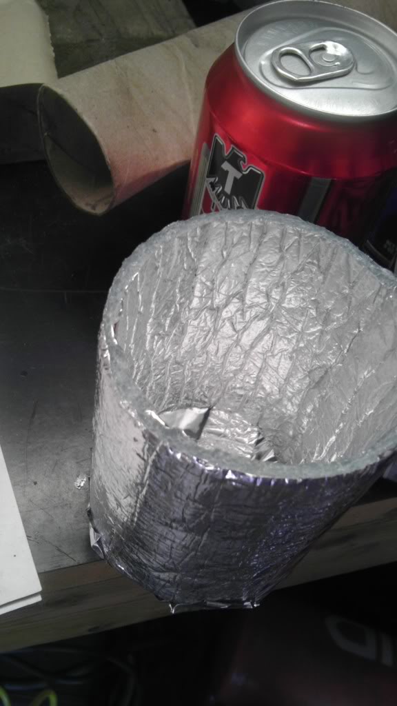

Aahaha no thats not my engine, that would be bad news! It was just a exhaust mount that I hadn't tighted down. We where fiddling with trying to get the temporary glass pack quieter by adding a twist of sheet metal inside. It worked a bit.

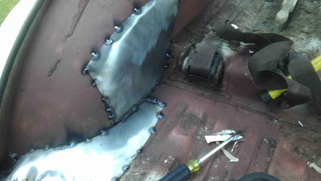

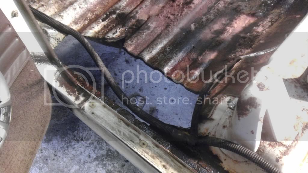

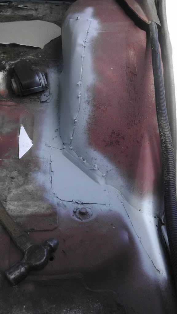

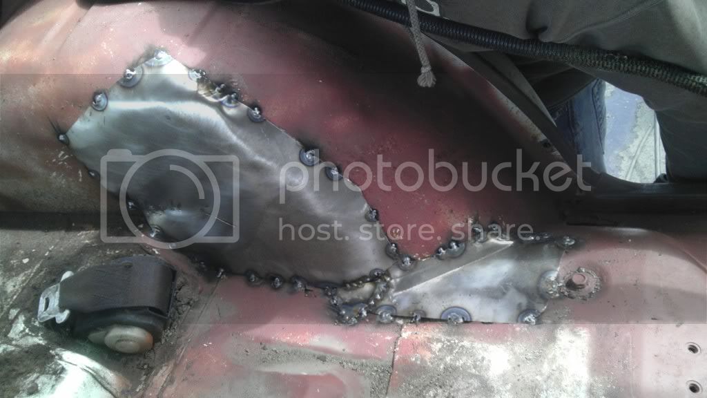

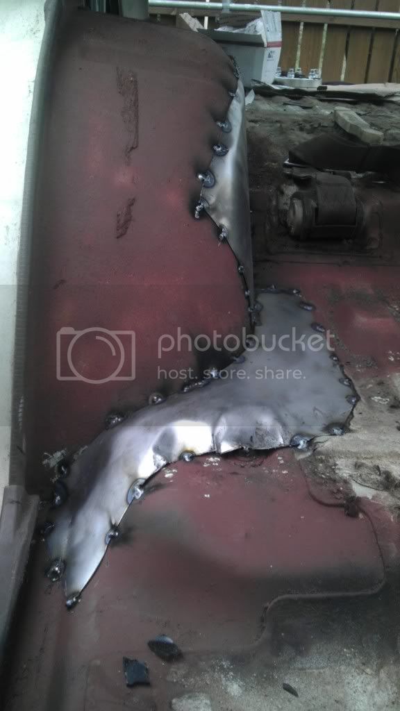

So I started on the rust yesterday and got this small back portion done and primed. Then started cutting on the inside today, there is always more then you thought haha. I am cutting, then poly wheeling, then wire wheeling then doing two or more coats of opsho then rustoleum rust converter followed by rustoleum rusty primer and then color. Hope that does the trick! for a few years anyways...

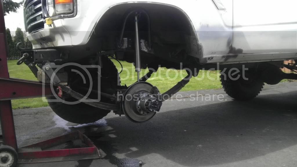

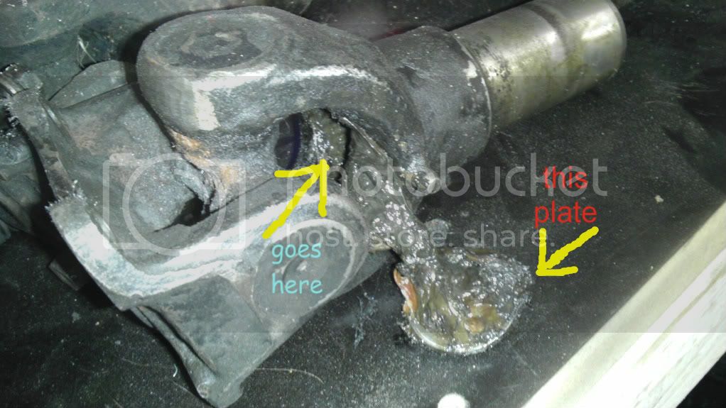

Anyone know what happened here? how did it come out and how does it stay in? as you can see I haven't cleaned it up to look myself yet ;)

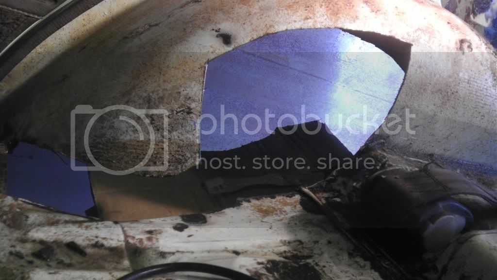

Pictures of some body work. Also Like I idiot and went to spray the rest of the rims.. luckily only did one when it started to sag off the primer Dang! forgot recoat within a hour or wait 2 days. Really? even after doing that on the grill! to many beers I guess haha

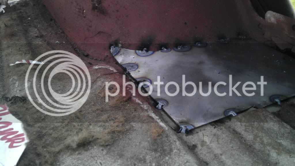

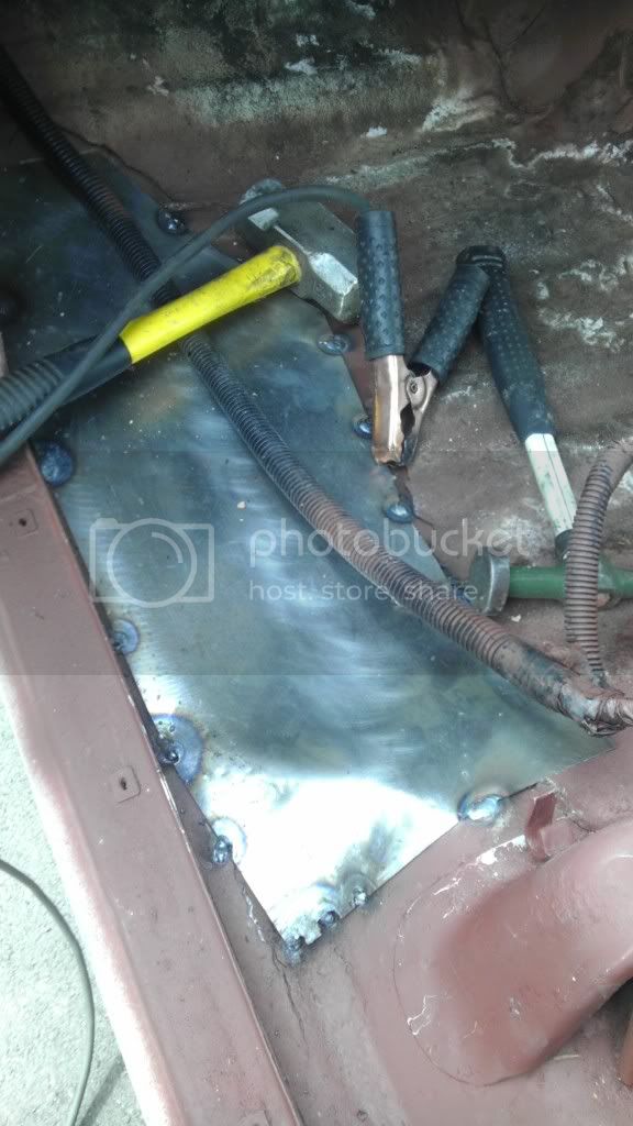

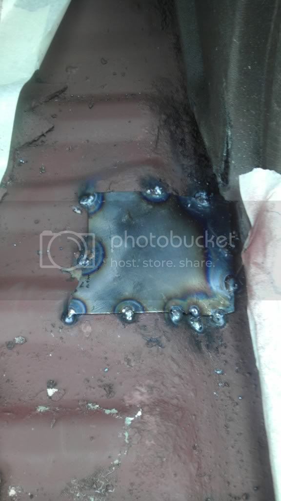

Took out way more of this floorboard then I thought I would have to, I just kept cutting back until there was no rust.
Either you or the PO overfilled the slip Joint with grease, then when the shaft compressed it forced that cap out. I am not sure if you can get it back in without taking apart the driveshaft.
The plug on my front driveshaft came out as well, I went to a driveline shop, they said that that grease nipple does not do a whole lot since it is right at the end, it would be better situated in the middle or something.
Anyways, I just greased up the splines with some moly and threw it back in.
One day when I have it apart I will plug the hole up.

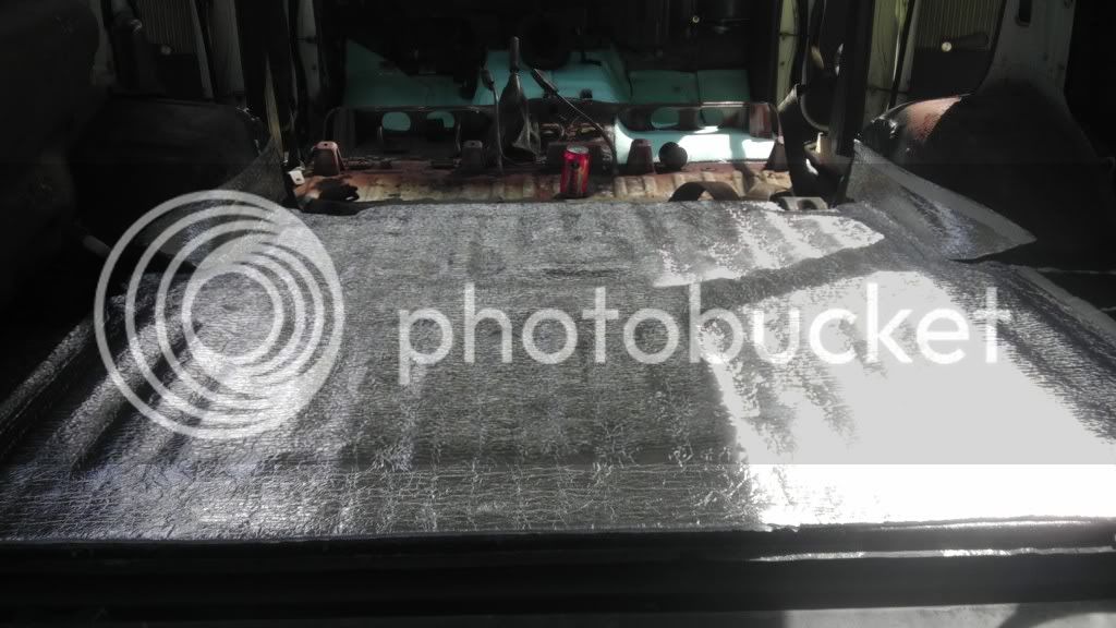

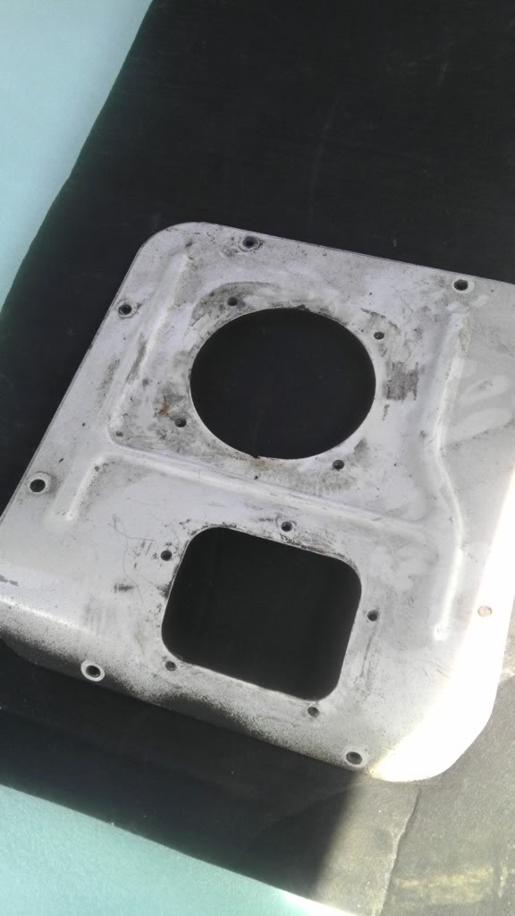

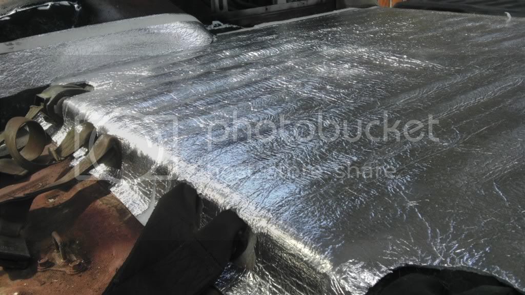

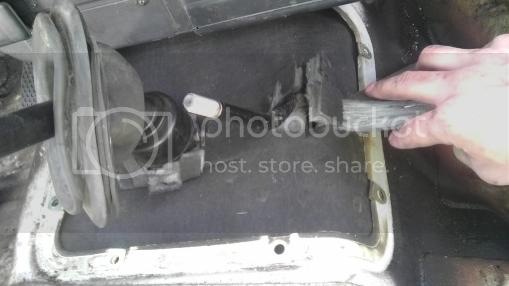

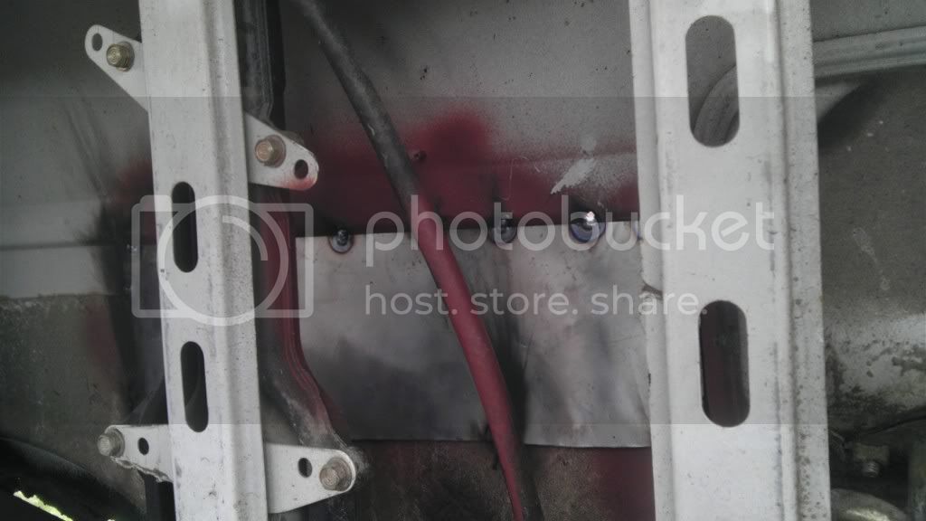

So before I laid the sub floor I decided to do the 2 wheel low modification. I also wanted to insulate over my transmission.
From up top like this it was pretty easy, I just used a angle grinder with cut off wheel and zipped her off.

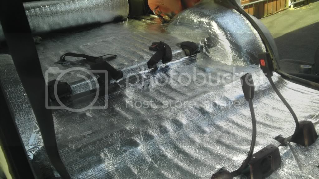

On to the sub floor
I got a little more done then the pictures show and then I ran out of glue :o

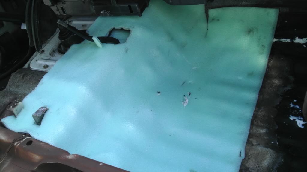

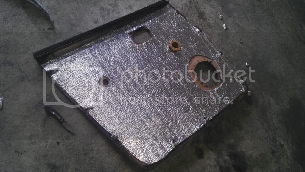

This stuff is low e the stuff up front is concrete insulation its foam aluminum foam. to help with sound and heat. The rest is thinner and its alum foam alum.

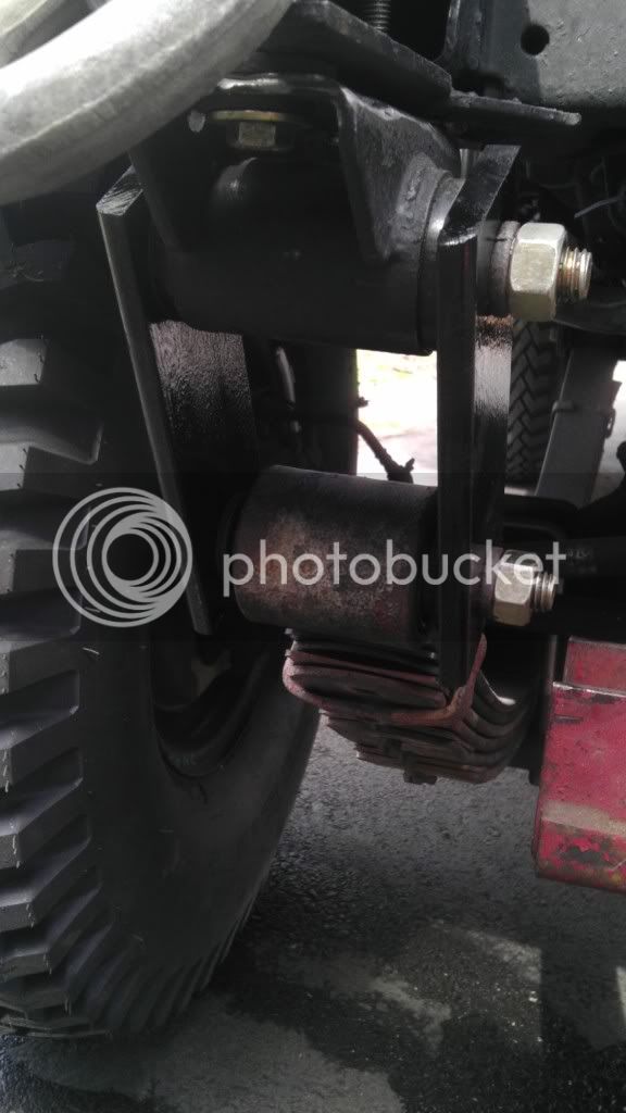

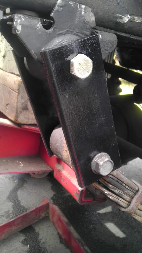

I also got to the shackles last week, finally re made those and painted them.

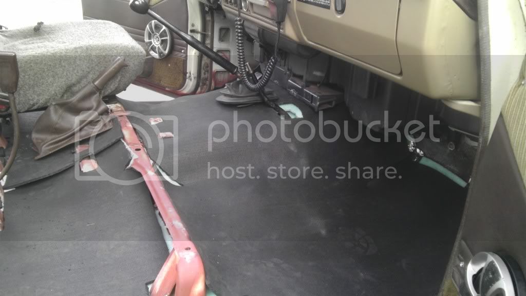

Anybody have any grand thoughts on flooring? I have been over and over it, just can't find something I like. I don't want vinyl, I don't want carpet, I really don't mind a thick rubber matt in the back but what about the front? I will try and swing by some commercial places today and see what they have.

OK cool, maybe I will just weld it on then. I though it you overfill it would just squeeze out the splines. But I guess on the first hard bump that would be a ton of pressure.
If you do that, maybe drill a little relief hole in the plug.

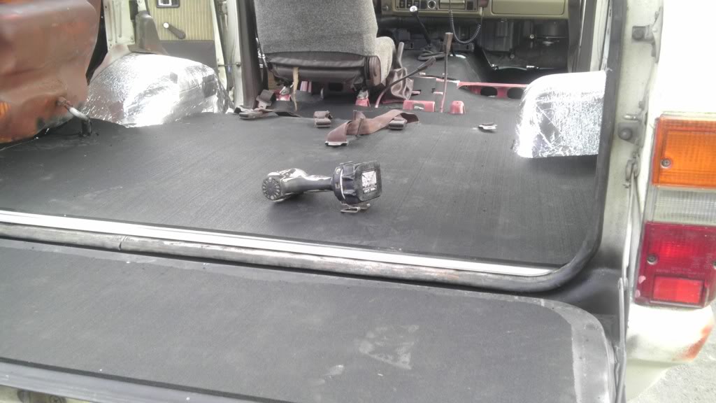

Snow, Nice build you have going. For the cargo area I'm probably gonna run to the farm supply and grab a horse stall mat. For the front I'm going back with carpet. They are about 1/2' thick and can take quite a bit of abuse.
Good luck on the horn hunting!
Thanks, I went to our farm supply and picked up 17' of 1/4 inch stall matting its 4 foot wide. Worked perfect! they had 3/8s by the foot but this stuff seems thicker then its advertised. It was aprox 5' across three times and enough for my rear hatch to. I need a little more for my wheel wells though. Pics coming soon.

What type of steel did you use for the shackles, I love it
Sent from my apple IIe using msdos
Just regular cold or hot rolled steel, I dont remember which it was. They are 3/8s by 2 1/4 I origanaly had them 2" but I remade them and the yard only had 2.25" which I actually like the look of more now.

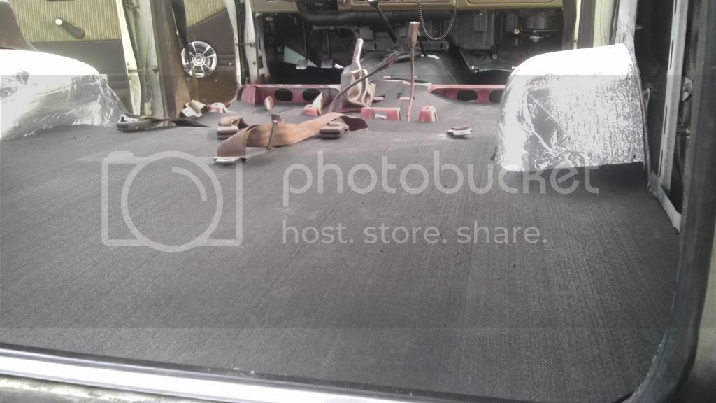

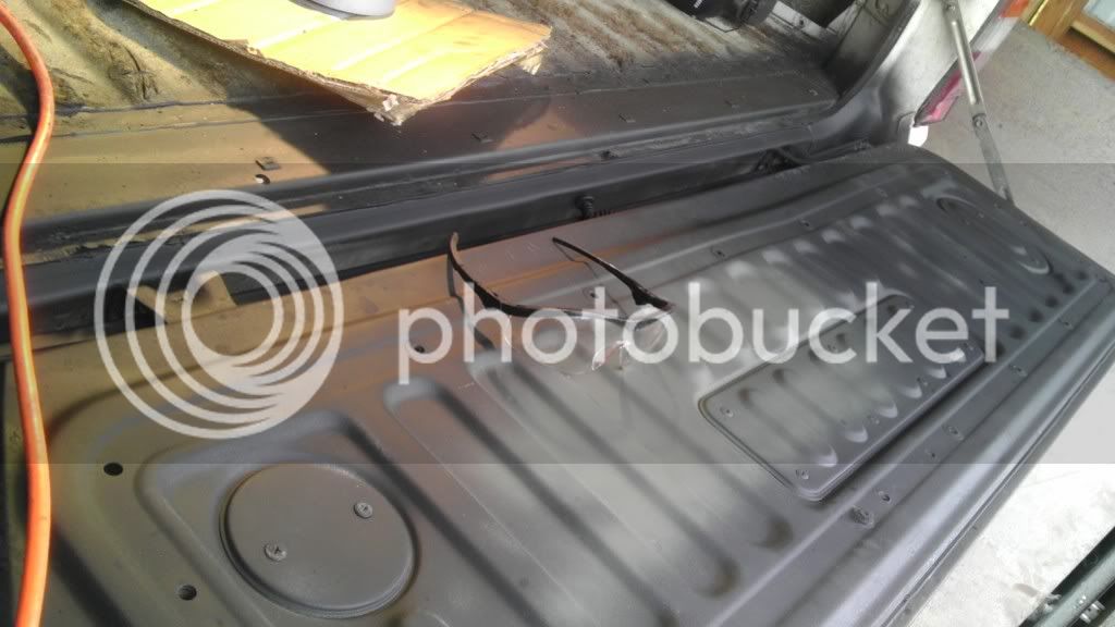

finishing the under layer as mentioned above I went with rubber so most of this was kind of a waste but I can always just pull the rubber out and run carpet later. It comes out easy.

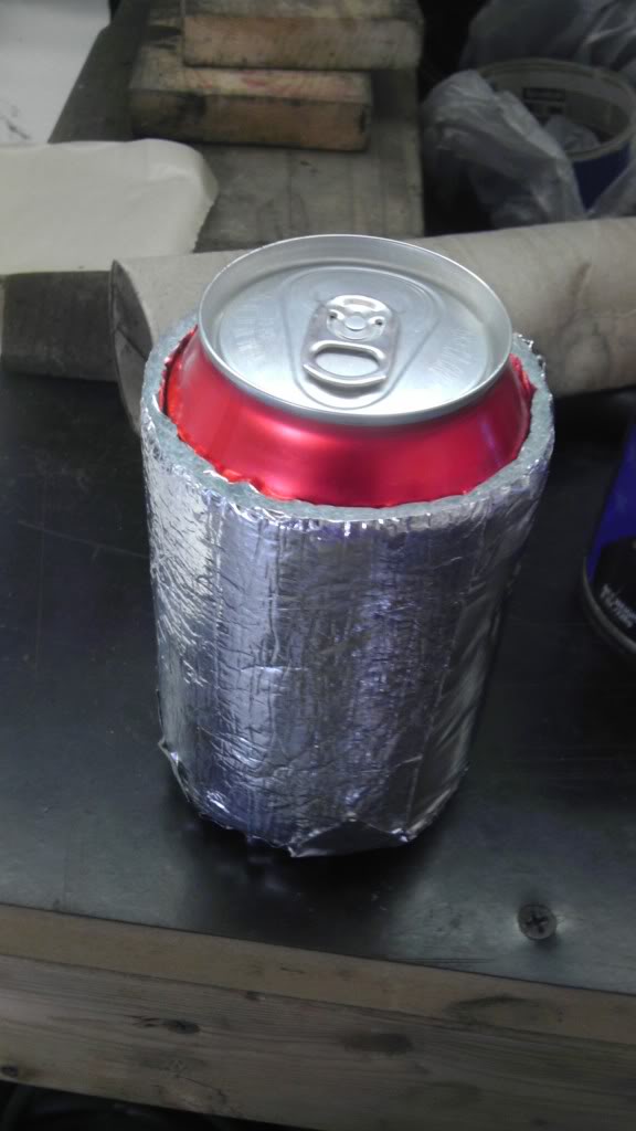

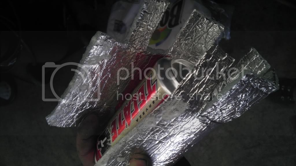

Then I got tired of my beer getting warm all the time, I drink slow when I am working.

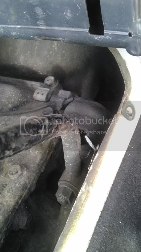

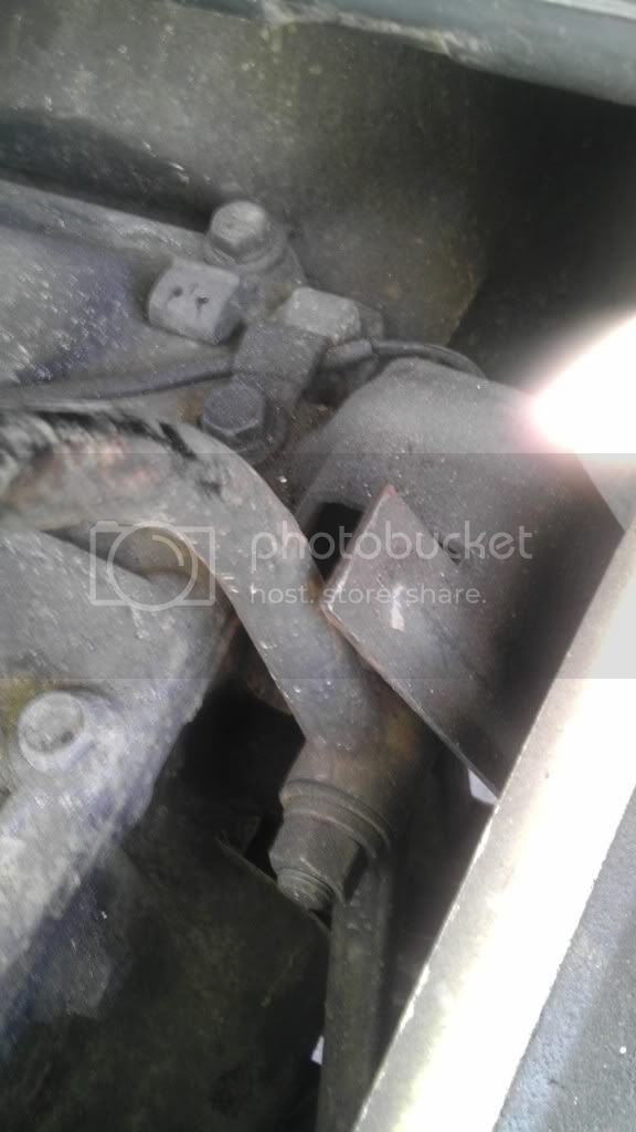

so I discovered a case of low speed death wobble with her a few weeks ago like 5 mph and again around 30 but it always corrected its self, very minor. so I went to pull my shims I had guessed on from the beginning that I would need. pulling them would give me 5 degree caster approx, took her for a spin GOOD GOD tire chirping dw. Around maybe 15 mph. I had already tightened everything up so I went to check toe and it was toe out a 1/4 ish inch. Went toe in 1/4 inch because thats what was on the top of my head and the dw was still there. I also saw my drag link/relay rod/steering arm or whatever the proper term for it on this rig is was bent. So I grabbed my spare and put it on and set the toe (all at the same time) to 1/8 inch in. And bingo, seems to be fine now. I dont know if the toe was the biggest thing (other then going from 1 degree to 5 degree caster) or the relay rod. It does not help that those big ass bias play tires want to throw it into dw right off the get go.
Anyways, glad thats over, if it starts up again I am getting rid of all that caster and going to 3 or back to 1.
On to the flooring!
This stuff turned out so nice, lays real flat and will look super clean once everything is back in. It was a :censor: so cut though, I used tin snips or sheers. but a real real good pair of scissor shears would be best. Even with me shaving sharp knife is was to much work.
no smell yet, but I will pull in out and run some vinegar over it and let it sit in the sun for a few weeks if it starts smelling.
