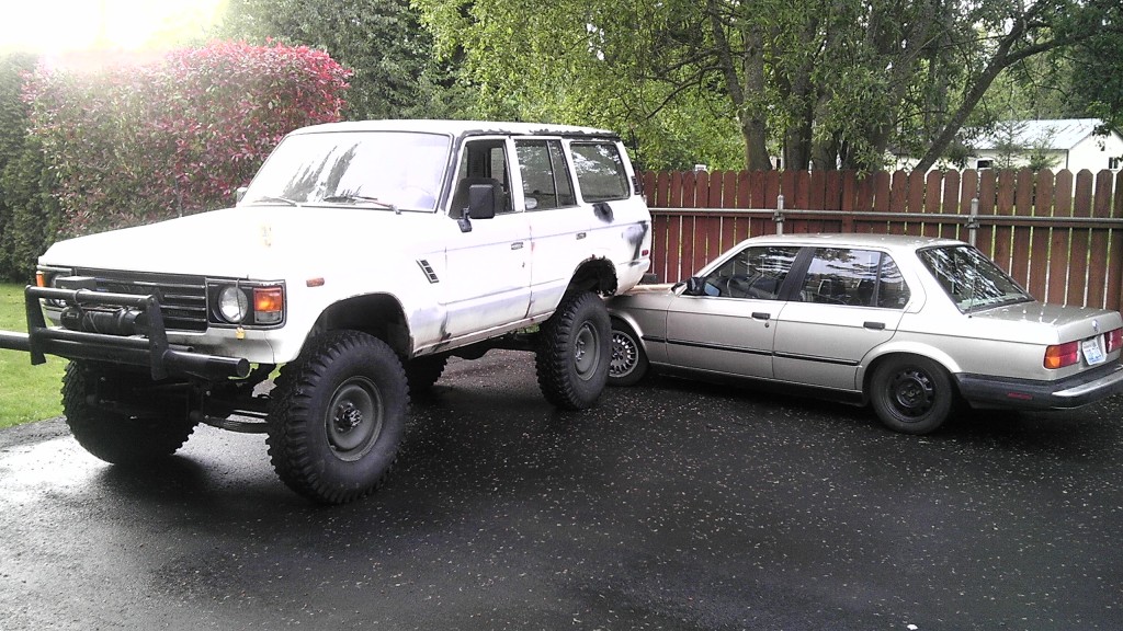

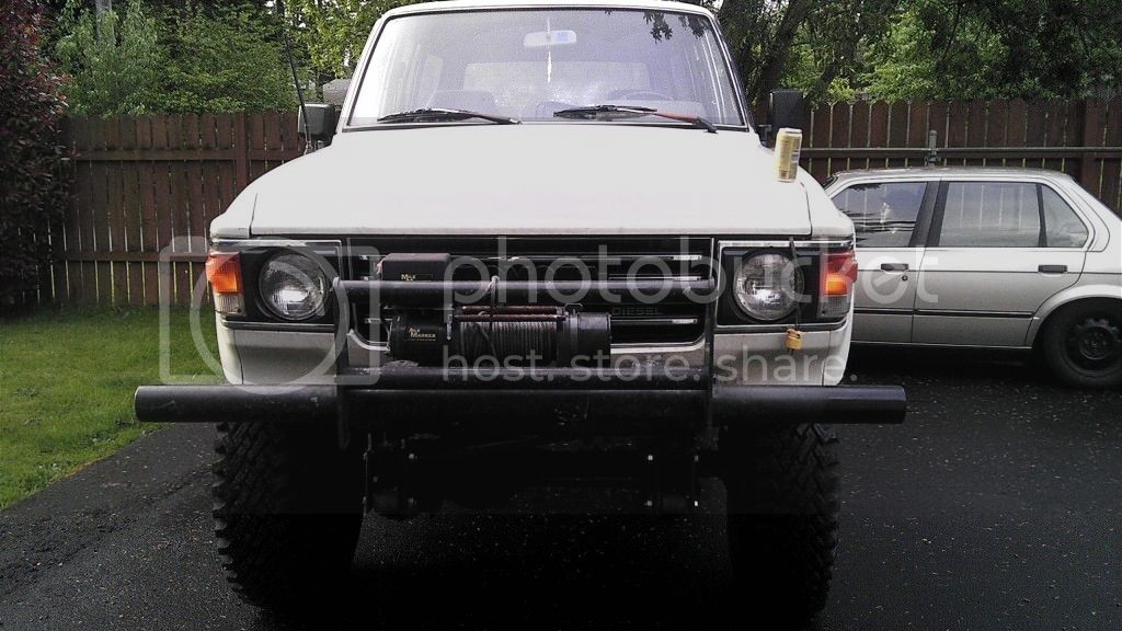

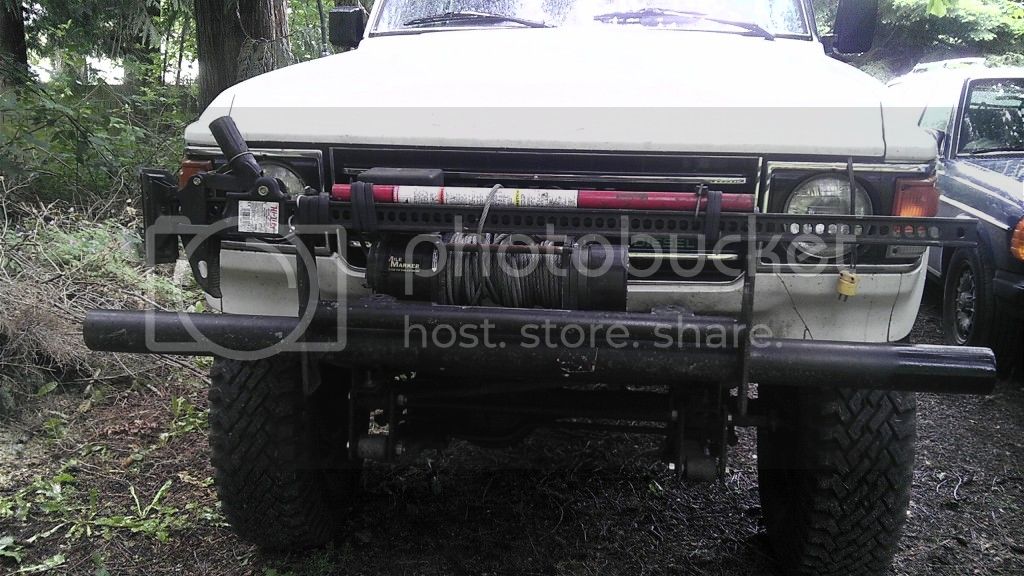

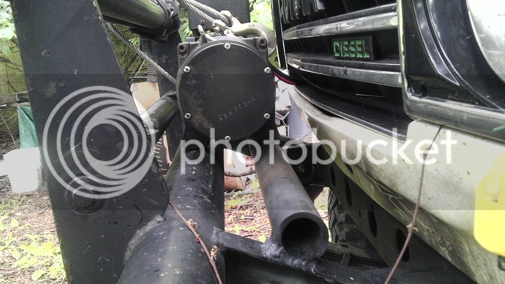

I mounted the winch and temporarily tightened the preload on those trunnion bearings. Here a pics from camping a month or so ago, and so more recent pics with the winch mounted. I was a little worried about strength but we tested it pulling my buddies 4 runner and it was pulling against his full brake pressure.
I since then got stuck in the middle of a field while out turkey hunting :crybaby: I had to spool all the line out and then use two straps and winch at over a 45 degree angle with no fairleads mounted yet. But it did great.
on to pics, Gosh I want things to settle down so I can get back to working on her:D

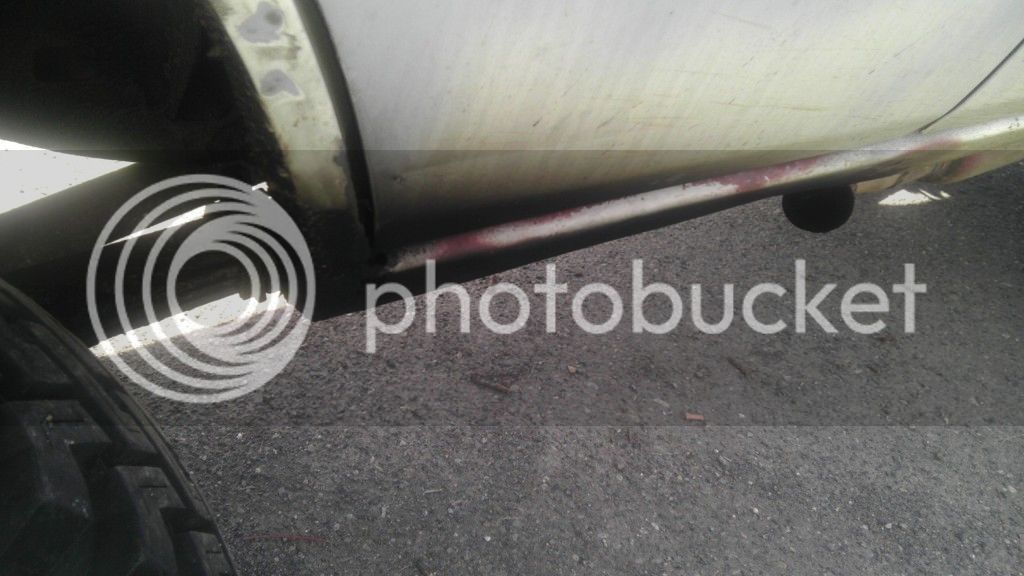

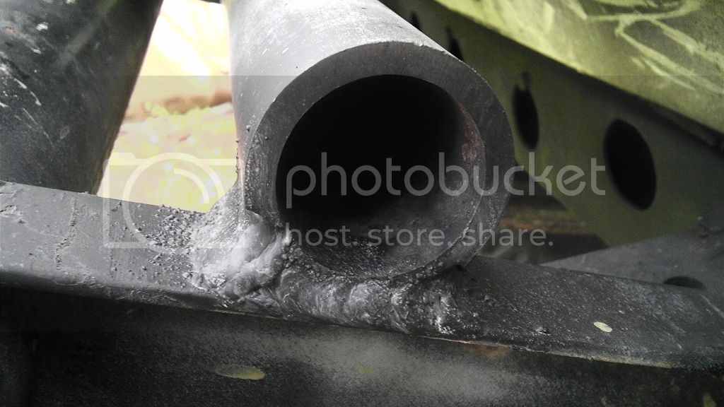

Once I turbo I will need to fix this little problems, as of now I brought the pipe out a little further and it helped a lot.
I offset the winch so I could still see the TOYOTA when I get that painted.

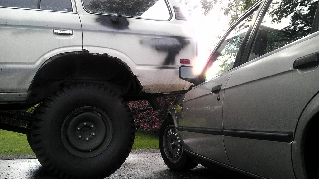

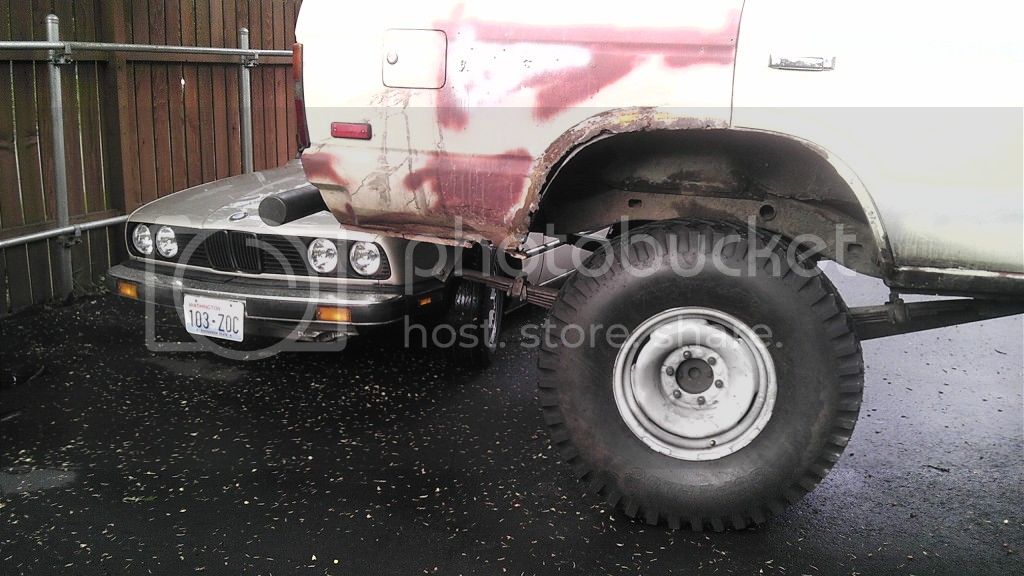

Couple of my buddies lowered 328, this is why they have min bumper requirements!

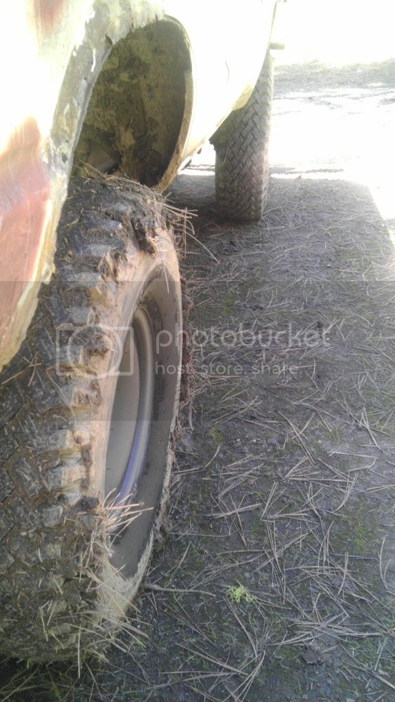

Some people ask about my tires, here is them caked with mud. The outside cleans out fine, the inside not as well that tread is very deep though. Aired down they clean out much better. Also depending on weight I am running 22psi 24 when I am fully loaded. 22psi loaded has a lot of sway 24psi is perfect. 20psi feels good running logging roads unloaded.
haven't been on anything crazy with a need to air down but I will update on that when it comes.

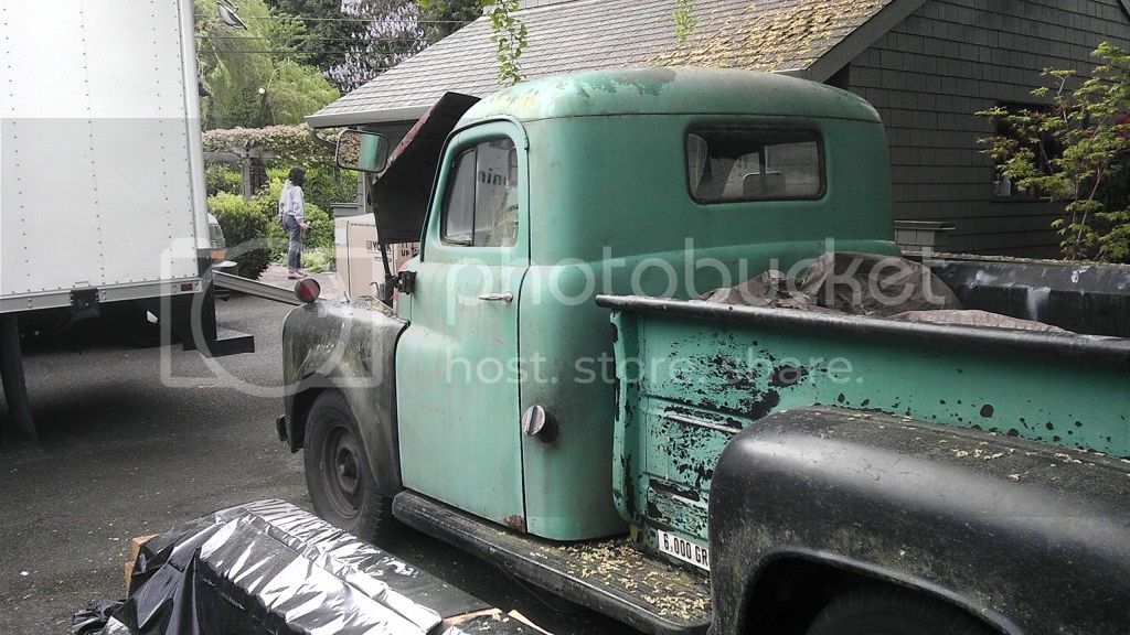

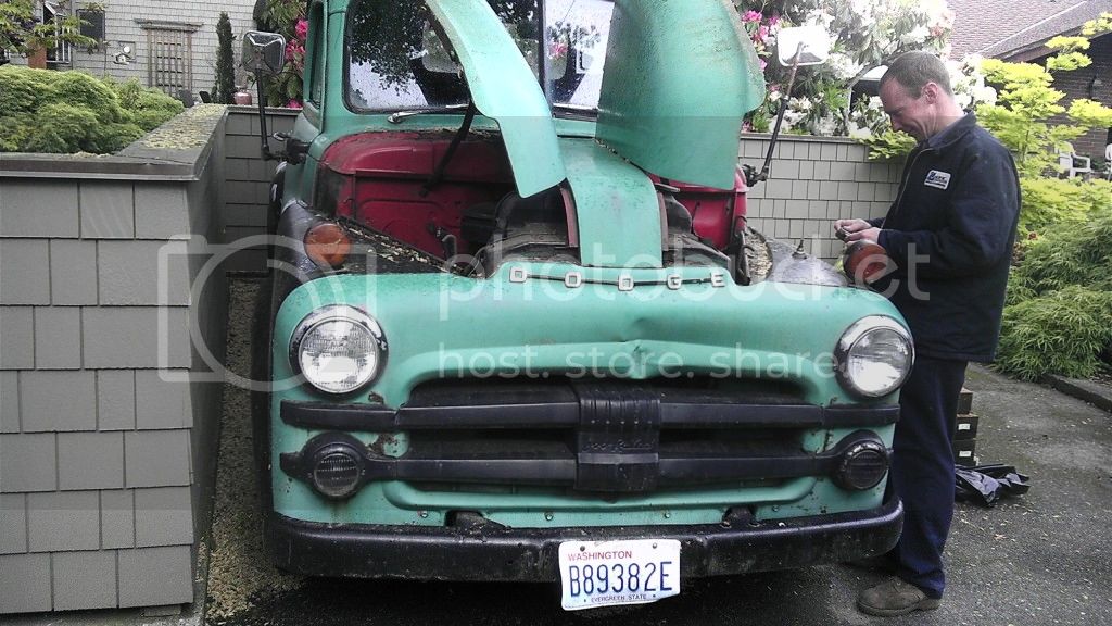

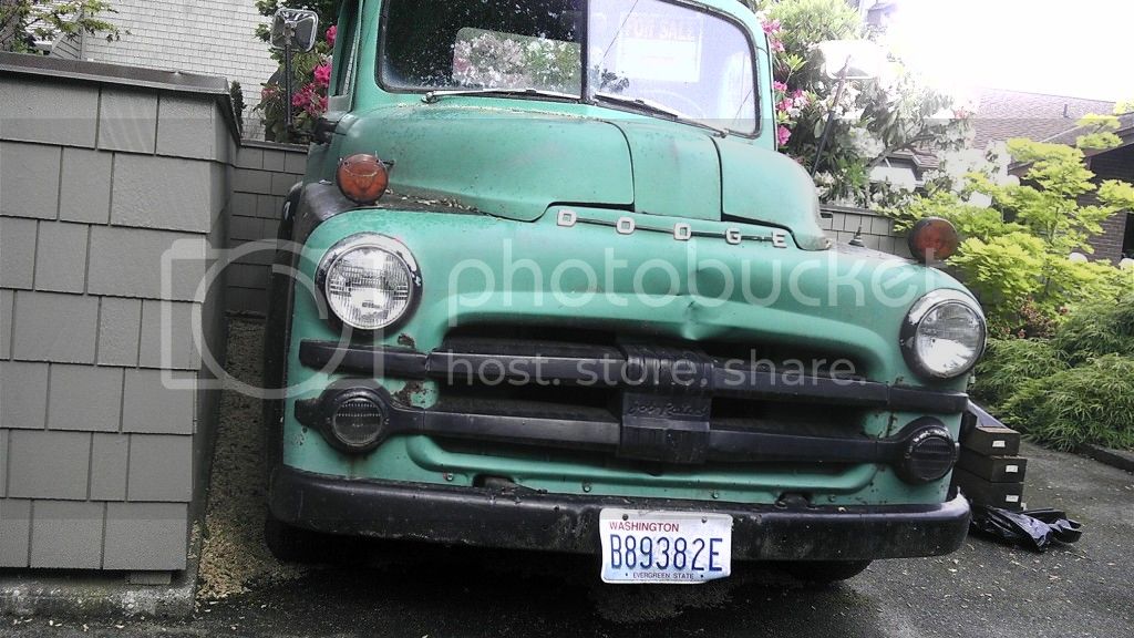

Build is coming along nice. Is that a 52 Dodge?.
J
Yup b3b 53 dodge job rated pickup, flat head engine, oil bathed air filter so cool! Hah my wife loves it but doesn't want me to have another project. I told her I would let her little brother drive it for his first car as he is getting his license soon and she said 'hhhhrrrrrr okay' haha score
