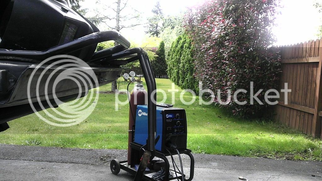

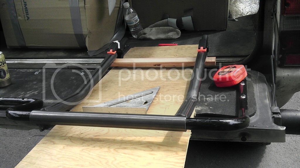

Ok so I actually got a little time to go bs in the shop. I decided to fix the pomel Horse issue since I had everything there and was just killing time drinking beer anyways.
So here it goes.
Ok so first off I don't know if this has been done before if it has I have not seen it.
Second I am assuming all 60s had these bars because both mine do?
Third whats the deal with them? It seems there are easier ways to protecting the tail gate.
Here is what I did.
Then I ran out of welding wire :doh: I was in process of welding 'tabs' so the ladder stops at a certain point. I will also add another ring and I have the option of adding one sliding ring on the bottom that telescopes inside the ladder. That way it can drop down even more if I want it to, but I am not sure if I will go that route or not.
So far I like it!

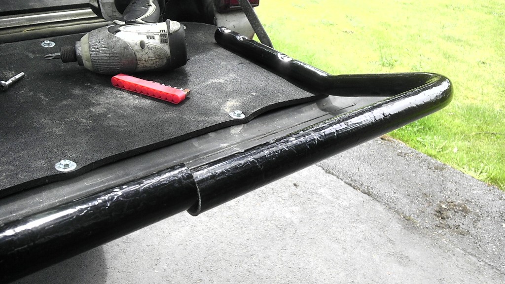

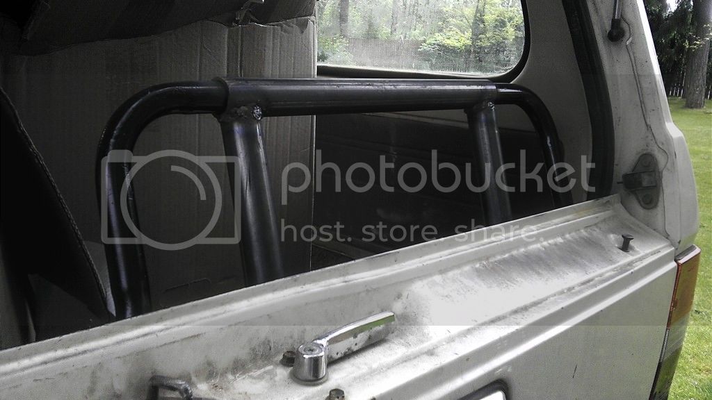

Snowman, that's a clever idea. is that tube attached with self tapping screws or?? I'd run some Gd 8 bolts with fender washers through to the inside of the tailgate for extra strength.. You might get some fat*** up there and rip em through ;)
Its with the stock stainless steel long threaded screws... so does that mean not all 60s have these? There are 3 on each side and 2 in the middle. I think it will be okay but.. I am really wondering now are these bars a option?
So I ran a search from what I could find only 1980s and 1981s had these. But I think all others are pre drilled and tapped for it so if they are still available you could get one. Man that is funny I thought all 60s had these! I will keep my other one around I guess :clap:
Its kind of funny to think I just CUT IN HALF a rare toyota part.
