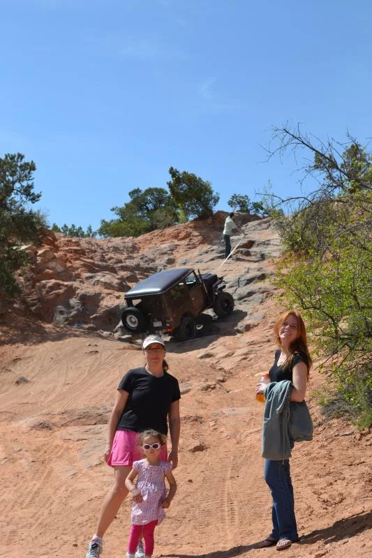

This thread needs more photos about SOA swap....but until Coe gets off his a$$ and gets around to posting up build progress photos....here's more of his rig from CM11!
Had to throw the one in with the ladies :)

Coe, in this picture, is this an obstacle on Behind the Rocks?
attachment.php
Hey Matt!
Yes it is, it's the one closest to the highway. It's also the one that made me decide that an Orion was still a must have one of these days! :eek: Jeff and I were both winched up it. I tried to climb it, but only got a 1/3 of the way up before I decided I was pushing my luck and better have a safety line. MUCH lower gearing and I think I might have even pulled it off without a locker. Maybe. You know that this is where Pappy rolled don't you?:frown:
You must be familiar with it?
BTW, that beautiful young lady to the right is my lovely :princess:. :clap: I am a lucky man. I will get to bring 2 ladies to CM next year: My wife, and my by-then-4 month-old daughter!

My buddy and I went up that obstacle in his CJ7 on 31s during EJS 2005. I've heard it's gotten much more difficult since then, and it certainly looks like it has. I didn't know that was where Pappy rolled though :frown:
Well, maybe I'm more of a chicken than he was...:D But in all honesty, I can't really imagine doing that now- unless MAYBE you were locked front and back and had super low gearing.
