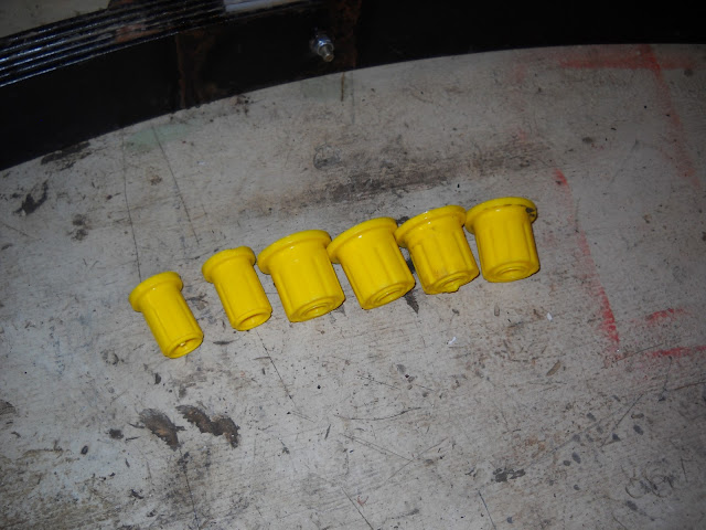

Old Man Emu bushings (Part#:OMESB30) that allow early-78 40's & 55's to run newer 40/60 series springs (The 60 series and 79 newer 40's spring eyes have a larger spring eye ID on than the older springs.)​
Difference in springs eyes: 40 springs above, 60 springs below​
