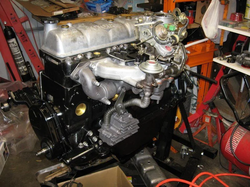

By installing the pulley first before tightening the bolts it helps center the crank seal. I have no proof that it works but hey doesn't seem to hurt.
Spike,
In your photo, the vac hose on the top of the carb should be connected to the center fitting of the 3 on the front of carb.
Looks good otherwise (not ghey).
