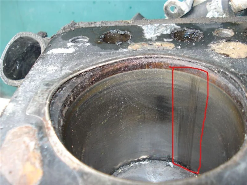

I would make sure that scoring is gonna clean-up first... looks kinda deep.......
When I saw that pic I though the same thing. It was just some carbon that had left that. Inspected all cylinders and all are free of score marks all smooth as glass and all still have the cross hatching.

Yea.. when you get the piston out it will be equality scored.. ( carbon, stuck ring) you can clearly see the path marks.....
That #1 looks bad I don't think you could hone it out. Does it catch your fingernail if you scrape over it? If so than most likely it wont hone out.

Just imagine making those marks with a pencil. Thats the extent of which it is on there.
Like I have said the cylinders are free from score marks.
