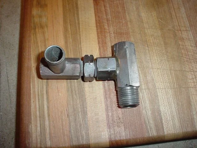

I think I have what you need. Not painted, of course;), but you are welcome to it.
I'll get a pic tonight...
Ed
If this is what you need, PM me your address and I'll get it out tomorrow.
Ed
Just wanted to say the heater nipple is for FJ60. If the engine is going into a 40 or 50 series, it would be more better to have the correct early heater nipple.
Jim you are absolutely correct on this. There is no heater hose cap in the world that will last more than a few weeks over the exhaust manifold. I must have replaced it 4 times before I got pissed and put on the Fj40/55 heater elbow without the extra nipple. the last time it went out on me on the freeway and coolant went all over the place, to the point it found its way into the cab. not fun having 190 degree coolant leak test the firewall on a 67 fj45(which proved to leak alot, although mostly on the passenger side.)
