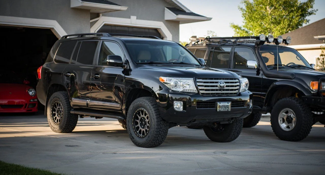

I see a bunch of smaller FJ's out there running meatier tires than we run. My wussy non-lifted LX runs meatier tires. Mark's rig is proof that bigger still is possible.
More BEEF is my vote.
I can get into all the practical reasons why it's useful for more flotation, especially when aired down.
All I got now is that it looks righteous.
