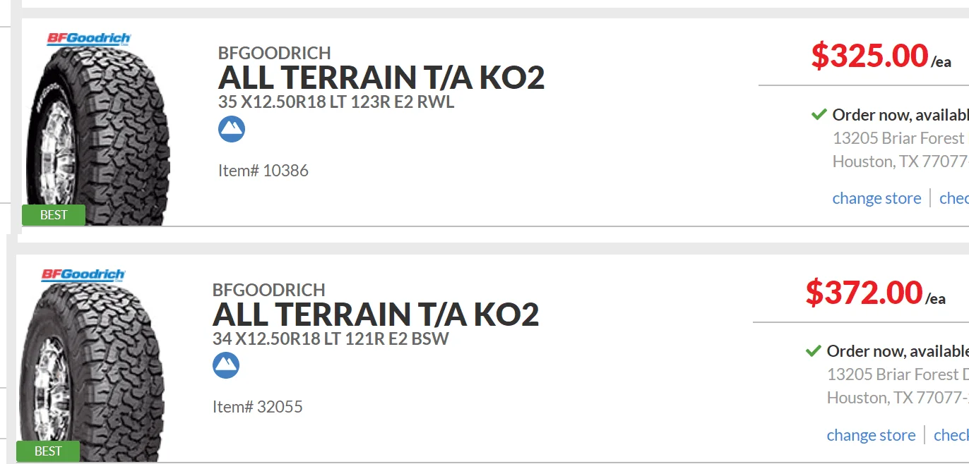

I didn't want to start a new thread, so I figured this would be a good place to ask:
Anyone know why the 34" is cheaper than the 35"? simple supply and demand?
You mean 35 is cheaper..
Yes, sorry. Why is the 35 cheaper than the 34"

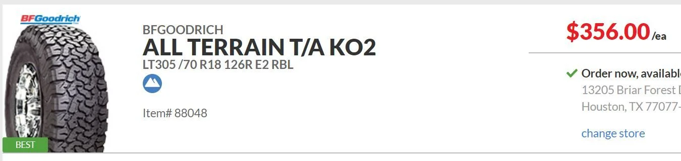

Discount tire is going to let me trade in my 275/70/18's because "I'm not happy with how small they are", and I've been looking at several sizes in the 34-35" range. I might end up with the 305/70/18 unless someone has a better idea...
How are you going to fit that width?
i'm running 1.25" spacers, and i'll cut a "little".
Take a look at @TeCKis300 comment:
I run a 305/55/20 tire. Which is 33.2" x 12.3". Your proposed tire is only .3" larger and .2" wider.
You'll want a .75" or 1" spacer on stock wheels to achieve an offset of ~30 to ~40. Some trimming of the wheel well should do it.
@radman its not the width of the 305/70R18 that’s going to kill you it’s the height. At 34.8” you will have issues with the KDSS bar. The 305/65R18 would be a much better fit. That’s the size that @TeCKis300 is referring to.
