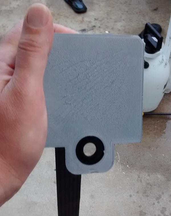

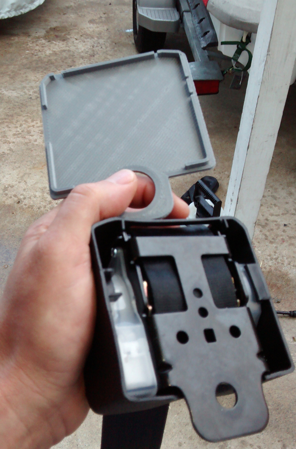

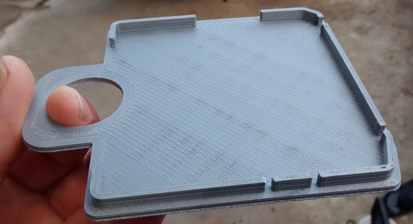

I am mounting the seatbelt retractors to the roll bar, but was a bit concerned with the backs of them being exposed to the elements.. like mud, dirt rocks.
After a few revisions I finally got a good fit with the 5th cover. The plan is to now print them out in black and use some clear silicone to glue them in place before I bolt them on. Pretty snug fit as it is without any glue.
Cool - you 3D printed them? Love it!
...via IH8MUD app

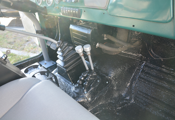

Yes I did, along with the Transmission shifter boot adapter, but to not derail this tread, I'll start another on 3d printed parts for our fj40s... so the best way I know to keep this on track is to add some MO-FOken Pictures!!!

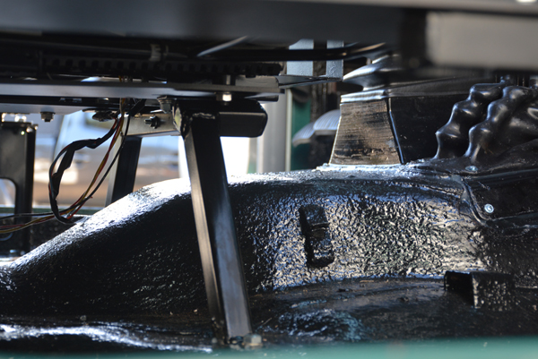

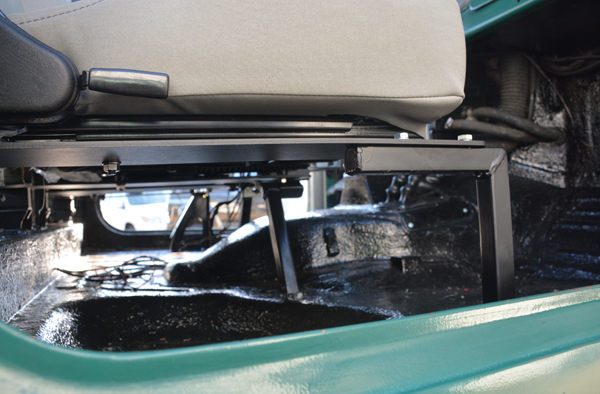

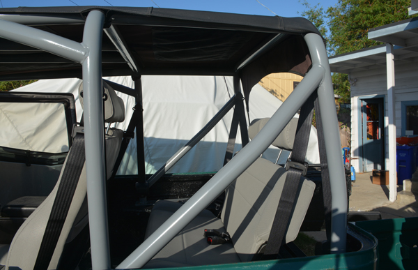

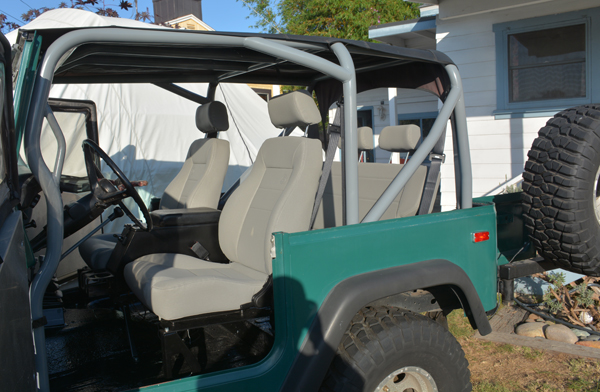

So I don't have the stock gas tank and I decided to make my own center and passenger side bracket, with extra short rear seat risers to make both the driver's side and passenger sides seat equal height.
This whole process took way longer then my original intentions because:
1. CCOT made me wait for them to make good on poor shipping practices.
2. I ended up taking out my roll cage to deal with some rust and weld in the new 3point seat mounts.
3. I freshened up the inside paint while I was at it.
4. Went with 3 point belts front and rear.
4. I have a one year old now.
5. Chopped down the rear seat Latch for a more snug fit. The original is for a Jeep and comes with a 1/4" slack I consider unsafe.
6. Redesigned the front adapters brackets and am cutting them out at my local Maker Place for my SD / Turf N Surf buds who want to do the same thing with out dealing with CCOT.

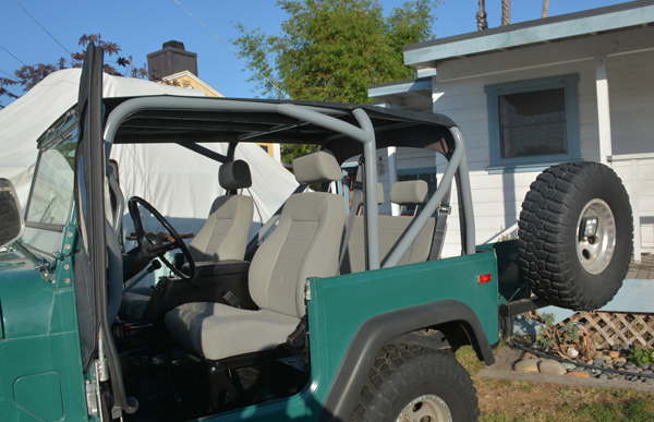

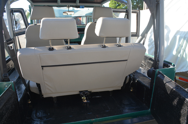

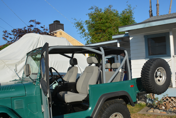

Hello,
Those seats look nice. Are the gray seats the same material as the black? It looks like there is a matte texture to those that is nice and the black ones look smooth and kind of shiny. I have a question - will an average sized adult, say 5'10, or a woman say 5'5 fit in the back seat? It looks in the pics like there is a bit more room than I thought there would be in that back bench seat. Not necessarily for a long trip, just wondering in general about the leg room? Right now I have the stock seats facing inward and those are roomy, but I can't imagine that I would want somebody to be sideways if I were to hit something, or get rear ended.

I'm no engineer, but the bracket pictured below looks like it would fail pretty quickly if you had a front end crash. Should you weld a small gusset in the front where it goes up from the floor to the seat adapter bracket? Just a thought.
From this:
To this:
|...../ <---- 1/8" steel plate roughly 4" x 4" cut on a 45* angle.
Looks as strong as the pressed steel factory brackets. The rear mount of the seat and the solid bolting of the seat slider to that bracket creates a box with the floor. Forward momentum will put the most force on the rear mounts, that is why they are bigger stronger bolts than the original front mounts and bolts. The factory seats also had the seat belts attached to them, so they did double duty, new vehicles of course mount the belts to the floor in most cases and the seat mounts are lessor as they are only holding the seat down and not the occupant too.

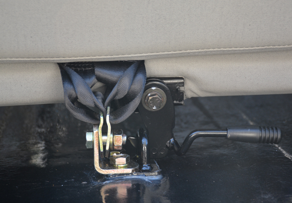

Ok got some front brackets welded up for the front mounts. They do sit higher in the tub than if I used the brackets that came with the seat, but this doesn't require drilling holes in the tub. This isn't a solid mount, but rather a drilled bushing that still allows the seat to tumble forward as designed.
My next goal is to come up with a safe/secure solution to securing the rear of the seat and the center seat belt receiver's.
Well I completed the install of the front Trailmax Pro's today, and I'm pleased to announce that NO aftermarket brackets or sliders are required to install these in the 79-83. They bolt right in with the factory sliders! There are several threaded options on the bottom of the Trailmax Pros but none of them line up however, there are also non-threaded holes that line up just perfectly.
Thanks to a previous order from @ToyotaMatt I had some extra nice hardware that fit perfectly. I just used bolts a flange nuts. The only part that may require a longer bolt is the slider that has the adjustment lever. The lever is riveted to the rail and creates a high spot between the bottom of the seat and the rail.

My question is: what bracket options for the back rear bench seat are best? I’m not as worried about drilling my tub as others.
I want to find a good bracket that provides good seat height and stability obviously. But I want the trail max II rear bench and since I have a long range gas tank that’s been installed underneath the back tub (rearmost), I might need to do different holes anyways.
