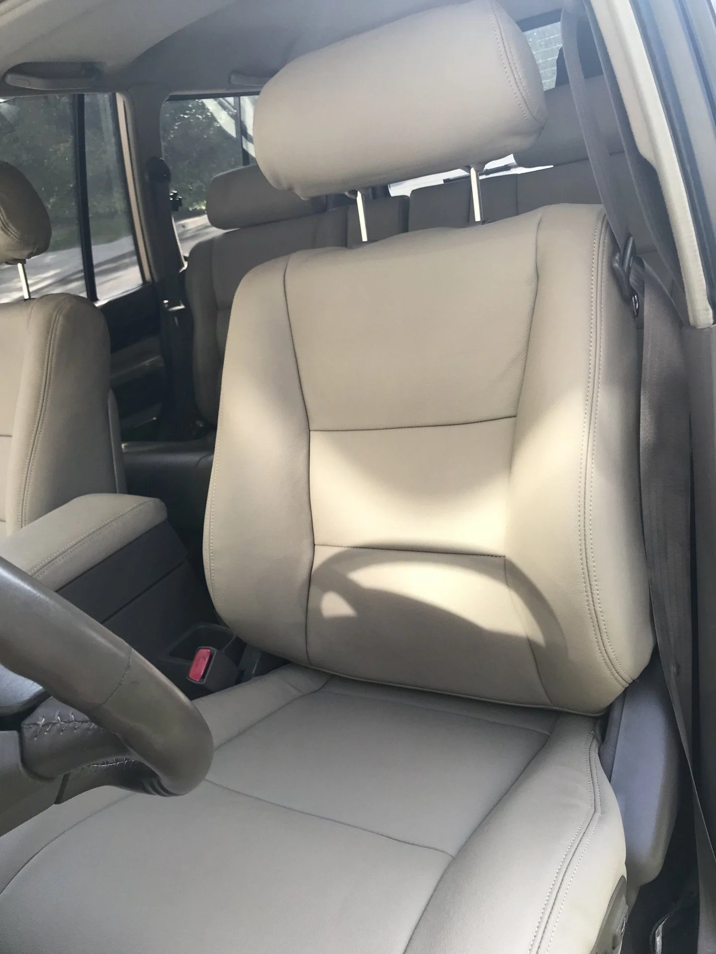

I installed the lseat covers last weekend. $300 on Amazon and only for LXs. Fronts only. I’m satisfied.
No, but I patched one area on the outside bottom of each seat with new foam and contact cement. It is a lot of ditsy work and it took about 3 hours each even though I have done about a dozen other seats in my life.

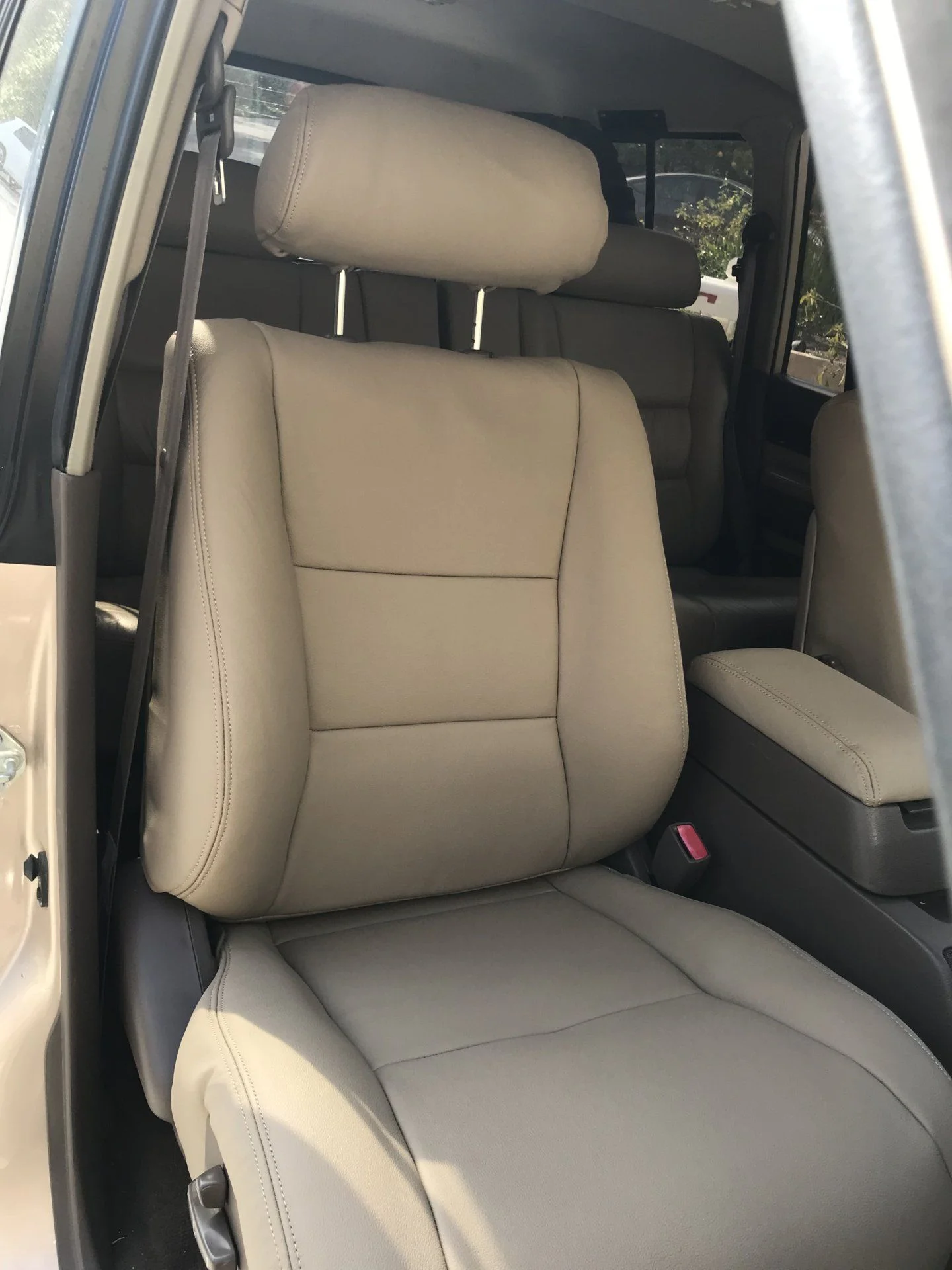

I did Lseat. beige, added seat heaters. I am happy with them. steamed my foam and the parts that were damaged and falling off I cut and patched. Took the opportunity to add a little padding here and there to make the seat a little more comfortable. Search the forums for lseat and you will see a couple of us LX450 people have gone that way. I think most choose either beige or ivory.
Mine were, Might be a little thicker than OEM though.
