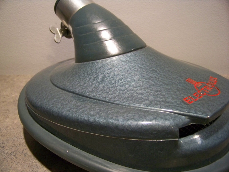

It's a great, tough, durable, "industrial" coating. I've used it on a number of things in my shop. Best options I've found are to spray it or use a short nap solvent resistant roller. Brushing hasn't produced good results for me. You want your passes in one direction only to get a good pattern on it, otherwise you get stripes and patterns.
Only spray cans I find are 'Rust Cap,' or are you putting it in a sprayer? Not to be picky--but to be picky--that looks like it has a zillion little pockets to trap oil etc., and would never wipe clean(?)
I'm putting it in a sprayer. The finish is actually smooth - just slightly dimpled. Sort of like it's been peened - hence "hammer." Most of the texture is actually in the color variation. There is no roughness to it. You can easily wipe it clean. Think early to mid-century (last century) tools and equipment.
