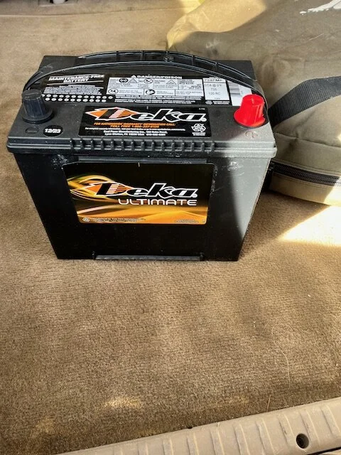

I like my Deka and it gets pretty cold here in the Winter (Durango, CO)
It was sub $200 - Like maybe $150-$160.
