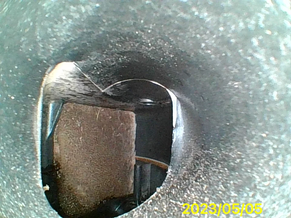

I use my directional bore scope with 6mm camera, to inspect these filters:
As long as filter still in view, you can wait.
If to dirty or brown (old dirt foam) kept very close eye on.

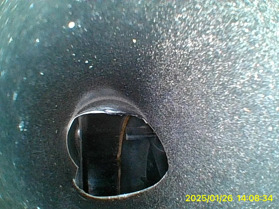

If gone, either replace S.A.I. pump or do my replace filter mod. You can do a block off used OFF-Road only (Trailed to off road). But avoid those that wire in, especially if to MAF.
Filter of S.A.I pump (blower), gone from view. In this 25K mile 07LC, out of Gulf coast LA area:

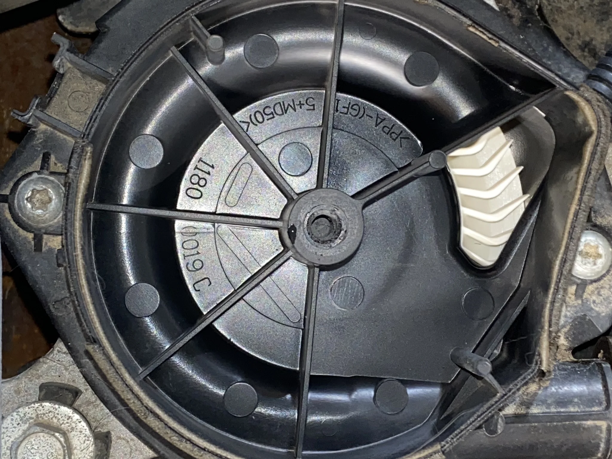

Cap removed.
