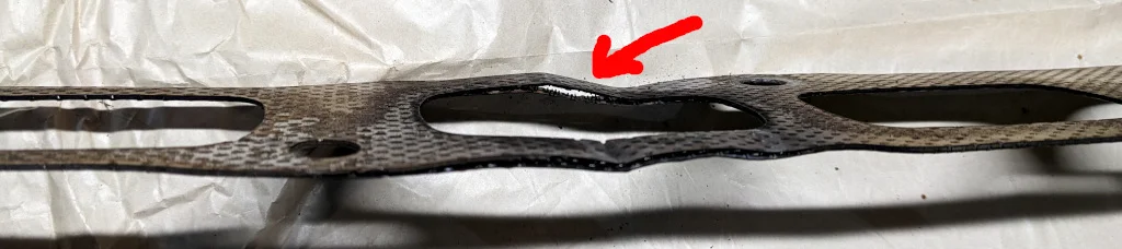

I used a gasket that was included with my engine gasket set in my rebuild - it failed and started leaking around exhaust, actually split apart (see pic). On closer inspection what I realized is that not only do you need a good gasket, and a flat manifold (which I had), but the two pieces of the central manifold should be held flat while you bolt them together. I couldn't seem to find a procedure for this in the FSM, but next time I'll leave the manifold-to-manifold bolts untorqued until I get the whole thing bolted to the head. My manifold has the intake manifold face sitting about 0.5mm proud of the exhaust face, which exceeds 0.4mm limit and is tough for any gasket to manage. Individually the manifold pieces are flat.
I ended up doing a hack fix to avoid pulling the whole thing apart again (since nothing else was leaking). I installed two felpro gaskets, and I ran a bead of high-temp copper RTV around the central exhaust holes between the gaskets. It made a kind of frankenstein (and expensive) gasket with bulged out parts where my manifold has a larger gap. But - it's working fine.
