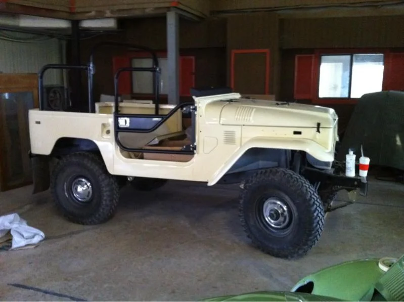

Pics
I am looking for a 4" kit myself and would LOVE to see a few photo's, final installation, of the mfg's kits that you are discussing. :bang:
Here are pics of my 40 that's still under the knife.
4 inch hell creek springs
Sor stock length anti inversion shackles
Bilstein shocks
33 x 10.5s
