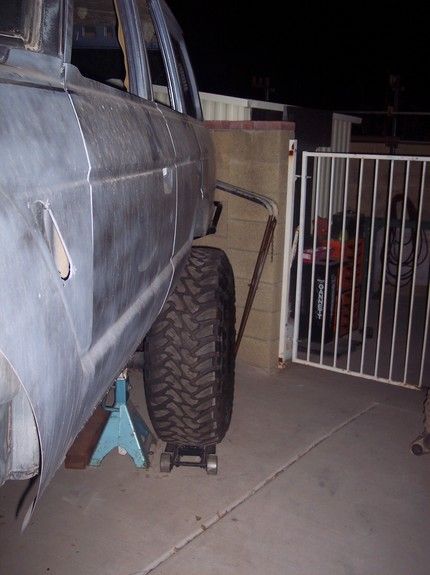

Hey Isotel I'm gonna start a thread pretty soon on this same topic. I'm going to widen my 60 axles 6" in the front and match it in the rear. This is the look and width I want. I have the same backspacing on my 17's and don't want to run spacers anymore, so this is the only solution I see to keep the toy axles!

60 axles with 3.5" BS wheels would make a pretty stable 100" WB rig.
I have 55" axles, 1.5" spacers, and 3" BS wheels. My rig is pretty stable SO'ed with 38" tall tires. If you wanted more, you could always add IFS hubs and gain a few more inches.
Plus if you go this route your scrub radius will be nicer on your steering than the route I went.
