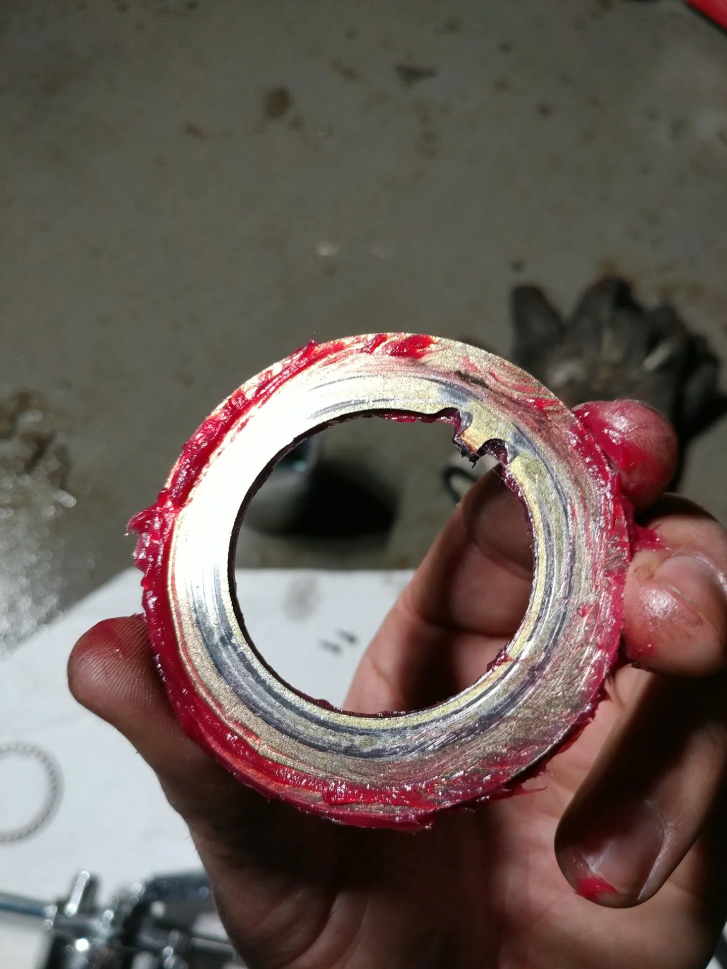

Bearing thrust washer wear, normal?
Was just into that a couple of days ago, and mine look like that as well, only with deeper grooves. (but I remember they already were grooved last time, so it might be old news)
So - same question. Is the groove a problem?
Was wondering if replacement is a good idea?
No signs of any other issues on mine.
Spindle surface step (from inner bearing race spin wear) - barely able to feel.
Bearings - smooth.
In fact, the whole adjustment nut preload thing was a question because the bearing are so smooth.
With the adjustment nut way over-tightened (for grease squeeze out), could spin the tire with just one finger.
So, basically, nothing to judge how tight to go.
So I "tightened by feel" (guessed), and took it out on the freeway for 15 miles or so on a cool evening - hubs mildly warm - OK I guess.
Have the feeling a little tighter wouldn't hurt?

Replace them I have had a worn one like that and I had to buy a new spindle, I now always replace them
Or just flip it over to the other side if it's got no wear on it.
I've used them in similar condition when time was against me to get it buttoned up again.
Use a mill bastard file, or some emery paper on a hard flat surface to debur them.
Order a replacement so you can change it out next time you're in there
But if you flip over the grooved washer, then the adjustment nut is bridging across the groove.
That could give unpredictable and variable preload results, that could relax with time (exactly what you don't want to happen).
Also, the grooves on mine have a tiny raised rim, which would be getting crushed, some, as you tighten.
Too iffy, IMO. Would rather keep the perfectly formed groove in contact with it's bearing race, or replace with nice new flat.

If it's lightly scored and burred, you can make do. If it's deeply grooved with large burrs and galling of the metal, toss them away
This all comes down to judgement, and common sense, if you feel the washer is to damaged to reuse, then don't reuse it, It's as simple as that. YMMV
Because its 10 o'clock on the Friday night before you leave on The Trip that's been planned for like 6 months and a replacement washer didn't come in the rebuild kit.... and "F'it! I'm putting this pig back together and going on my trip!" All hypothetical of course.
That's why they would get reused.
On that note, I'll order a set before I tear into my spindles after the new year.

Every single 80 axle I've taken apart has some sort of groove on the thrust washer. Through the years and reading on here, I've tightened the axle nut at 35-45 ft-lbs (not inch-lbs) and generally been much better off.

Yep I've already replaced them with the panhead screws, I have an extra washer i'll throw on and tighten it up some more.

If slight wear, we flatten them on the belt sander, more wear replace, they are cheap.
So, if properly pre-loaded, should never see a bearing race groove or rotary polishing?
I wouldn't say none, there is always witness marking, but greatly reduced. Depending on rig setup and use, we preload with 30-35fl/lb on the inner nut, then the rest to FSM.

But, now that I'm all torqued up about it ;) I'll probably get new ones, go back in soon, replace and re-pre-load according to the excellent hints by @Tools R Us and @bajaphile.
